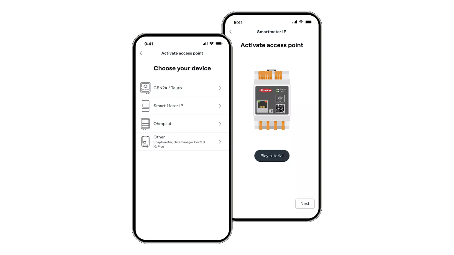

Solar.start App
It is possible that you are still connected to the inverter itself (wireless network name: Fronius_XXX, where XXX stands for the serial number of the inverter or Dalo ID of the data manager) and therefore you cannot access the internet. Please check this in your WiFi settings.
The inverter has probably already successfully connected to the wireless network. However, it may be that your smartphone is not showing this, as it may have lost the connection to the inverter. It is possible that your smartphone has connected to another known wireless network in the meantime. In the WiFi settings of your smartphone, you can check whether you are still connected to the inverter (wireless network name: Fronius_XXX, where XXX stands for the serial number of the inverter or Dalo ID of the data manager). If not, please select the wireless network name of the inverter to connect and then go back to the app. The page should then reload. Otherwise, you can go back to the app menu using the back button in the top left corner and restart the process. You should then be able to continue where you left off. The inverter should already be connected to the wireless network.
If you use an iPhone or iPad, you will need to manually connect to the inverter by scanning the data matrix code using the app (Primo/Symo GEN24 Plus and Tauro) or following the instructions in the app.If you have an Android smartphone, please ensure that your device is allowed to connect to a wireless network that does not have an internet connection. You may receive a system notification that you have to confirm.Otherwise, please check in your WiFi settings for a setting like this and change it if necessary. You may also find this setting in the developer settings of your smartphone. Please consult the instruction manual for your smartphone for more information.
Please ensure that your device is allowed to connect to a wireless network that does not have an internet connection. You may receive a system notification that you have to confirm. Otherwise, please check in your WiFi settings for a setting like this and change it if necessary. With Android devices, you may also find this setting in the developer settings of your smartphone. Please consult the instruction manual for your smartphone for more information.
