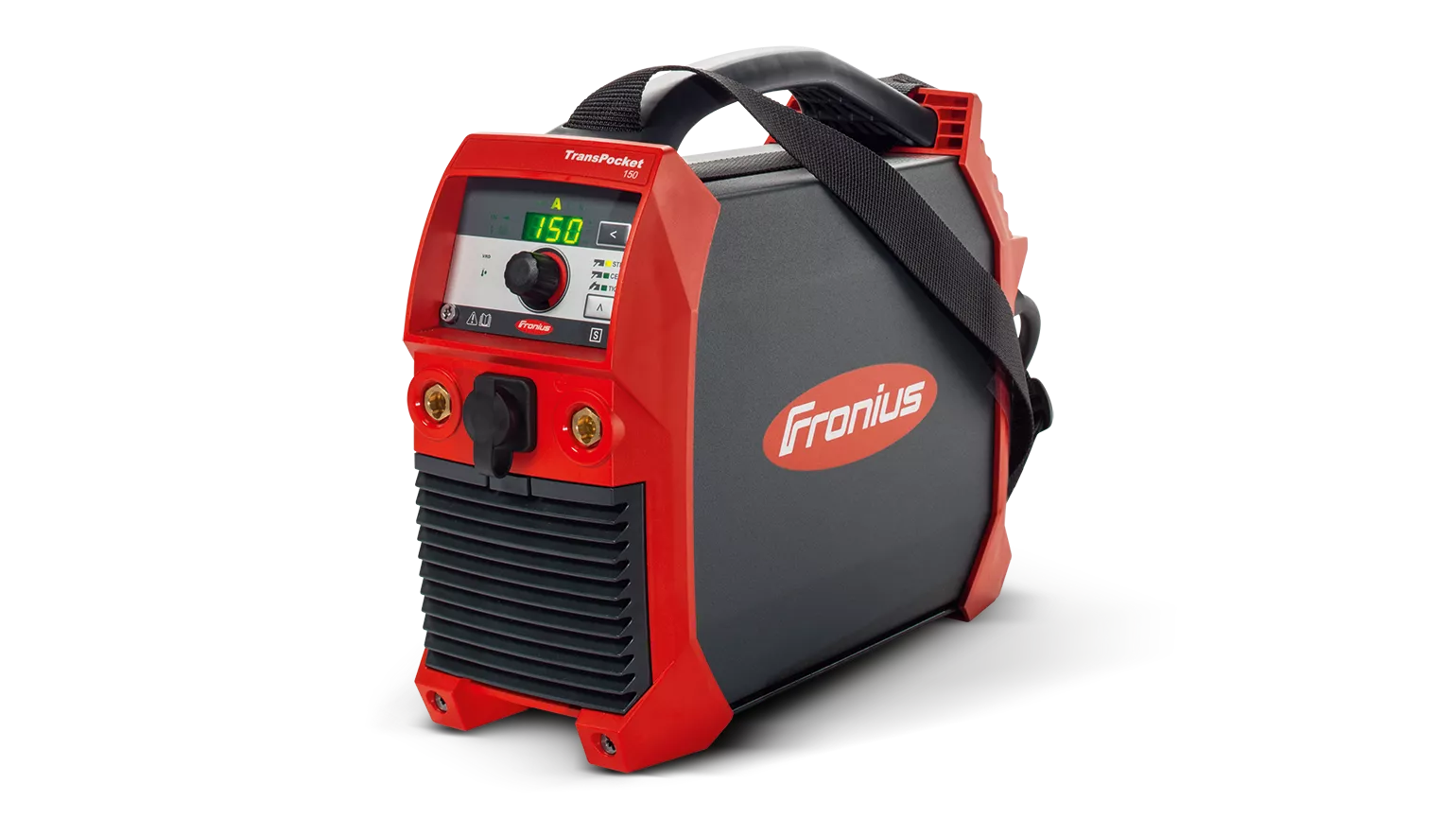

Welding with the Ignis The mobile MMA welding system
Ignis—The flexible Fronius MMA welding system
The best result with every power grid
The compact Ignis product family offers the perfect weld every time, even under the most adverse conditions, in the smallest of spaces, indoors or outdoors.
The Ignis 150/180 makes a stable arc a reality, even with long grid leads or voltage fluctuations.
This robust MMA welding machine always provides perfect results, even with unstable grids, generator-powered operation, or over a wide operating radius. It makes the Ignis the perfect companion—especially on construction sites, for repair and maintenance work in industry and agriculture, and in any home workshop.
Ignis highlights
Mobile and robust
At only 6.5 kg (Ignis 150) and 8.8 kg (Ignis 180), both models are truly lightweight and suitable for mobile use. The robust construction of the devices as well as the integrated stainless steel filter provide reliable protection even in demanding outdoor welding tasks or volatile weather conditions.
Full power even with long grid leads
Perfect welding results even with grid leads up to 100 meters long are a matter of course with the Ignis 150/180. This is made possible by the integrated PFC technology (Power Factor Correction), among other features. As a result, the devices are particularly energy-efficient and disruptive interference with the grid is minimized.

INTUITIVE OPERATING CONCEPT The clear operating concept and 7-segment display on the user interface make it possible to quickly read the parameters and simplify handling.
Press-and-turn button to change the selected set value.
1
Status indicators to indicate the different operating states of the welding machine.
2
Set value display to display the selected set value.
3
Set value function button to set the arc-force dynamic and welding current values, SoftStart/HotStart function, and pulse welding.
4
Welding process display to display the selected welding process.
5
Welding process function button to select MMA welding, MMA welding with cellulose electrode, or TIG welding.
6
1
2
Status indicators
3
Set value display
4
5
6
