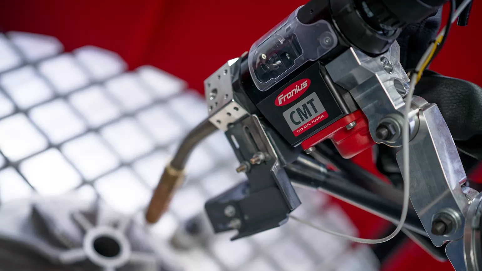

The additive manufacturing process for metal 3D printing, also known as wire arc additive manufacturing (WAAM), enables quick, cost effective, and precise component production. Based on this approach, Fronius Additive is revolutionizing the manufacturing industry.
The wire-based, arc-driven CMT process offers huge design flexibility and the ability to produce complex component geometries, while still delivering high deposition rates. All these benefits make Fronius Additive the ideal choice for prototyping and small batches.

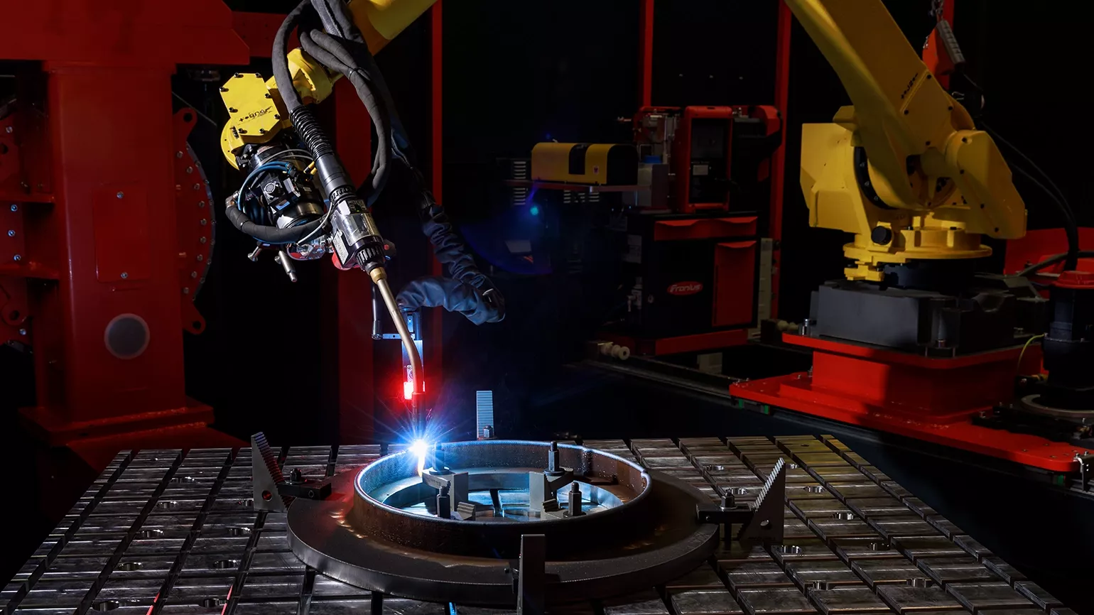

Fronius Additive Cell: system cell
For end users and manufacturing companies: With the Fronius Additive Cell, we offer you a turnkey solution that’s ready for immediate use. From the robot mechanics and the thermally optimized clamping system to the software, you receive a validated, complete system from a single source—without the need for time-consuming integration into your manufacturing process.

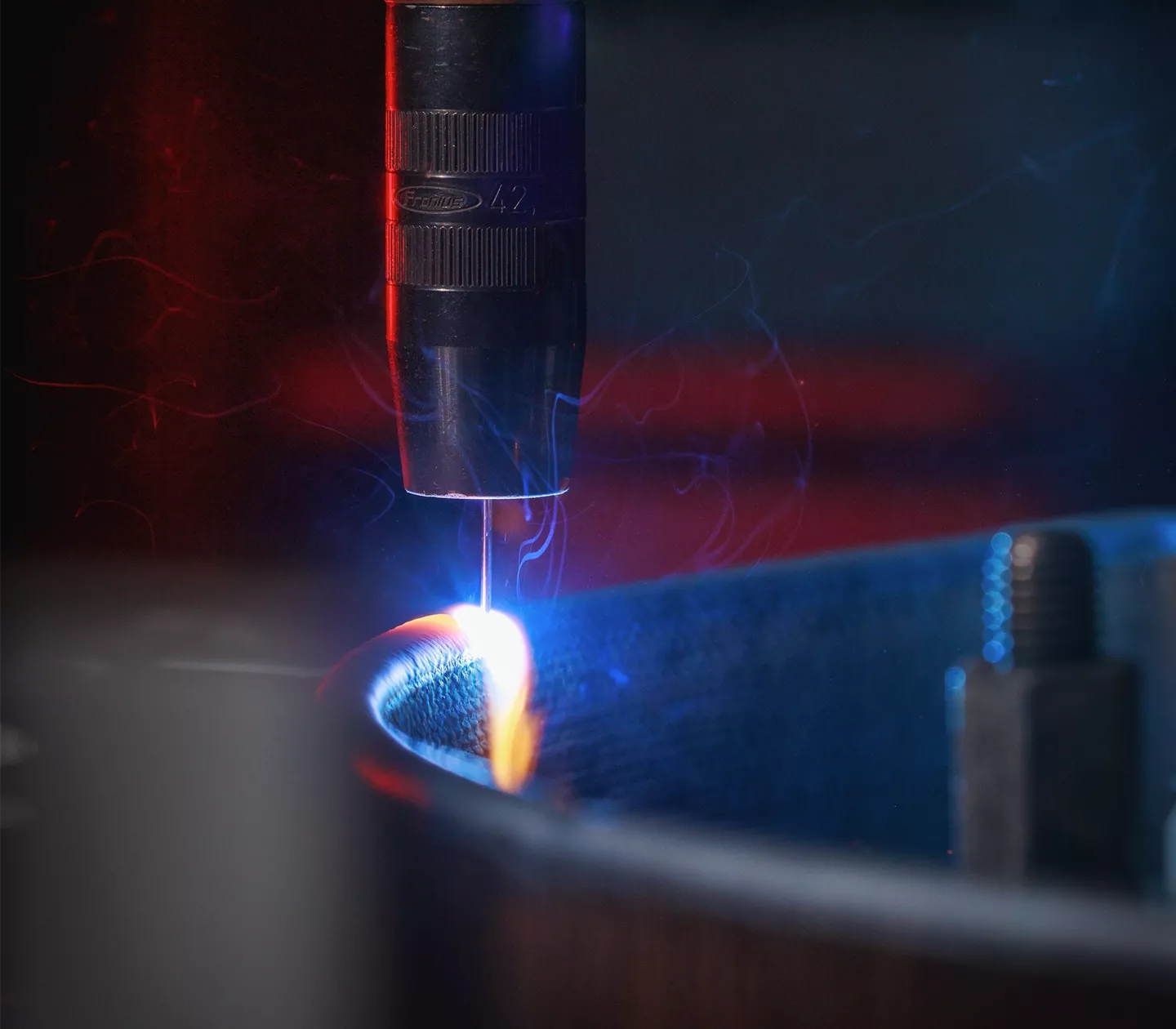

CMT—a stable arc with no exceptions
The synergy between stability and flexibility is essential to producing components in additive manufacturing. A reliable welding process and efficient heat management play a critical role.
Thanks to its revolutionary reversing wire movement, the CMT process is extremely stable, making it perfect for additive manufacturing. Layers are built up consistently, evenly, and virtually spatter-free,
ensuring that the welded layers and components produced meet the highest quality standards.

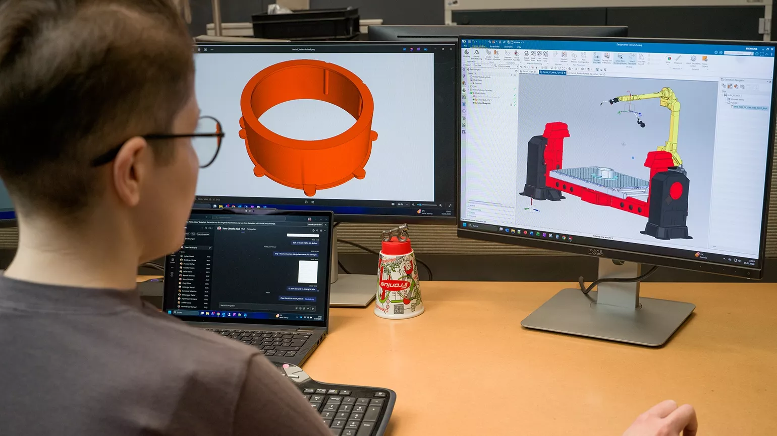

Step 1:
Digitalization and reconstruction
Optical analysis of the original part using 3D scanning and CAD processing.
Planning on desktop
Step 2:
Process development and programming
Selecting materials, setting parameters, and generating robot-assisted production paths.

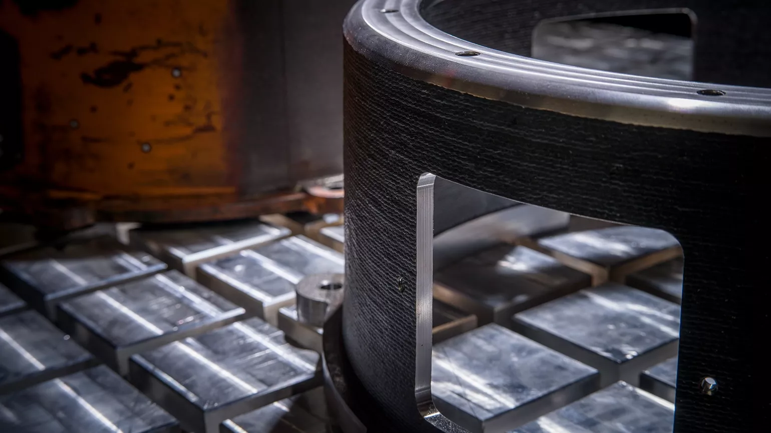

Contour-tracing material build-up using high-productivity CMT arc technology.

In-house component inspection to NDT Level 3, plus final mechanical finishing (milling) of working surfaces.

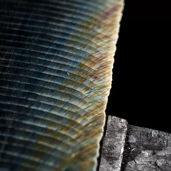

An additive-manufactured component is only as good as its final microstructure. At our in-house laboratory, we put your components through a rigorous testing and certification process. From non-destructive cracking tests to scientific microstructural analysis, we guarantee comprehensive quality assurance and maximum reliability—without waiting on external service providers.
