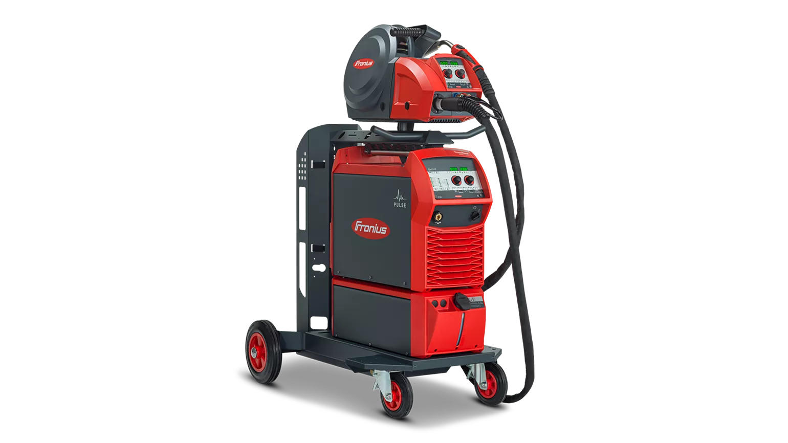

... with nearly 170 optimized characteristics, the TransSteel series features the characteristics demanded by the heavyduty steel construction sector.Yet the power source remains versatile: The TransSteel versions with the Pulse function make child's play of applications involving aluminum and stainless steel. SMEs can benefit from this variety of materials, as just one device is all they need to cover a wide range of applications. The underlying philosophy – stay on top of things. The function spectrum of the TransSteel has therefore been deliberately reduced to the essentials in all areas according to the motto - as much as necessary, with the best possible overview and ease of handling.

High-power welding and a broad range of applications
40% duty cycle
Four minutes of continuous welding at maximum output power, in other words, one minute more of productive output compared with the average in this power range.
167 characteristics*
/ Steel, CrNi, AlMg, AlSi, Metal Cored, Rutil FCW, Basic FCW, Self-shielded
/ 0.8 – 1.6mm wire diameter
/ Eight different gas mixtures
Ready to weld in three steps
The intuitive operating concept enables welders to start work straight away – no prior knowledge of the device is required. All the essential welding parameters can be viewed and adjusted on the front panel. The only parameters that have to be selected before welding begins are the gas, wire diameter and material thickness.
70% less rework, 30% faster welding
The Pulse function of the TransSteel 4000 und TransSteel 5000 Pulse permits faster welding speeds on thicker materials. The pulsed arc also reduces the amount of rework, as less welding spatter is generated.
* Maximum number of characteristics (TransSteel 5000 Pulse), will vary depending on the version.
