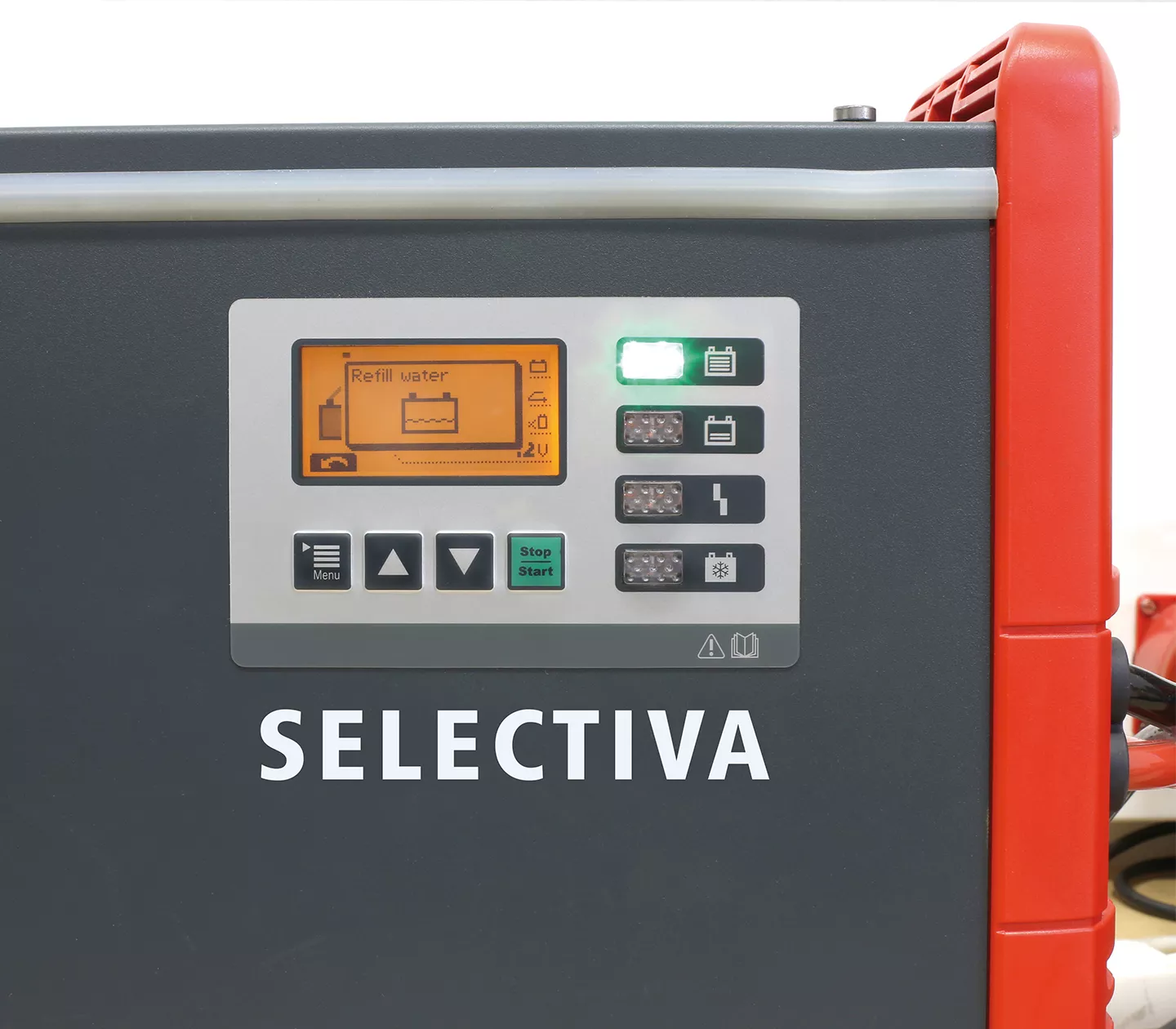

Distilled water plays a crucial role in the operation and service life of traction batteries. For this reason, regular top ups are necessary as the batteries will otherwise dry out, often causing permanent damage and leading to a loss of capacity or the battery being destroyed. However, due to hectic workdays, many users forget to top up the water in time.
Fronius battery charging systems provide maintenance instructions on the display, one of which reminds the user to top up the water in good time. The content of the messages and their time intervals can be configured as required. All this helps the forklift truck operator to keep the batteries in the best condition possible, thereby ensuring an extended service life and increased capacity.
Fronius can equip its Selectiva battery charging systems with the Aquamatic control option as required, which allows the user to control automatic water filling systems. These systems automatically fill the individual battery cells with distilled water after every charging process. By preventing damage and a loss of capacity, this allows the user to benefit from an extended battery life and increased availability.

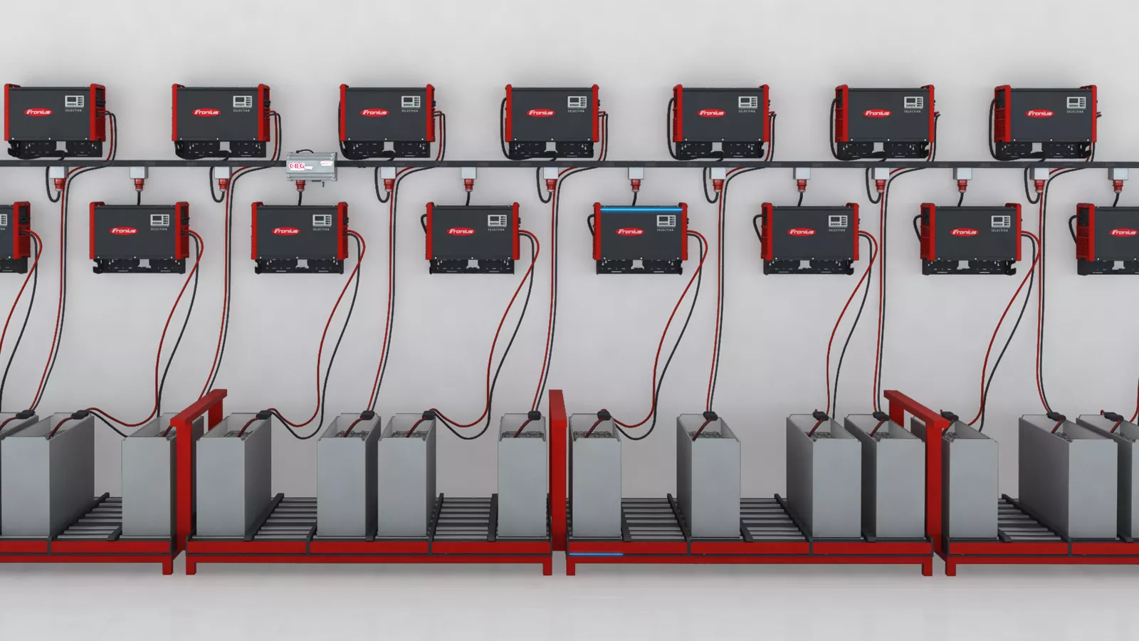

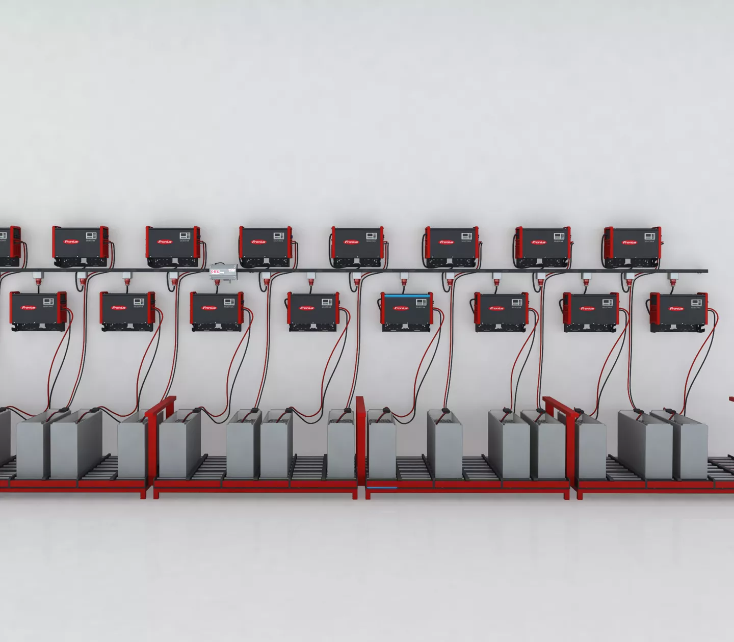

Even utilisation of the battery pool extends the useful life of each individual battery. Yet in many cases the reality is often somewhat different: employees frequently select the wrong battery, either for convenience or because the state of charge is not visible or is difficult find out. This means that some batteries are almost always in use, leading to an increase in battery temperature and a reduction in the service life of the battery. In contrast, other batteries remain unused for days or weeks, which can lead to acid stratification - and subsequent plate damage. The consequences are a reduced service life and considerable costs for purchasing new batteries.

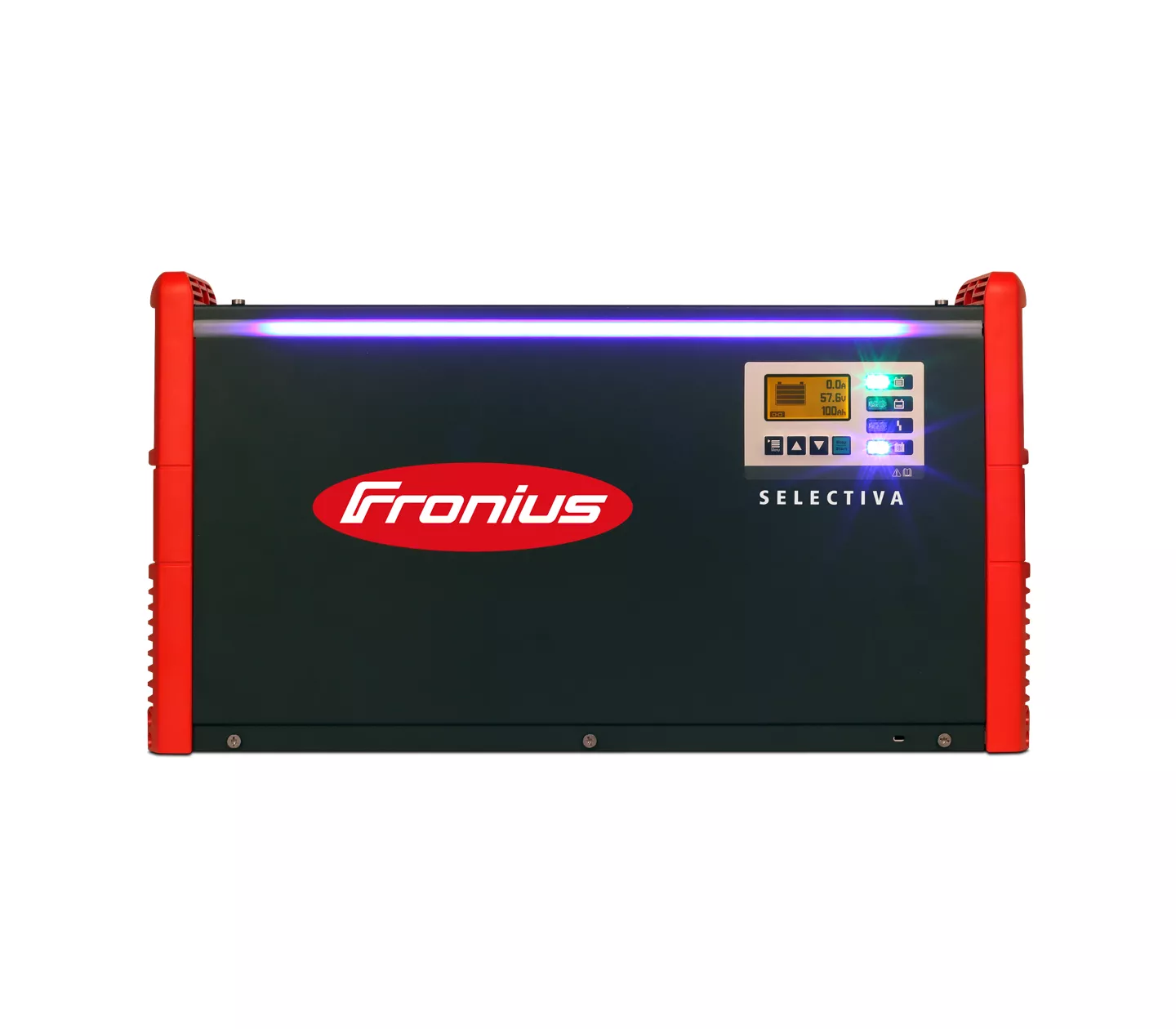

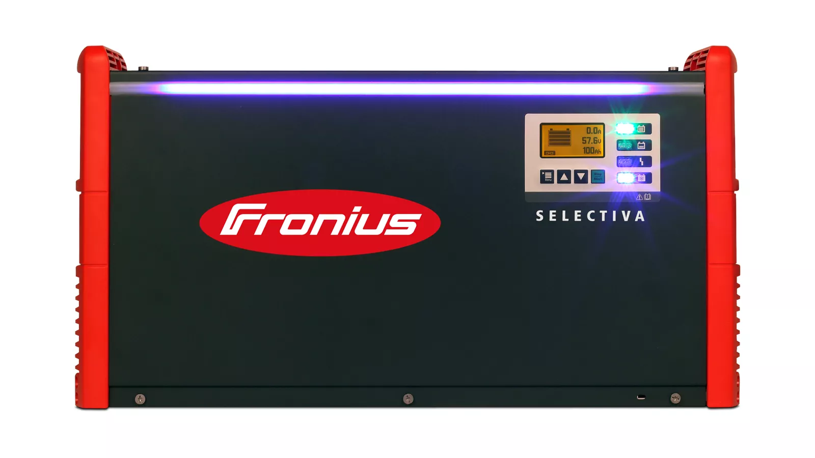

Fronius Selectiva battery charging systems have different coloured LEDs that show the status of the charging process at a glance. A minutes counter on the display indicates how long the battery has been fully charged for.
The “Cool Battery Guide Easy” and “Cool Battery Guide Premium” information and management systems further improve the utilisation of the battery pool: a control unit shows the user which battery has been fully charged for the longest and is therefore the coolest, intuitively guiding the user to the correct battery. Incorrect decisions made by employees become a thing of the past. The service life of the batteries is thereby increased and operating costs are reduced.
Manufacturers and distribution centres often employ a multi-shift working environment. Forklift truck batteries are therefore in constant use and rarely have the chance to cool down before and after charging. Every day the internal temperature of the battery continues to increase, and battery temperatures well above 50 degrees Celsius are not uncommon. This effect is intensified when the forklift trucks have to move heavy weights, for example in the beverage or paper industry. Over time this causes damage to the batteries and reduces their service life considerably.
Fronius battery charging systems have a calendar function that allows the start of the charging process to be delayed, giving the battery enough time to cool down before charging starts. Moreover, the Ri charging process of the Selectiva battery charging systems ensures ultra-gentle and significantly cooler charging of the battery compared to other technologies. A blue LED and a minutes counter on the device display show if and for how long the battery has been cool enough to be returned to use.
Clearly visible LED strips are also available as an option, as well as the “Cool Battery Guide Easy” and “Cool Battery Guide Premium” information and management systems. These show the user which battery has been fully charged for the longest and is therefore the coolest, intuitively guiding the user to the correct battery. The service life of the batteries is thereby increased and operating costs are reduced.

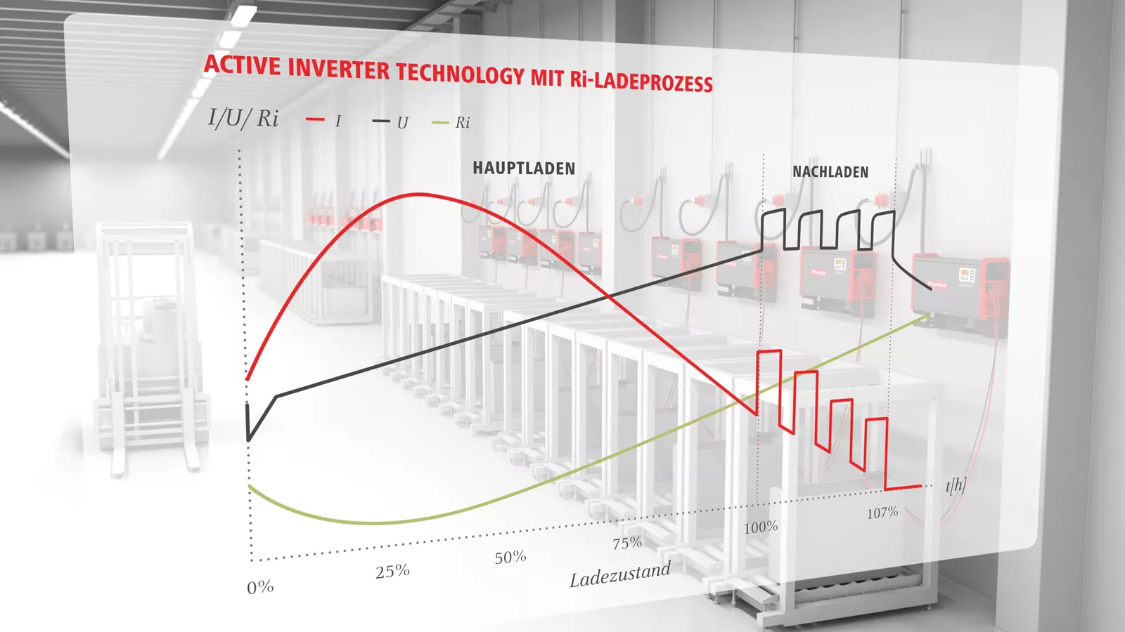

Fronius can equip battery charging systems with the “temperature-controlled charging” feature on request. This means that a temperature sensor is installed between the cells in the cell case. When charging begins, the innovative Ri charging process permanently records the temperature of the battery and adapts the charging characteristic accordingly. The user also has the opportunity to set limit values for the maximum temperature of the battery. If the temperature is close to violating one of these limit value, the battery charging system outputs a warning. If the critical temperature is exceeded, the device stops the charging process so that the battery does not become damaged. This increases the service life of the battery and makes the entire forklift truck system substantially more cost effective.
With the aid of the I-SPoT Viewer software tool, a user can analyse every charging process and optimise the process where necessary, for example by extending the charging time. A cooler and gentler charge is thus established, which in turn extends the service life of the battery.

The innovative Ri charging process of the Fronius battery charging systems reduces overcharging of the battery to a minimum. This also reduces gas formation, which in turn reduces contamination and unpleasant odours. The result: an improved working environment around the charging stations.

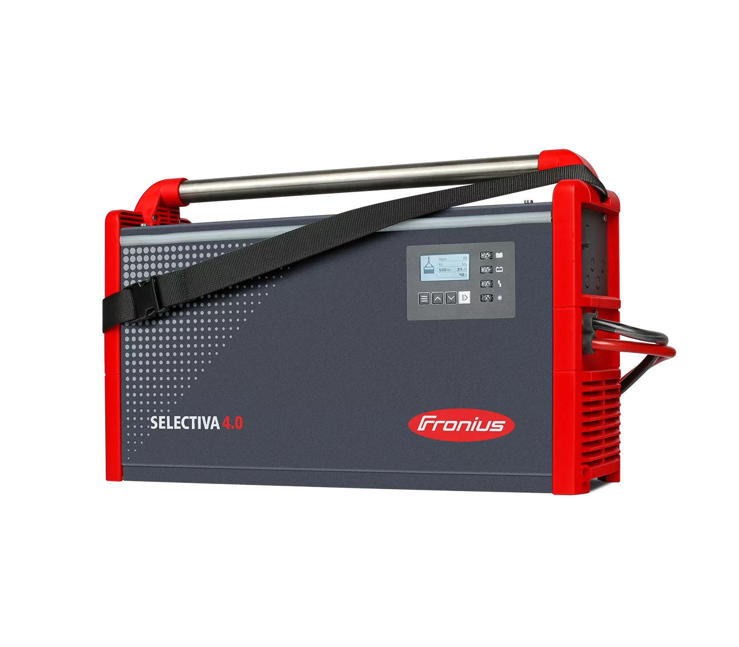

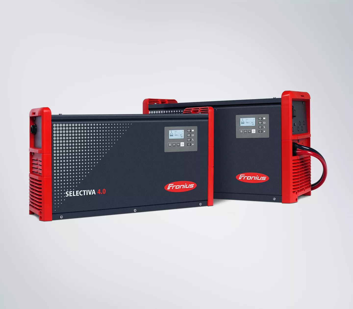

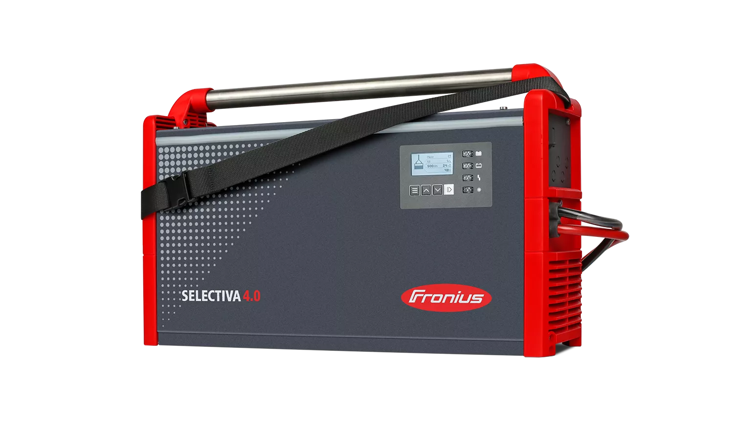

All-round battery charging system for the workshop or as a replacement device
The perfect service unit
Be it as an all-rounder for the maintenance and servicing of forklift truck systems or as a replacement device, having a flexible battery charging system for all types of traction battery (irrespective of size, voltage, capacity or charging plug) is a huge advantage in countless applications. However, many suppliers are struggling to achieve this: battery charging systems are often designed for specific types of battery only and cannot be used as a universal tool.
Fronius is offering a truly all-purpose solution with the Selectiva 8090 battery charging system: it enables flexible charging of batteries with a voltage of 12 to 80 volts and is suitable for battery capacities of 225 to 1,500 ampere hours. Users will enjoy a universal battery charging system for all types of electrically-powered forklift trucks. Its compact dimensions and low weight mean it is easy to transport, while the comprehensive range of accessories allows it to be adapted to the individual needs of the user.
