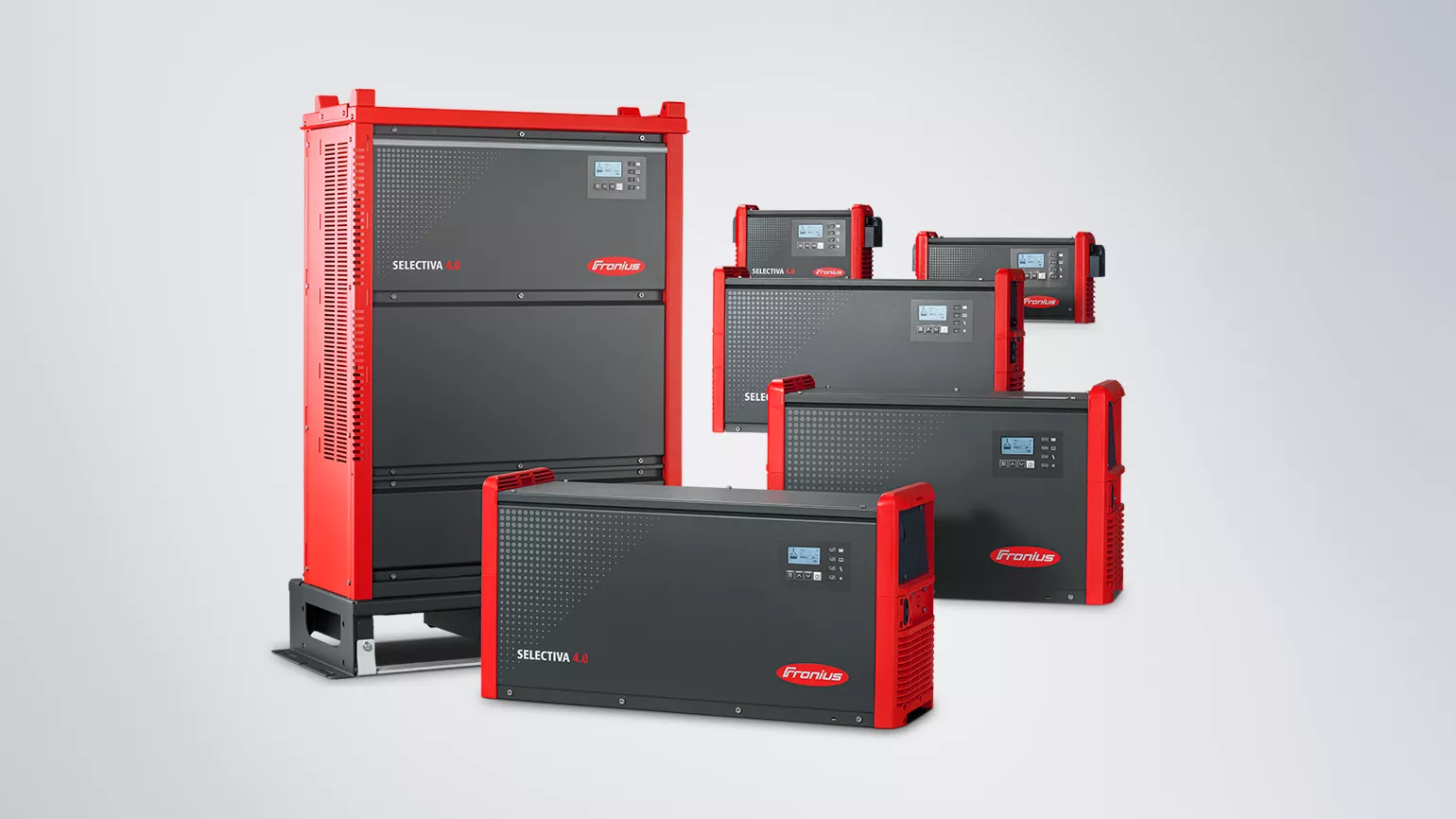

Considerable savings can be achieved here if users take a holistic approach to optimising the three-part system (forklift truck, battery and battery charging system), as the right battery charging technology plays an important role in making forklift truck systems more economical to operate.
Selectiva charging systems from Fronius with the new Ri charging process offer a clear advantage. This charging process does not follow a fixed characteristic; instead it adapts according to the age, temperature and state of charge of the individual battery, reducing overcharging and thus energy losses during charging.
With a total efficiency of up to 84 percent, the Fronius devices reduce energy consumption considerably, helping the operator to achieve significant cost savings. Expensive investments in high performance transformer stations can be avoided too.
