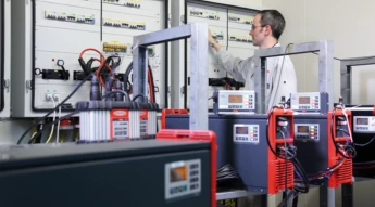

Dust, dirt and moisture, a poor quality or inconsistent grid, long periods of use and little to no breaks: there are many factors that can make the life of a battery charging system difficult. And this is where the wheat is truly separated from the chaff, as only high-quality systems designed for use under extreme conditions operate reliably in such an environment, and are therefore cost-effective in the long-term. Unsuitable battery charging technology results in high maintenance and unnecessary costs for frequent new purchases.
Fronius battery charging systems are known among experts for their reliable operation and long service life, even under the most extreme conditions. The reasons for this are high-quality manufacturing, customised accessories and well thought-out device properties. For example, the new generation of Selectiva battery charging systems feature a completely new ventilation system. The air flow for cooling the electronics is guided through the battery charging system via an air duct. In addition, each PC board in a Fronius device has a protective coating, which protects the electronics from dust, dirt and oxidation. An optional dust filter provides additional protection in particularly polluted environments.
