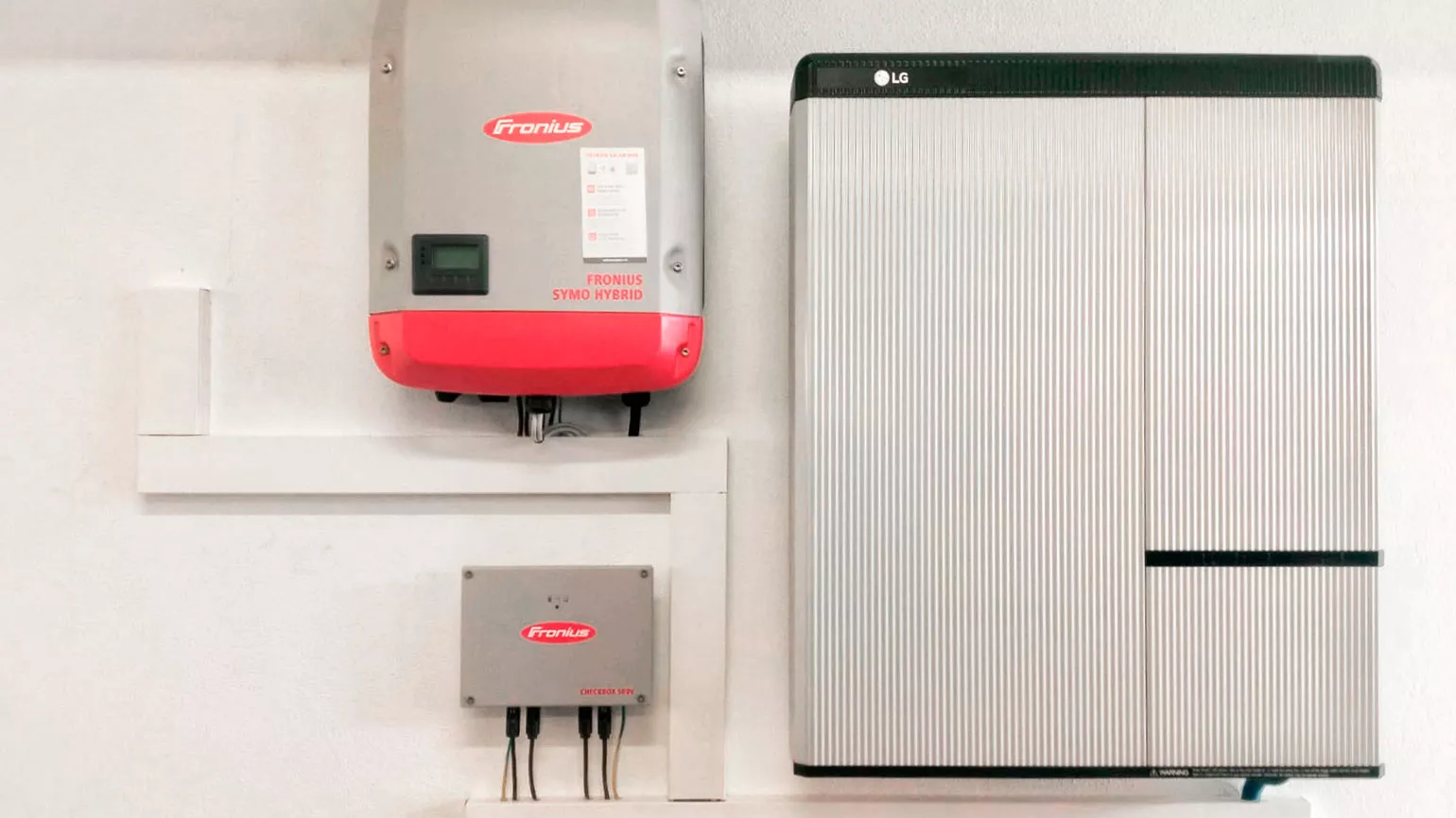

The 5 kWp PV roof-mounted system was installed with a Fronius Symo Hybrid inverter and a LG Chem RESU 10 H battery. Fronius System Partner Duosolar integrated a Fronius Smart Meter System in the installation at the same time, which means they can now benefit from all the monitoring features.

  • A Fronius Symo Hybrid 5.0-3-S inverter and an LG Chem Resu 10 H battery were installed in this system.
  • LG Neon 2 BiFacial PV modules with 315 Wp are used. These absorb a higher degree of irradiance through reflection from the ground onto the rear side of the PV module.
  • The Fronius Checkbox 500V protects against overvoltage.
  • The bidirectional Fronius Smart Meter 63 A-3 checks the grid situation and displays household consumption in Fronius Solar.web.
  • The system has been implemented as a zero feed-in system.
