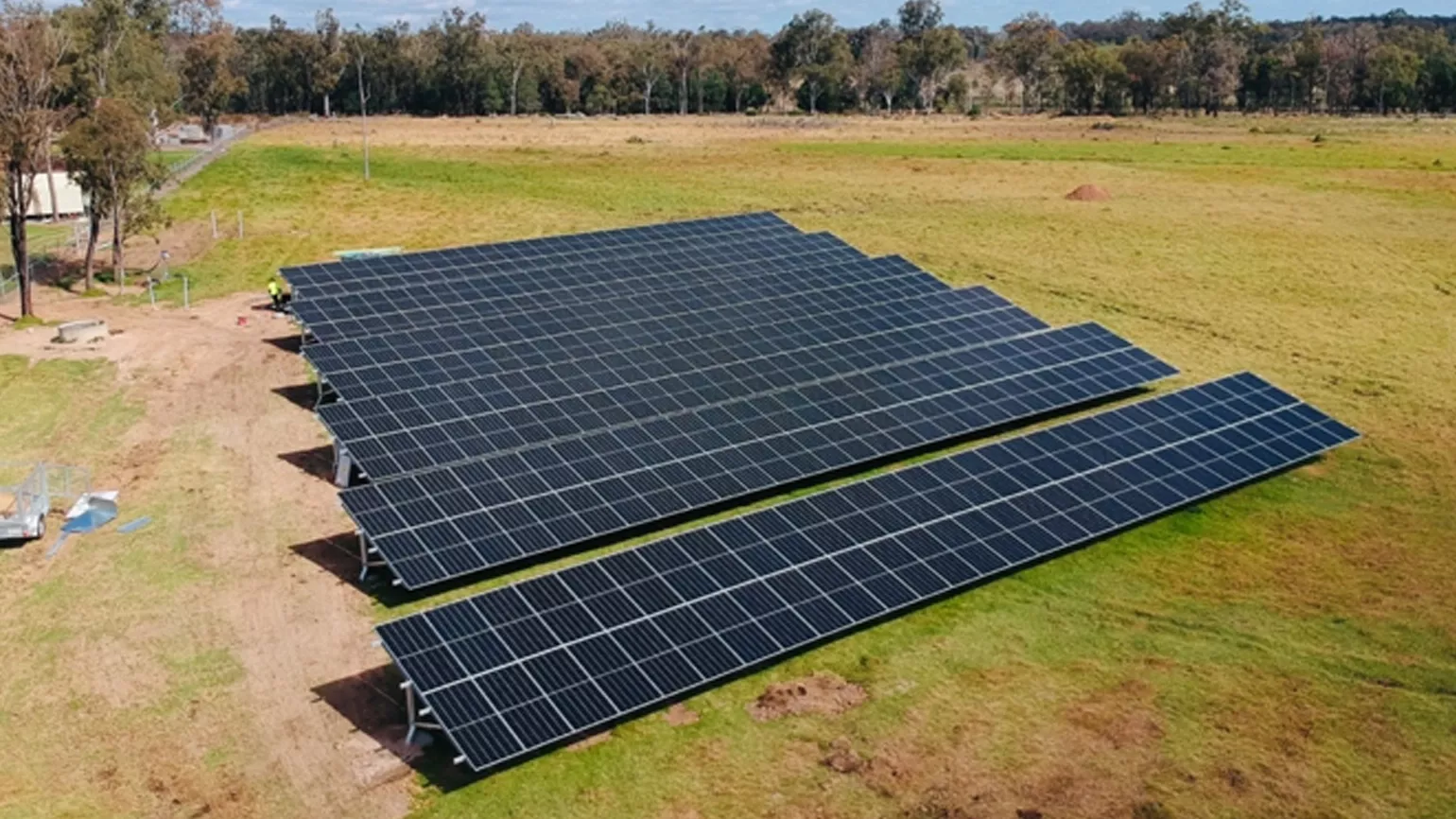

To address these challenges, Adapt Energy installed a ground-mounted solar array 100 meters away from the piggery to avoid local emissions. Key measures included:
  • Engineering Solutions: Significant cable runs and DC combiner boxes ensured minimal voltage drop and maintained system efficiency.
  • Structural Design: Ground mount systems required structural engineering, wind load analysis, and soil testing. The site’s flood-prone area necessitated custom-engineered raised mounting systems.
  • Rainfall Retention: The system’s design retained rainfall effectively, promoting grass growth and allowing sheep to graze under the solar array.
  • Payback Optimisation: The system was designed to maximize energy offset while achieving a feasible payback period.

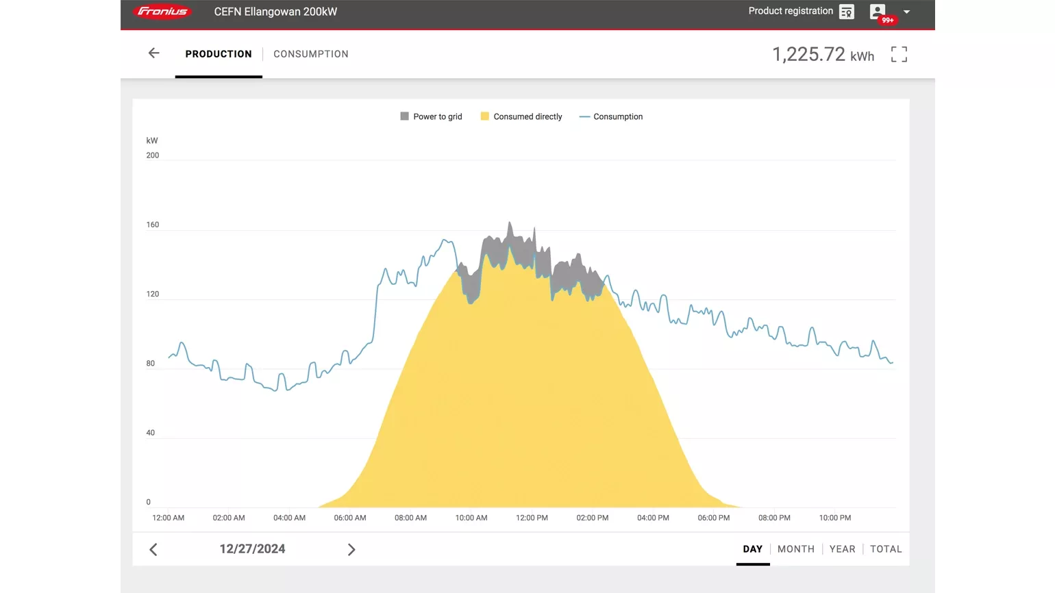

Year 1 Highlights for the 200kW Ground Mount System
  • Energy Production: 304.45 MWh
  • CO₂ Offset: 240.51 tonnes
  • Cost Savings: $85,246
  • Daily Example: The system produced over 1.2 MWh in one day, despite a 17kW export limit.
  • Client Satisfaction: The client has praised the system’s performance, reliability, and monitoring platform, which tracks performance and supports LGC rebate claims.
