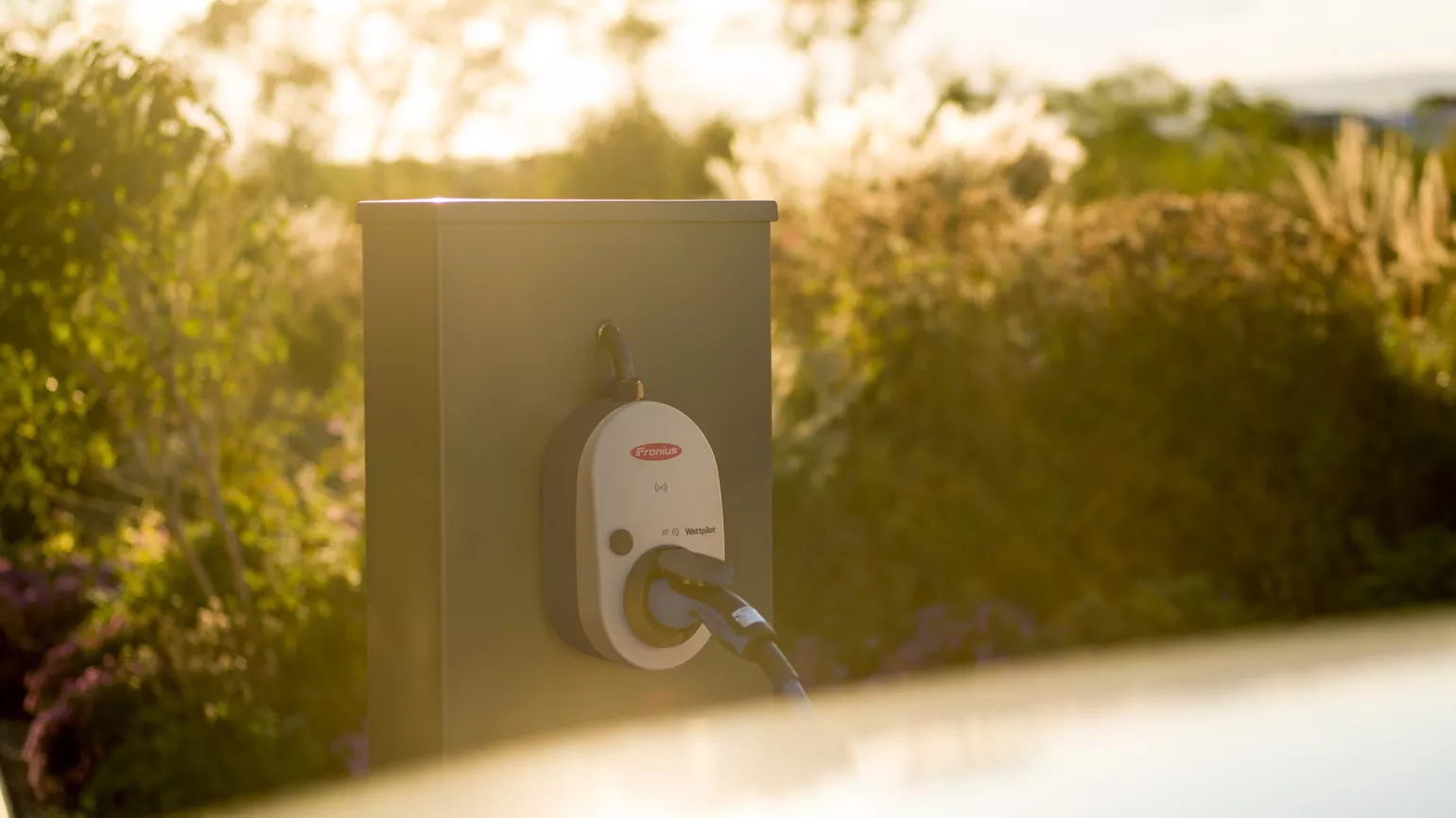

The Fronius Wattpilot Flex is quickly installed and ready for operation in no time at all. Whether indoors or outdoors, on a company parking lot, in an underground garage or in front of a residential building - with protection class IP66, the Wattpilot is optimally protected against external influences. Cables can be routed from the top, bottom or rear of the unit, allowing for flexible system design to suit the location.
The optional pedestal enables precise and clean installation. It is easy to assemble and flexible in use. With its simple design, it fits perfectly with the Wattpilot Flex.
