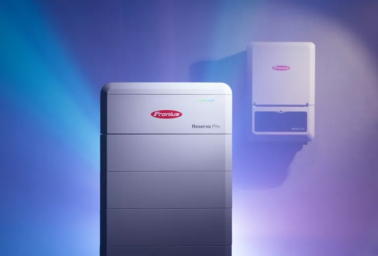

More capacity, more control
The Fronius Reserva Pro is the modular high-voltage battery storage system for increased energy requirements. Each tower consists of 3 to 8 modules and offers 12 to 32 kWh of usable capacity. By connecting up to four towers in parallel, the system can reach a total of up to 128 kWh. In combination with the Fronius Verto Plus hybrid inverter, efficient DC-coupling enables high charging and discharging power of up to 28.3 kW for large loads.
With the Fronius Warranty, you are assured of 10 years of consistently stable performance. Durable LFP cells and integrated protection mechanisms ensure smooth operation far beyond the warranty period. For particularly profitable and demand-driven operation, the AI-supported Fronius Energy Cost Assistant continuously analyzes PV yield, load, and electricity prices, optimizing the storage strategy accordingly.

Data Reserva Pro 12.0 Reserva Pro 16.0 Reserva Pro 20.0  Reserva Pro 24.0 Reserva Pro 28.0 Reserva Pro 32.0
Usable energy 11.9 kWh 15.9 kWh 19.9 kWh  23.9 kWh 27.9 kWh 31.9 kWh
Number of battery modules 3 4 5 6 7 8
Nominal voltage 212.52 V 283.36 V 354.2 V 425.04 V 495.88 V 566.72 V
Operating voltage range 165 ~ 240.9 V 220 ~ 321.2 V 275 ~ 401.5 V 330 ~ 481.8 V 385 ~ 562.1 V  440 ~ 642.4 V
Maximum output current1 50 A
Battery cell chemistry Lithium iron phosphate (LFP)
Parallel operation
Up to 4 batteries
Dimensions (Height x Width x Depth) 775 x 579 x 449 mm 935 x 579 x 449 mm 1.095 x 579 x 449 mm  1.255 x 579 x 449 mm   1.415 x 579 x 449 mm  1.575 x 579 x 449 mm
Weight 126 kg 162 kg 198 kg 234 kg  270 kg  306 kg
Compatible inverters Primo GEN24 Plus (SC)
Symo GEN24 Plus (SC)
Verto Plus
Verto Plus
Verto Plus
Verto Plus
Verto Plus
Verto Plus
Ingress protection (IP) rating IP65
Max. altitude above sea level 2,000 m
Ambient temperature range² -20 to +50°C
Permissible humidity 5-95 %
Installation Indoor and protected outdoor areas
DC connection technology Stäubli MC4 Evo Stor
Certificates and compliance with standards VDE2510-50 / IEC 62619:2022 / IEC62040-1 / CE / RCM / UN38.3
Interfaces Modbus (RS485)
Warranty 10 years (75% SOH)
1 The charging and discharging current is limited by the inverter.
2 Depending on the temperature, the charging/discharging capacity may be limited.
