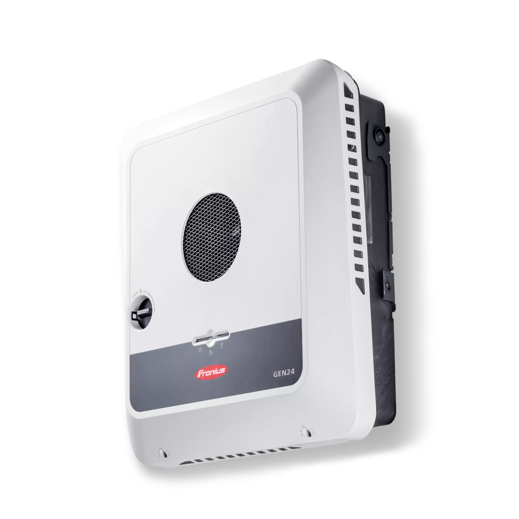

Fronius GEN24 & GEN24 Plus.
Designed to empower.
Inverter with backup power function for private households
Ready for the private energy revolution: With our Fronius GEN24* inverter at the heart of their private photovoltaic system, households can produce their own energy sustainably and inexpensively. The Fronius GEN24 Plus hybrid inverter even enables a battery storage system to be used, providing complete energy self-sufficiency for electricity, heating, cooling, and e-mobility, even at night.
While the Fronius GEN24 offers an integrated basic backup power supply in the form of the PV Point, the Fronius GEN24 Plus** can also provide a comprehensive Full Backup power supply via a connected battery storage system.

Your energy supply must be reliable. That’s why the Fronius GEN24 offers an integrated basic backup power supply. Backup power is supplied to connected devices up to 3 kW via the PV Point socket, as long as the sun is shining.
With the PV Point and Full Backup*, the Fronius GEN24 Plus offers two backup power options: a power supply for loads of up to 3 kW via a single socket and a backup power supply for the entire home, including large, three-phase loads such as heat pumps.
* The Full Backup option is not available for the Fronius Symo GEN24 3.0–5.0 Plus. For Full Backup, a battery and a switching device for safe grid disconnection are required in addition to the inverter.

Fronius GEN24 SC
Fronius GEN24
Technical data
Technical data
Primo GEN24 (SC)
Primo GEN24 Plus (SC)
Symo GEN24 (SC)
Symo GEN24 Plus (SC)
Single-phase / three-phase single-phase 230 V three-phase 230 / 400 V
Power classes 3 / 3.6 / 4 / 4.6 / 5 / 6 / 8 / 10 kW 3 / 4 / 5 kW*  6 / 8 / 10 kW
MPP-Tracker 2 2
Protection class IP 66 IP 66
Dimensions
(h x w x d) in mm
474 x 530 x 165  474 x 530 x 165 529 x 595 x 180
DC input voltage
(Udc min - Udc max)
65 V - 600 V 80 V - 1.000 V
