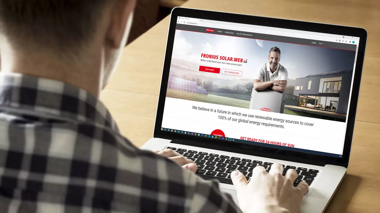

Monitoring
Fronius Solar.web is fully available as a desktop and app version for monitoring your Fronius Tauro inverters.
The new Solar.web app, you can already download on your smart device in the Apple App Store or Google Play Store!
For more information about Solar.web, click here
Download Solar.web App here:
