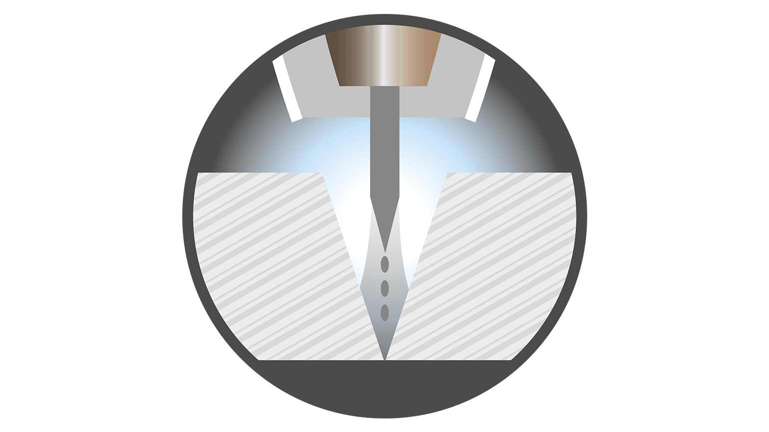

PCS - PULSE CONTROLLED SPRAY ARC
PCS combines the advantages of pulse and spray arcs in one characteristic. The PCS characteristic ensures that intermediate arcs are avoided. The result is a smooth transition from a pulsed arc to a spray arc, which reduces welding spatter. For this reason, PCS is most often used for small gaps, fillet welds and root passes.
The advantages of PCS:
  • Minimal joint preparation
  • High deposition rate
  • Higher welding speeds Less rework
