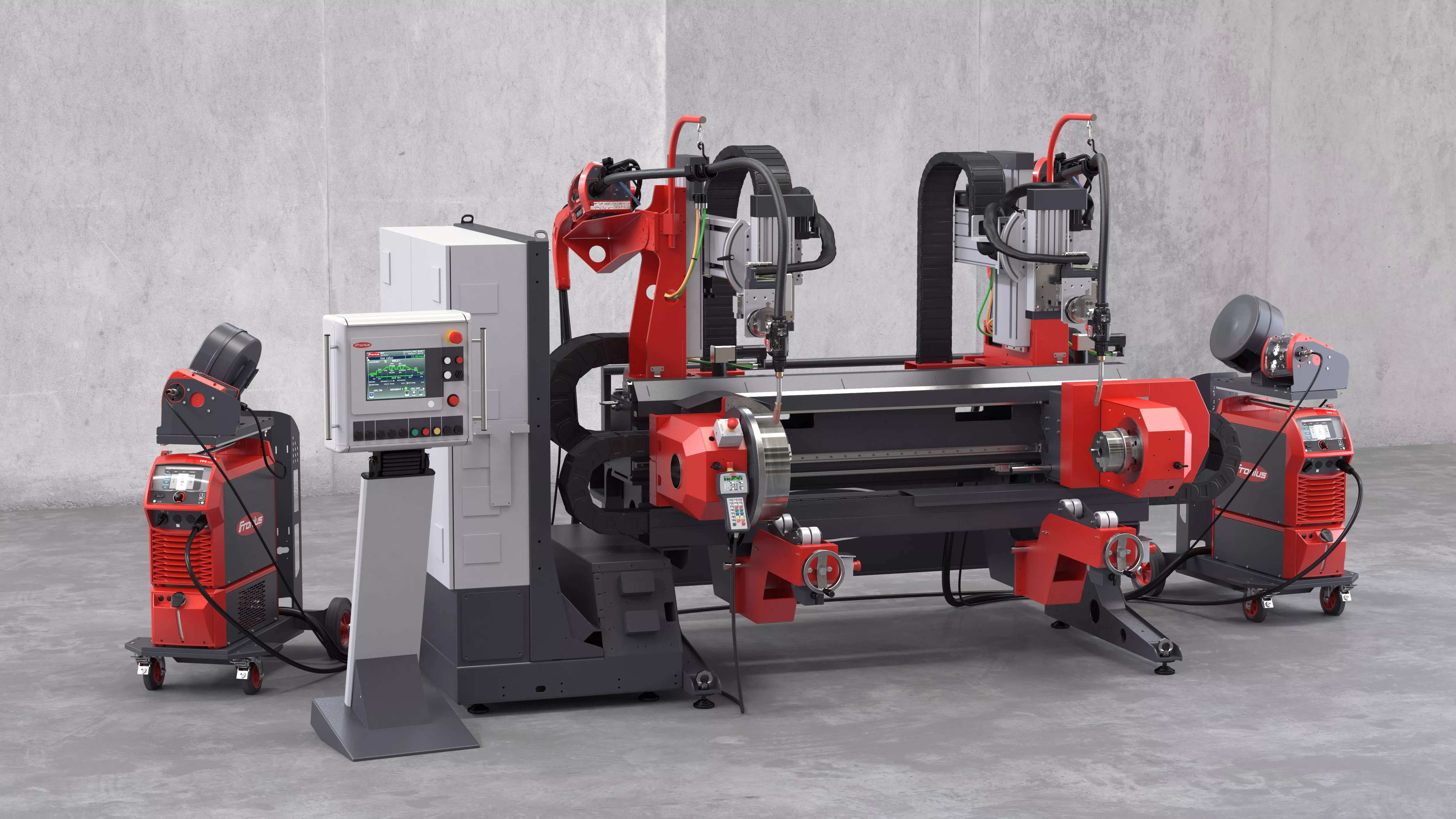

FCW Compact
A single circumferential welding system for a wide range of tasks
Different components, but only one welding system
Welding processes: MIG-MAG, CMT, TIG, ArcTig, PLASMA
Parent materials: steel, stainless steel, aluminum, duplex, nickel-based alloys
The FCW Compact comes into its own in industries where different components such as pipes, flanges, reducers, fittings, or valves of different alloys need to be welded efficiently and cost effectively: a single compact welding system for a wide range of tasks.
Contact
AUTOMATED WELDING WITH THE FCW COMPACT
  • Wide range of functions but takes up little space
  • Configurable for component lengths of up to 6 m
  • Component diameter up to 500 mm
  • Second welding head unit, independently controllable (option)
  • Tailstock with electropneumatic clamping system
  • Software packages: Automatic control of arc length, oscillation, overlay welding
  • Parameters can be changed during the welding process
Variants
 Type  Max. component length
 FCW Compact 1000  1000 mm
 FCW Compact 3000  3000 mm
 FCW Compact 4000  4000 mm
 FCW Compact 6000 6000 mm
SOFTWARE AND SAFETY OPTIONS
  • Software package for overlay welding
  • Software packages for arc length control (AVC/ASC) and linear oscillation
  • Software packages: Welding data actual value recording (AVR), DataLogger HMI and Data Viewer HMI
  • Glare protection with articulated arm, safety enclosure, extraction arm for welding fumes
