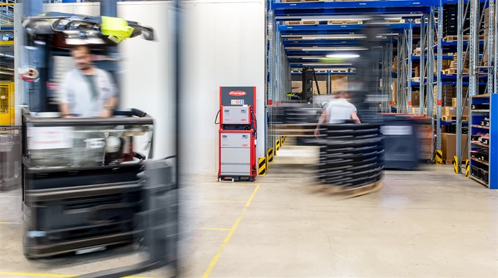

| The charging infrastructure is centrally located at the site. | The charging infrastructure is placed in decentralised locations along the flow of goods. |

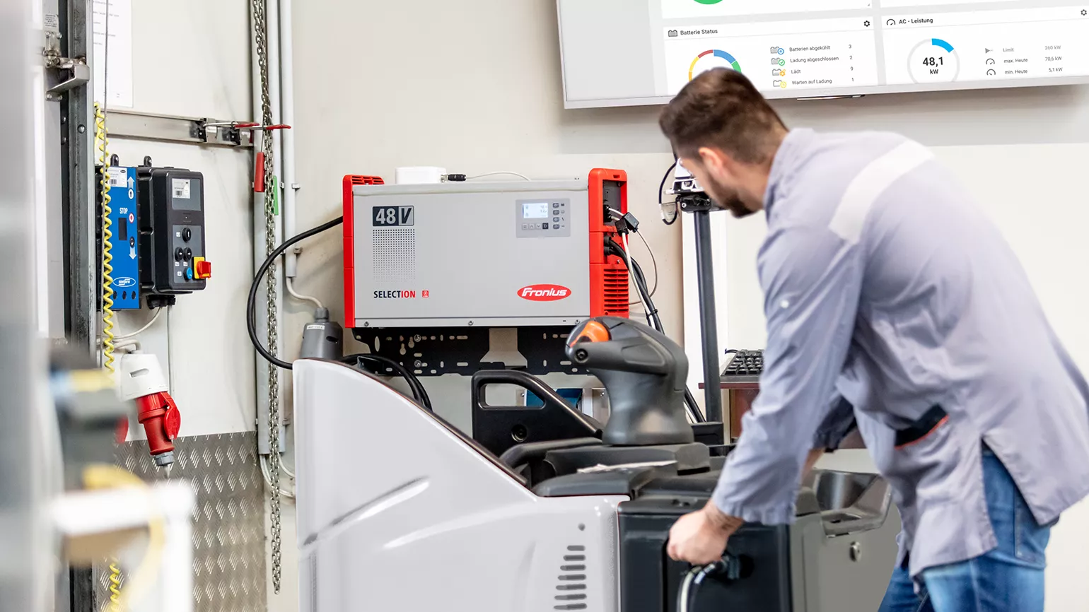

Forklift truck getting connected to the SelectION lithium-ion battery charger.
Keep charging, stop changing. Unlike lead-acid batteries, lithium-ion batteries remain directly
in the forklift truck during the charging process and are charged via a plug
connection. The charging process in multi-shift operation is characterised by
frequent fast and opportunity charging of the lithium-ion battery - for example
during the lunch break. Removal of the battery from the forklift truck - as is
the case with lead-acid batteries - is not necessary. The required charging

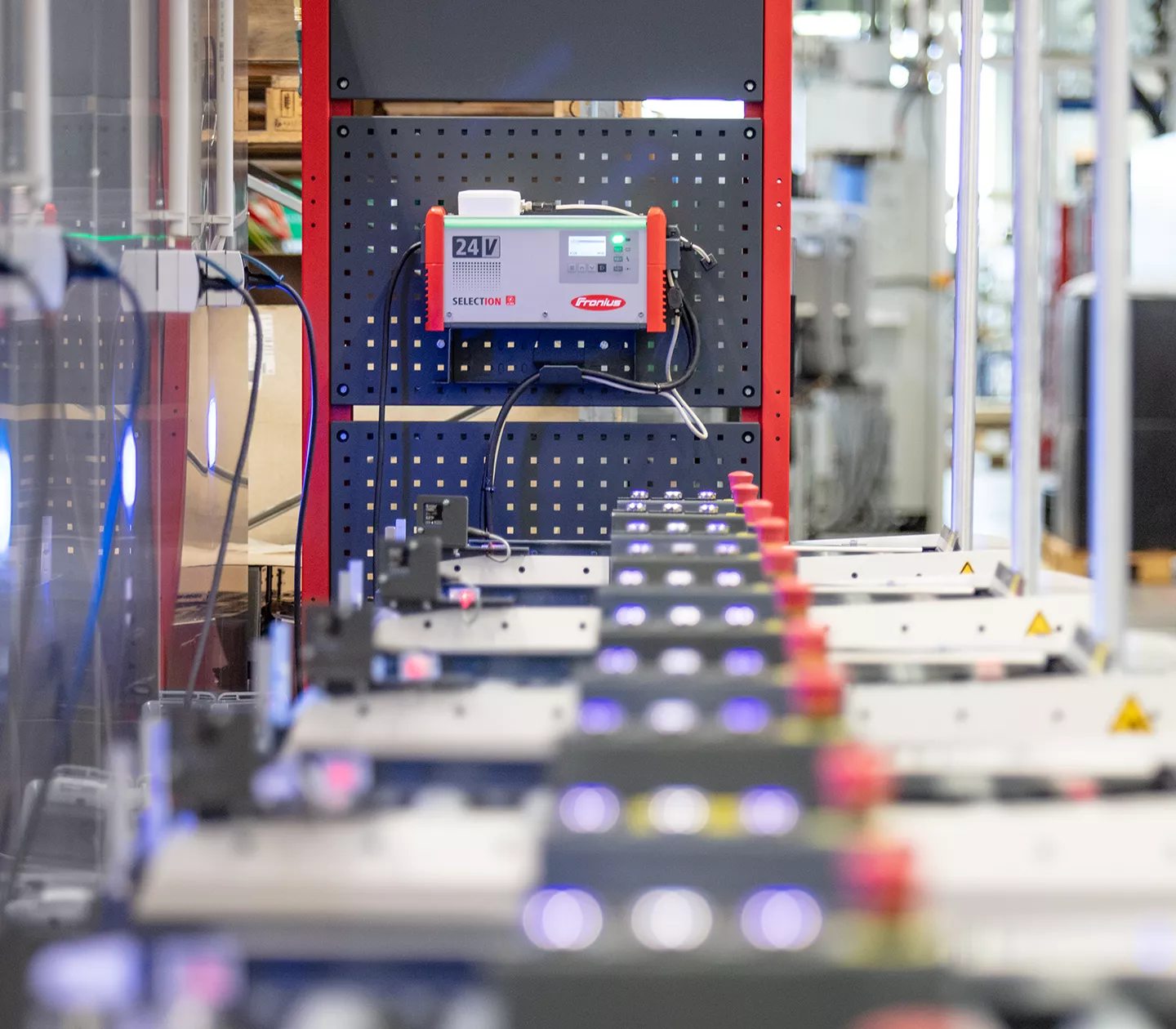

infrastructure for lithium-ion batteries can therefore be placed flexibly and
in a space-saving manner along the flow of goods. In combination with our
flexible EnergyHub,
you can also relocate the charging process to the outside area, thus providing
additional space and safety.
