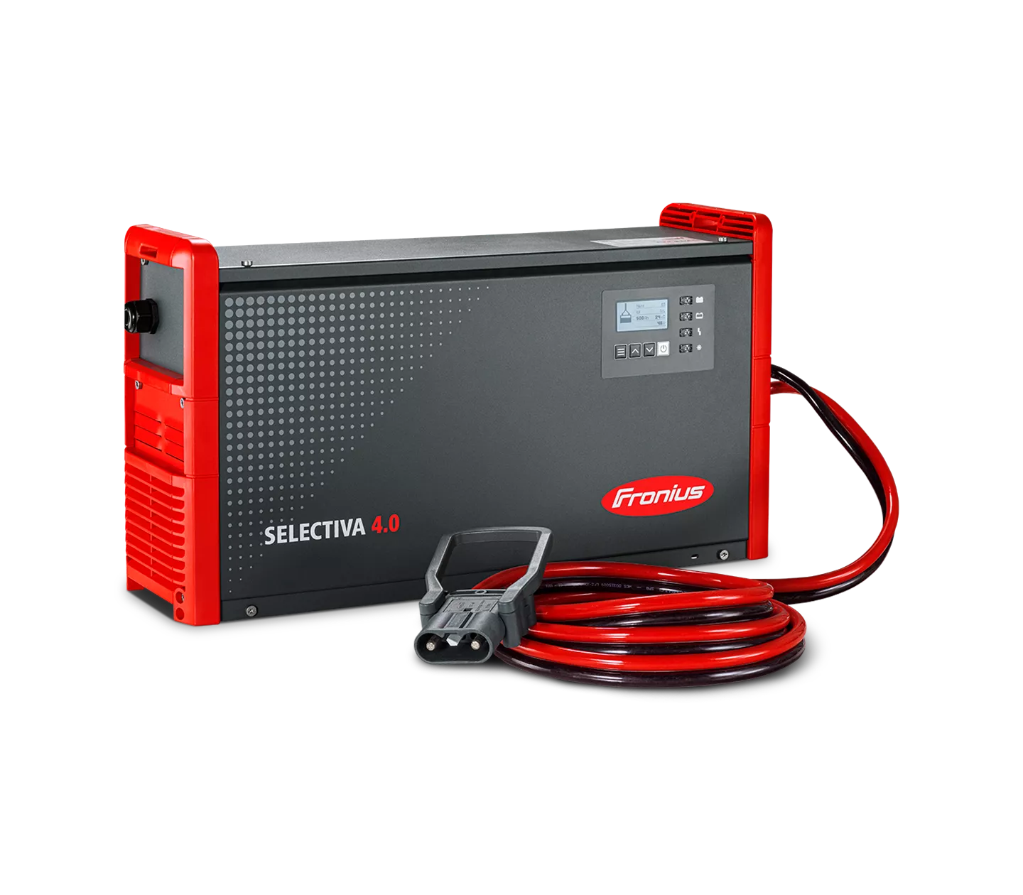

On top of this, the Selectiva 4.0 battery chargers offer a special deep discharge characteristic that can be easily set on the charger itself. Harmful sulphation caused by extended downtimes or older lead-acid batteries is thus reliably reduced. This significantly improves the capacity and performance of the battery. A clear advantage over other battery chargers, which often fail when batteries are in a deep discharge state, as the battery voltage is too low and can no longer be detected.
It is also important that a compatible battery charger and battery are selected. Thanks to their automatic voltage detection, the devices from the Fronius Selectiva series are suitable for different types of batteries, with various voltages and capacities – this makes allocation significantly easier. As a result, forklift truck operators can fully depend on the readiness of their traction batteries, even after extended downtimes.

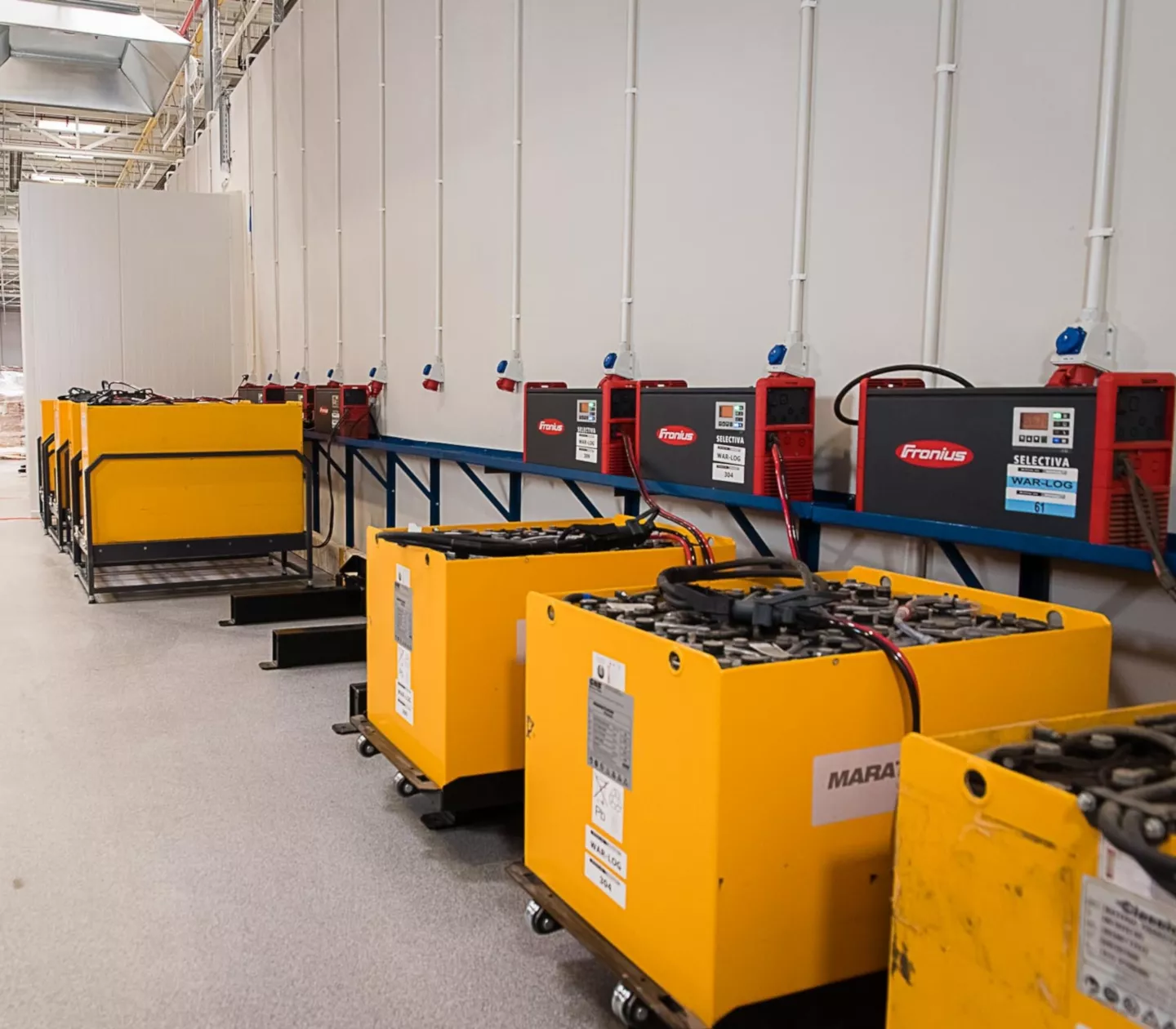

During long periods of idle time, lead-acid batteries should be stored in a charged state – otherwise there is a risk of damage, which can drastically reduce the battery life.

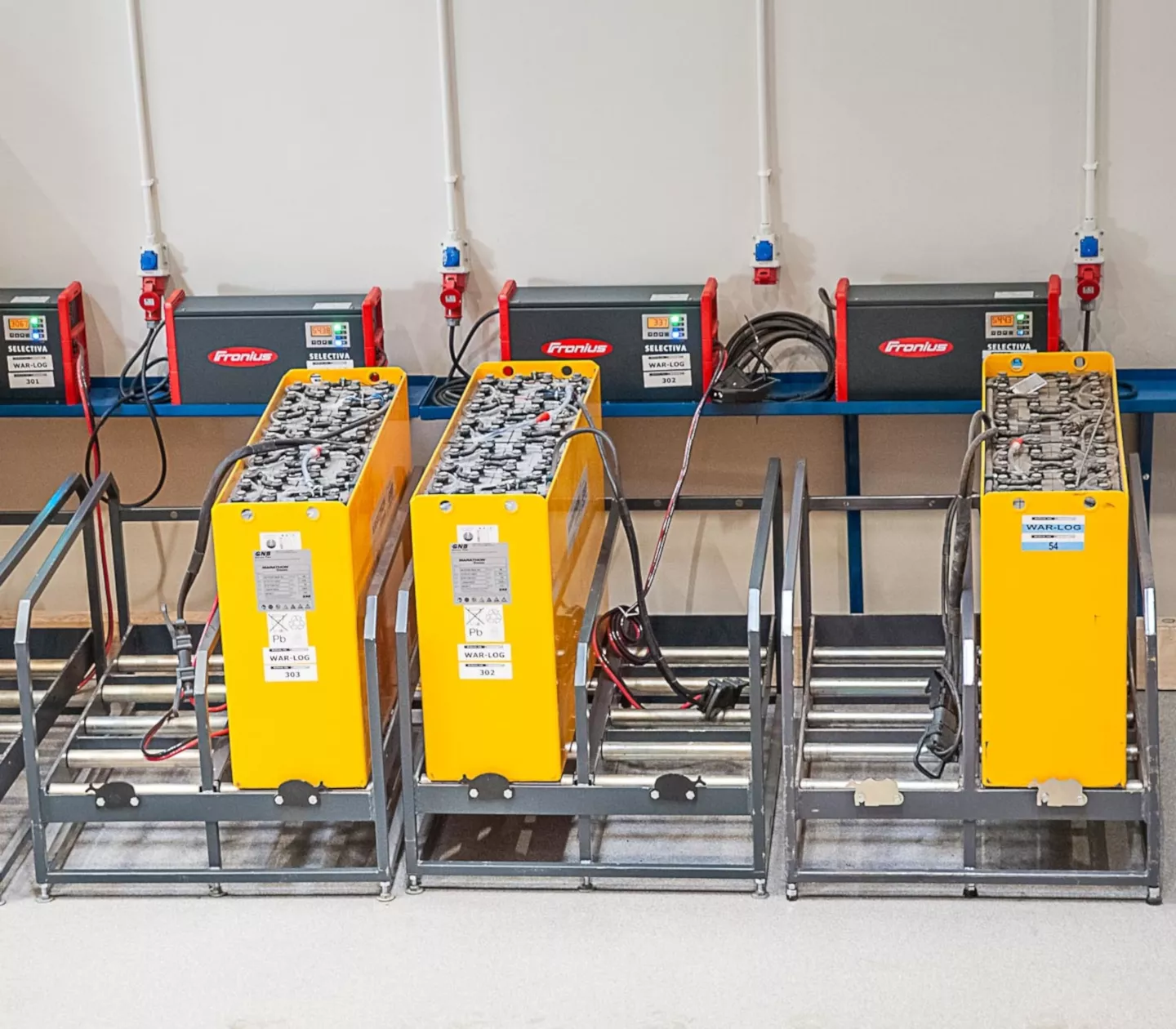

Professional battery maintenance is the best way to ensure that the forklift truck fleet is ready for use again after extended downtimes.
Fronius battery chargers have a dedicated conservation charge feature, which continuously supplies the battery with power to prevent discharging.
