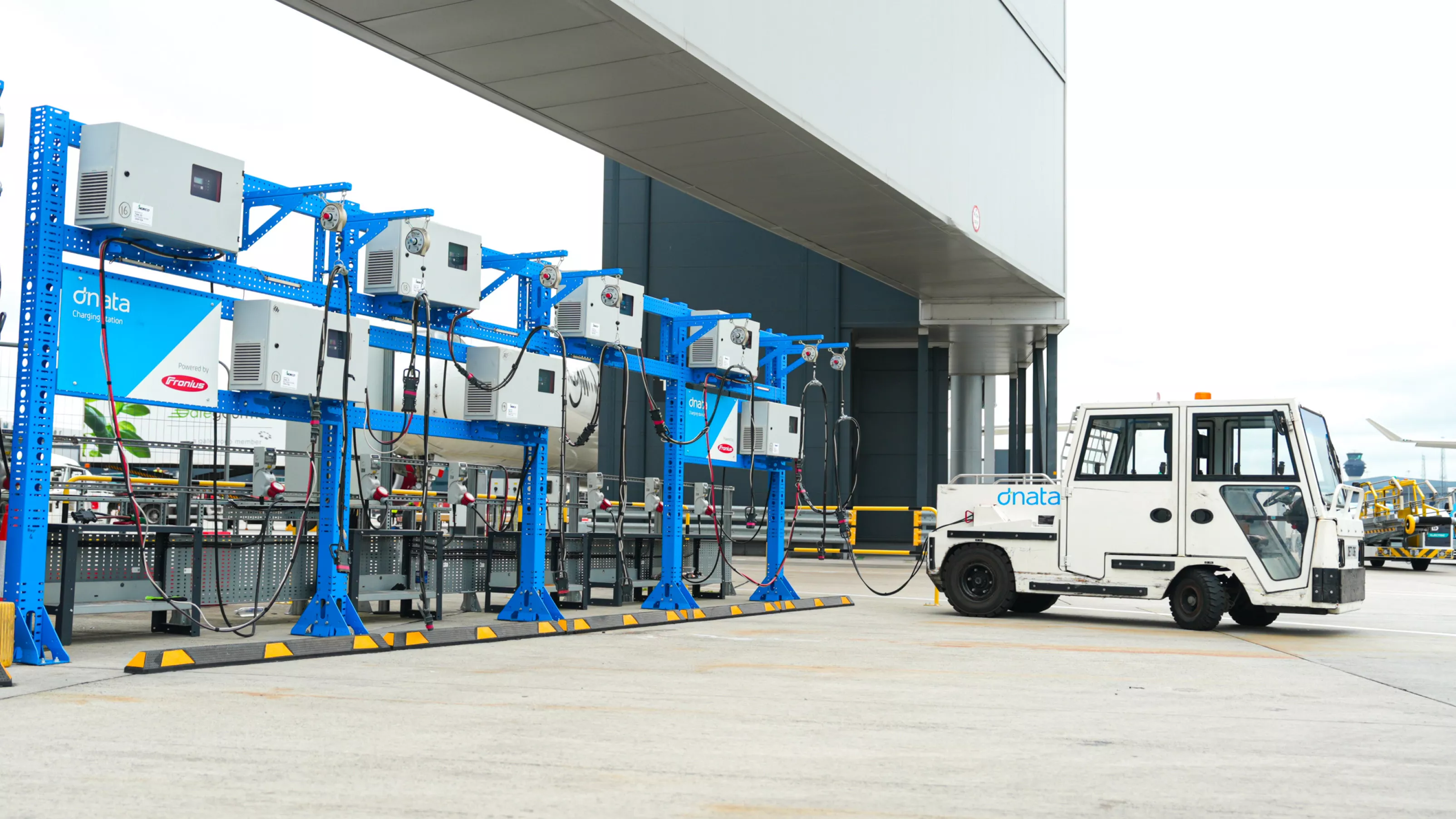

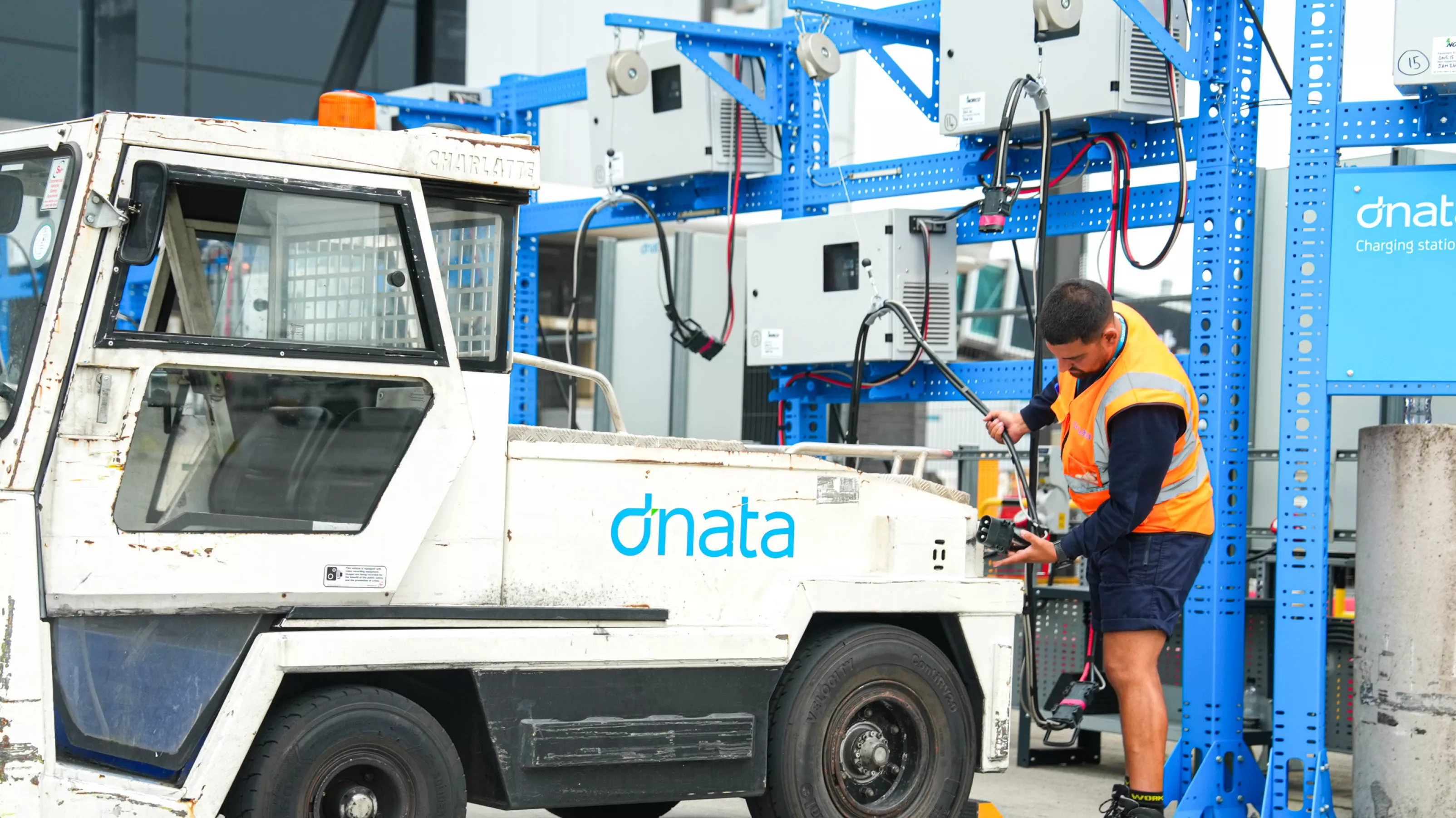

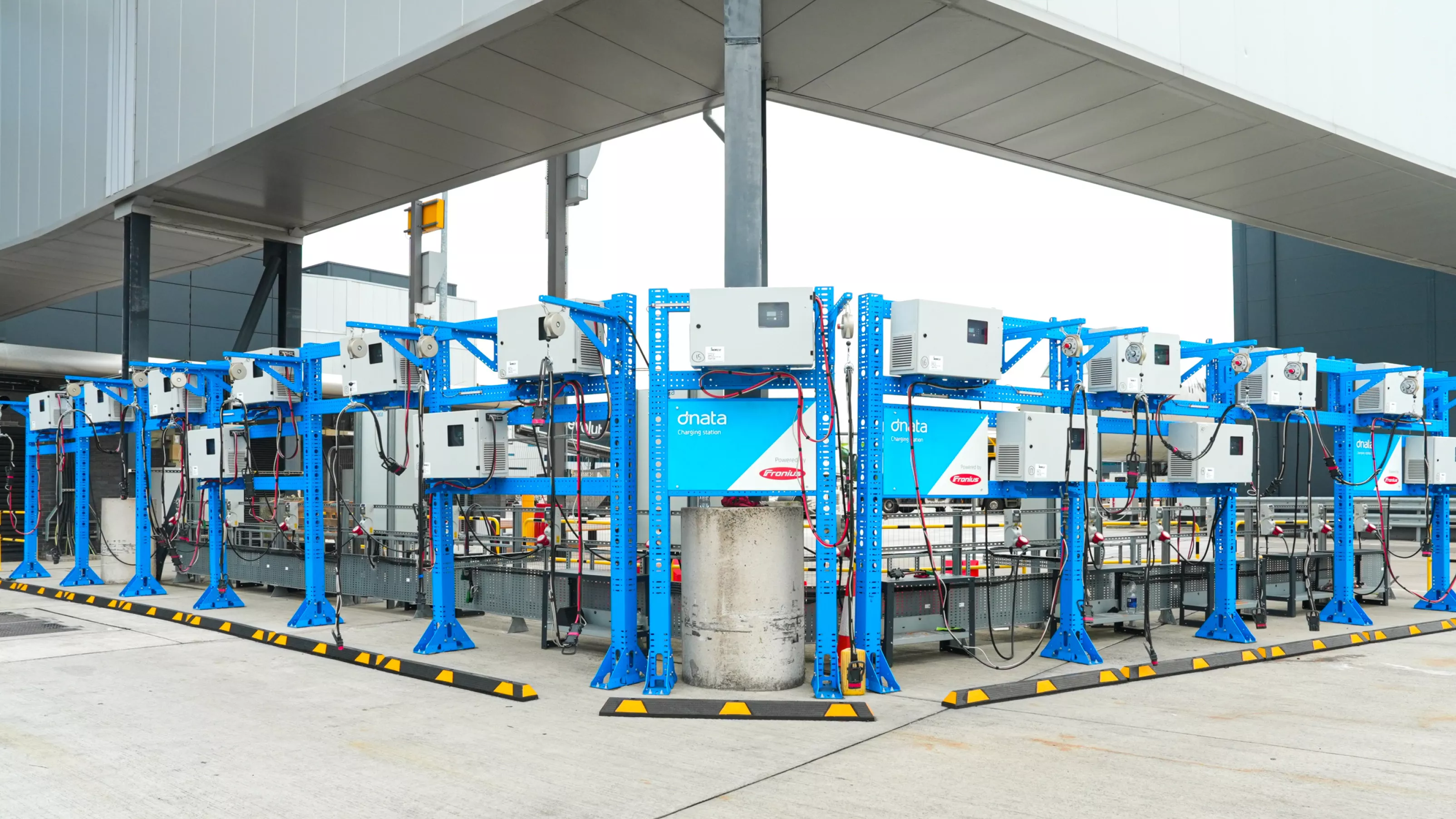

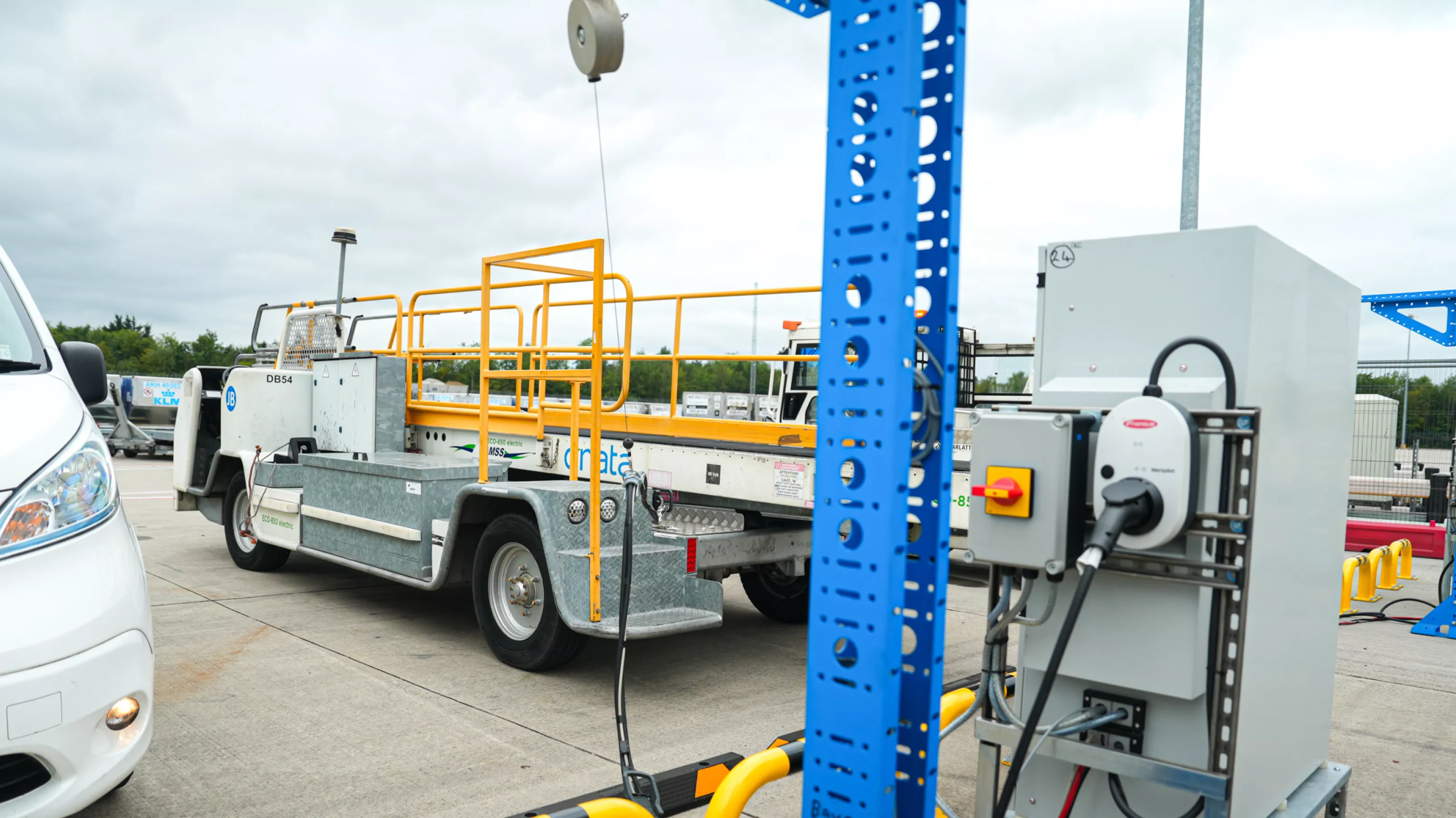

The project introduced two dedicated charging zones: a main area featuring 22 Selectiva 4.0 chargers, and a bespoke, dual-purpose, sub-area equipped with a further two Selectiva 4.0 chargers and two Wattpilot EV chargers. All chargers are housed in IP-rated cases for outdoor use, complete with racking and safety barriers. Exterior LED indicators provide instant visual feedback on battery status - green for fully charged, yellow for charging and blue for optimal readiness - ensuring visibility in all weather conditions.

The new airside location consolidates the operations team and charging infrastructure into a single hub, streamlining workflows and improving accessibility. With only a 3–4 hour window each day to charge the EBT’s, the expanded setup ensures all vehicles are ready when needed, minimising downtime and maximising efficiency.
Fronius’ Charge & Connect digital monitoring system, coupled with Tag ID battery sensor technology, have been instrumental in delivering intelligent fleet management. These systems allow dnata to monitor battery health in real time, plan maintenance proactively, and optimise budgeting for replacements. Nick Williams, Airside Fleet Supervisor, noted: “With Charge & Connect, it means I can monitor the health of the batteries and forward plan so that if I have a failing battery, a replacement can be ordered, which means less downtime for the vehicles.”

Beyond operational gains, the new system has delivered measurable environmental benefits. Thanks to Fronius’ intelligent charging curves, dnata has significantly reduced water consumption for battery maintenance - from 10 litres per battery per week to just 2 litres, with some weeks requiring none.
