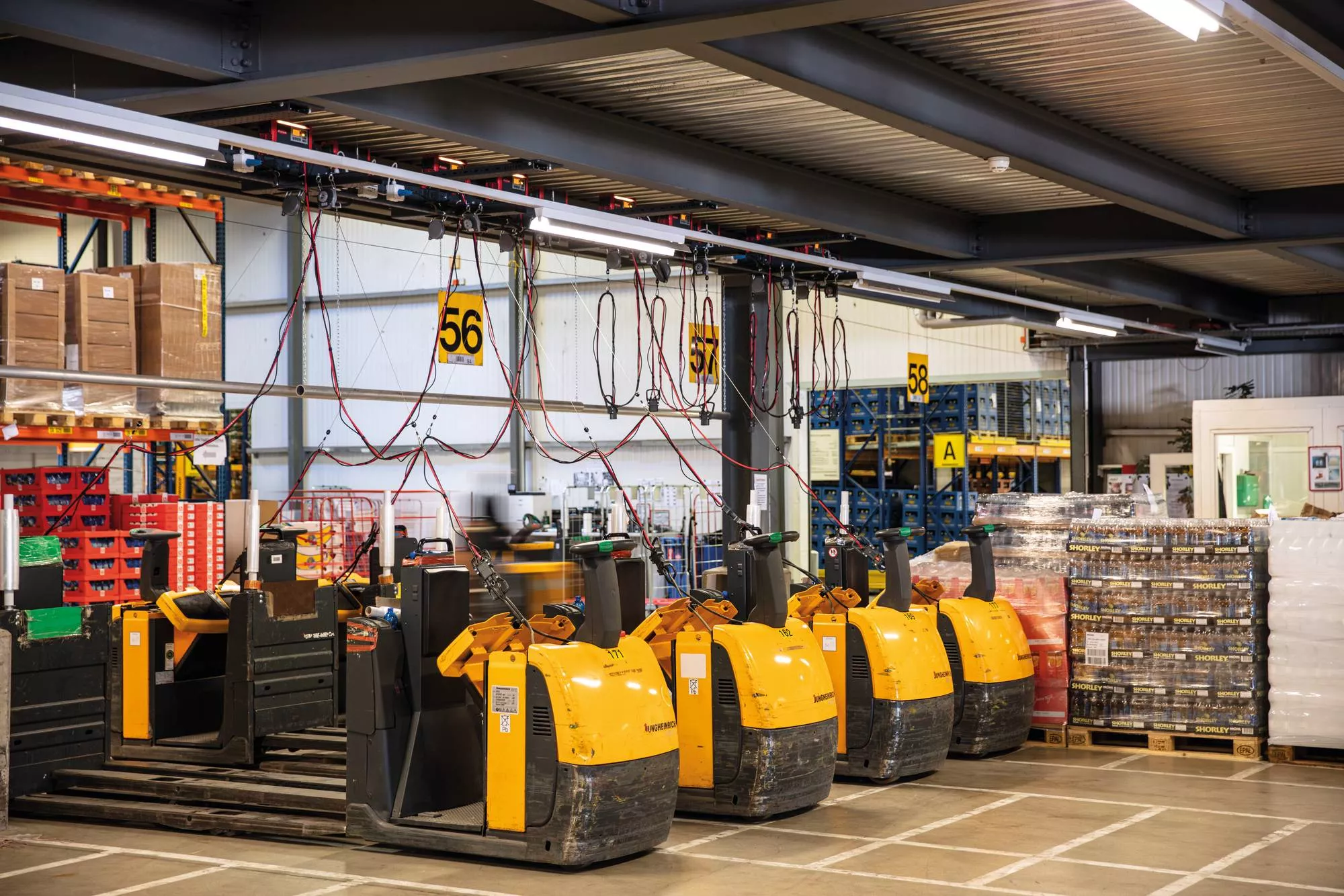

Mounted above head height to leave more space in the hall

The most important change was moving the battery charging technology from the basement to the ground floor, to the workspace of the forklift truck fleet. Fronius Selectiva battery chargers are ideal for this: they are far smaller and lighter than the 50 Hz devices previously used, allowing a flexible and space-saving approach to installation. Fronius set up a number of decentralised charging areas that are within easy reach for forklift operators. Chargers are attached to the wall, for example – or in one case, are even integrated above head height in the steelwork construction of a high-bay warehouse. A spring balancer ensures that the charging cables do not rest on the floor when not connected to a battery. “Of course, we made sure that all safety rules and standards were met for every variant,” notes Baumgartner.
