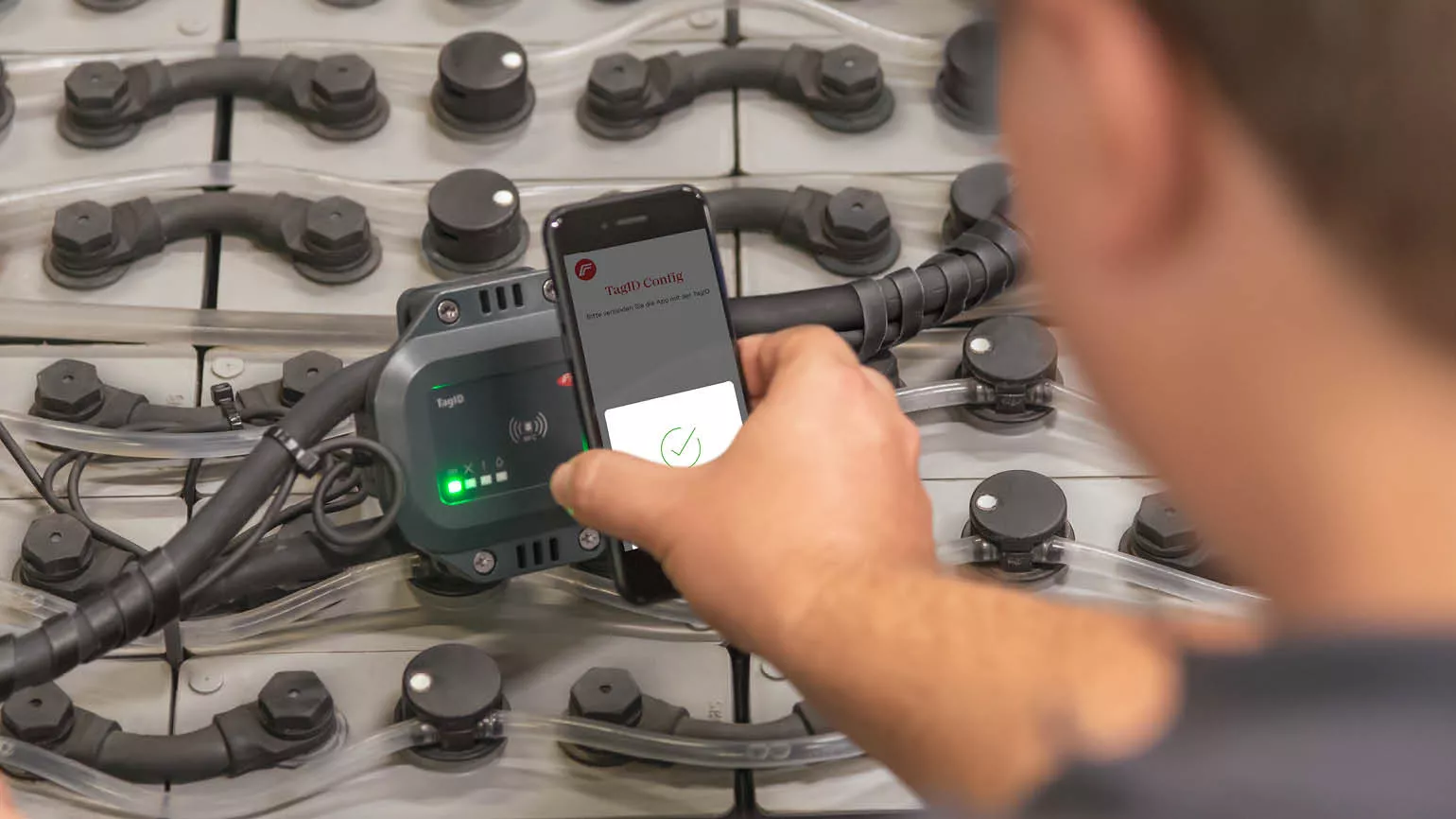

TagId Config App
Using the NFC interface, the TagID can be configured quickly and easily via the TagID Config app. The user-friendly interface of our app assists in entering the few necessary parameters. The TagID automatically checks whether the voltage value entered during configuration matches the actual measured value. Deviations are detected immediately and consequential damage is thus effectively prevented.
