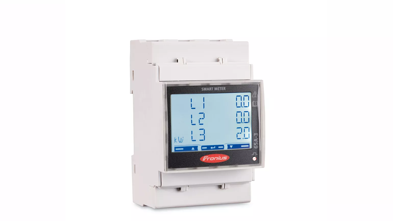

Fronius Smart Meter
The Fronius Smart Meter is used to visualize the power flow in a system on Fronius Solar.web, including the direct consumption of the produced pv power as well as how much excess energy is available. This enables smart energy management solutions to improve self-consumption.We recommend installing the Fronius Smart Meter at the grid feed-in point, where it measures the ingoing and outgoing power of the whole system. The Smart Meter communicates with the GEN24 inverter via Modbus RTU (RS485).
The Fronius Smart Meter is required when installing Fronius Storage Solutions, the Fronius Ohmpilot or the Fronius Wattpilot. It is also required for setting up a dynamic power reduction, in case a feed-in limitation is required by the grid operator.
