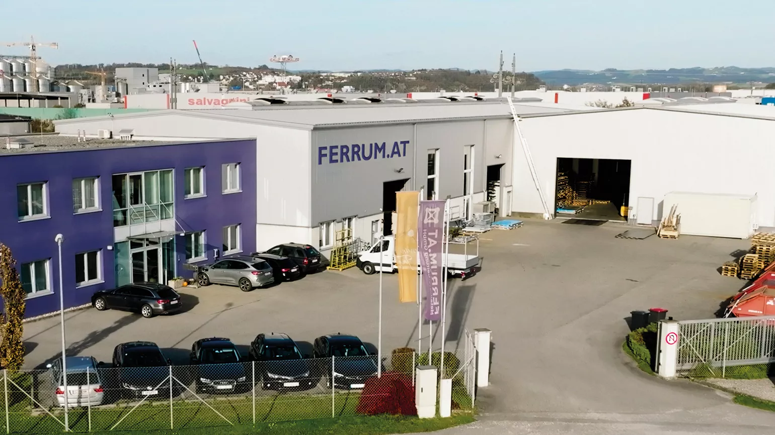

Great success stories often begin in small garages, and this was certainly the case for FERRUM.AT. In 2009, Hannes Holl founded a small metalworking shop in Schwertberg, Upper Austria, which, within a few years, evolved into a renowned contract manufacturer for both industry and commerce. These days, the company, which holds multiple certificates, manufactures a wide range of metal components for renowned national and international clients at its Ennsdorf site. In its search for intelligent, multi-functional welding systems for MIG/MAG applications, FERRUM.AT Metallverarbeitung GmbH found in Fronius the perfect partner to improve not only welding quality and efficiency, but also its own competitiveness.

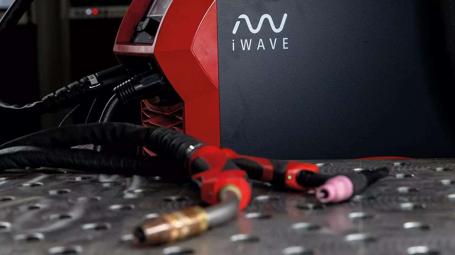

Component accessibility, materials, and molding often require individual components to be welded at FERRUM.AT using both the MIG/MAG and TIG processes. Previously, we had to use two different types of equipment for this: a MIG/MAG unit and a separate TIG unit, but this is thankfully no longer the case as we can now use the recently acquired multi-functional welding systems from Fronius.
The space requirement was huge, and the constant switching between the two welding systems inefficient, so the company had been on the lookout for powerful and reliable multi-process welders for a long time. The new units should enable significant time savings and thus increased efficiency, without sacrificing welding quality and tool life.

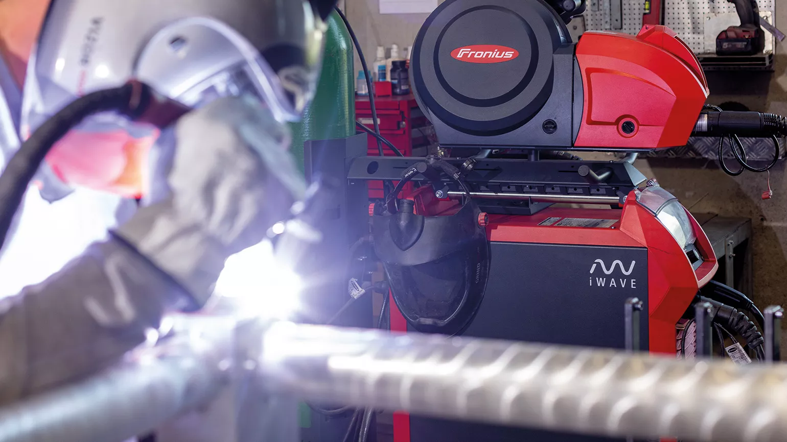

As a long-standing Fronius customer, the Ennsdorf-based metal construction company was one of the first to try out the new iWave AC/DC 400i digital multi-process unit in a one-month test period. The results were impressive. The metalworkers found that they did not have to compromise their standards in terms of operation or welding results. On the contrary:
“We now have two unrivaled machines that facilitate particularly fast switching between the MIG/MAG and TIG welding processes,” reported Managing Director, Hannes Holl, enthusiastically. “At the same time, we benefit from considerable time savings, coupled with a notable improvement in comfort and welding quality. This represents the next step forward for us. Standing still is not an option if you want to remain competitive.”

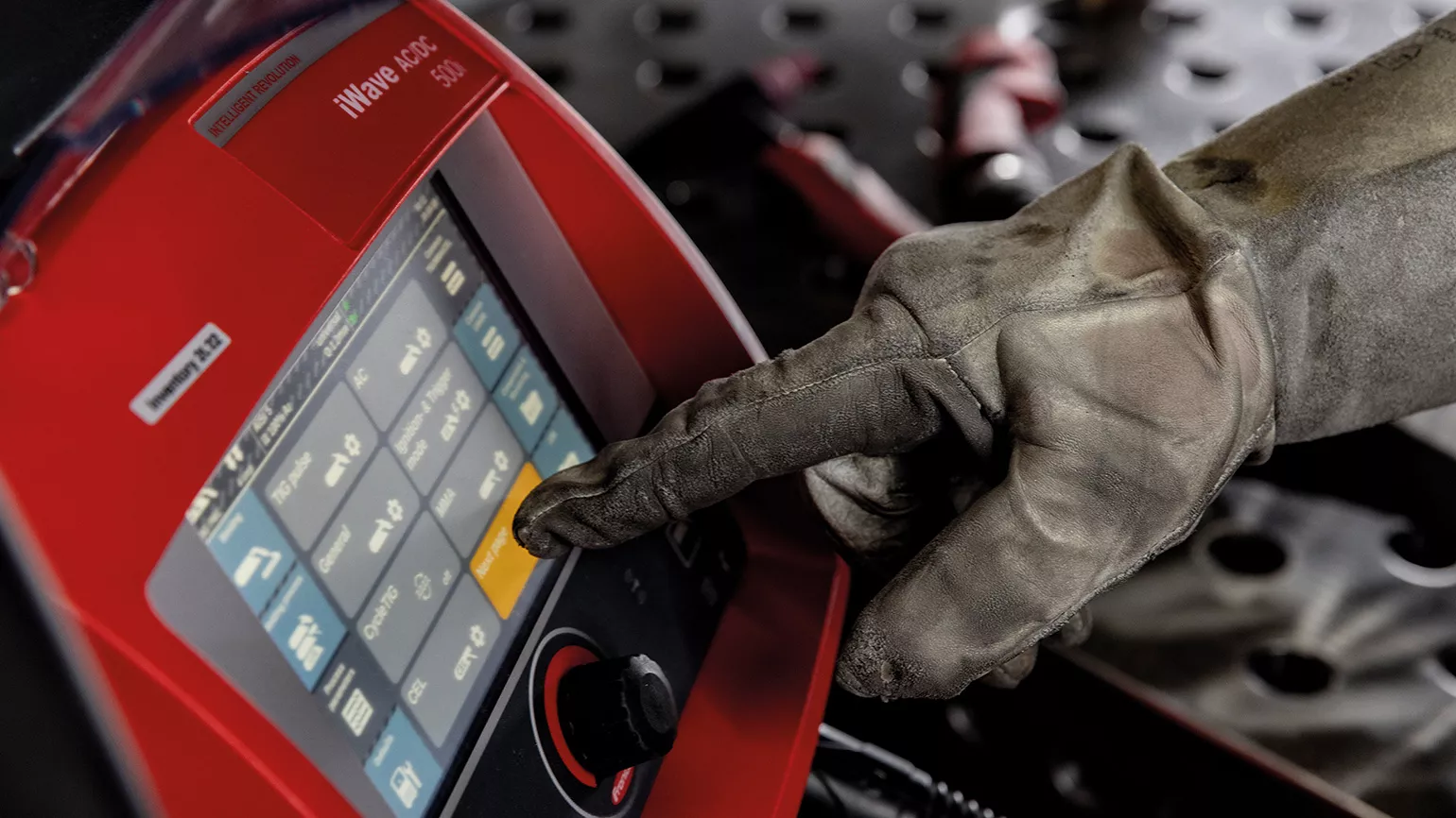

Superior-quality manual welding requires a great deal of experience and skill. This is especially true for TIG welding. The more intuitive and comfortable a welding system is to operate and the more support its intelligent functions give to welders, the more they are able to focus their attention on the actual task, and achieve the perfect welding result. To this end, the iWave helps to significantly alleviate the pressure on FERRUM.AT professionals: Its menu navigation is self-explanatory and available in over thirty languages, and the touch display and setting wheel are easy to operate even while wearing gloves.
