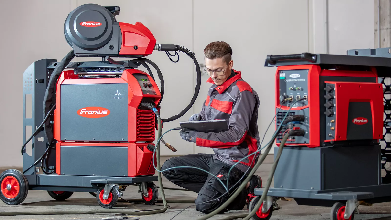

    Quality assurance to EN/IEC 60974-14 straight from the manufacturer
    At Fronius, the customer’s production quality has top priority. To ensure this level of quality is retained in the long term for power sources, regular calibration is necessary. For welding technology companies it is particularly important that devices deliver equivalent and consistent welding results throughout their entire service life. Fronius therefore recommends an annual calibration interval and performs calibration in compliance with the latest regulations, both for arc welding systems and for DeltaSpot.
    When a welding system MUST be calibrated:

    The service in detail
    • Detailed system check
      • Measurement of voltage, amperage and wire speed
      • Analysis of results with regard to adherence to tolerances
      • Recalibration of the system – welding parameters are accurately adjusted
    • Observance of
      • Quality assurance standards of the ISO 9000-ff series
      • Product liability law
      • EN EN/IEC 60974-14 (validation of arc welding equipment)
    • Calibration certificate and test record issued, including measured values
    • Calibration sticker affixed on completion of calibration
    Fronius technicians are also happy to calibrate welding systems made by other manufacturers on request.
