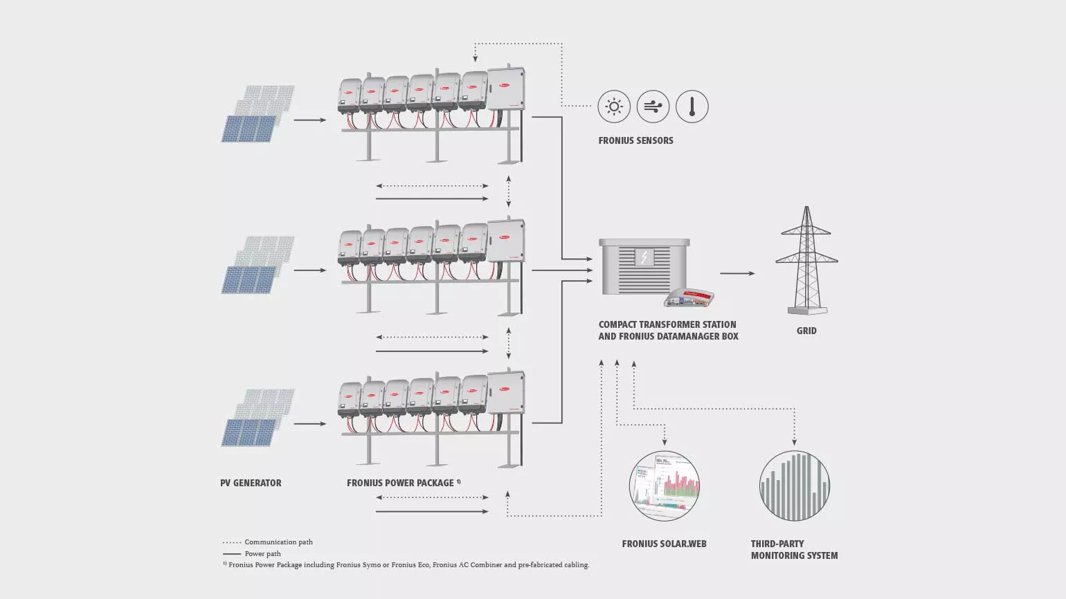

MAXIMUM FLEXIBILITY
MAXIMUM FLEXIBILITY IN DATA COMMUNICATION
In addition to its own monitoring portal, Fronius Solar.web, the Fronius Power Package boasts various open interfaces, such as Modbus (TCP or RTU), to enable easy connection to external dataloggers, park regulators or energy management systems. The open Modbus (TCP or RTU) and JSON interfaces can be used in parallel to Fronius Solar.web. Thanks to parallel operation, it is possible for Fronius to access the system remotely, thus providing the best possible technical support. Equally, parallel operation also allows Fronius Solar.web to be used alongside a local controller with third-party components. Thanks to the Fronius Push Service, the system data can be sent not only to the Fronius Solar.web server, but to any server. In addition to its dataloggers, Fronius also provides sensor solutions for the connection of insolation and temperature sensors, etc.
MAXIMUM FLEXIBILITY IN DESIGN
The Product Configurator allows you to create an individual design for your PV system, giving you a wide range of options:
  • Flexible choice of AC inputs
  • Flexible choice of power categories (Fronius Symo: 15.0 kW, 17.5 kW, 20.0 kW; Fronius Eco: 25.0 kW, 27.0 kW)
  • Flexible choice of the position of the Fronius AC Combiner (right/left)
  • Optional service socket (available for the Fronius Symo variant)
  • Optional overvoltage arrester in the Fronius AC Combiner
  • Optional choice of pre-fabricated cabling (AC/data)
  • Choice of different DC connection technologies (MC4/screw terminals)
  • Optional overvoltage arrester in the inverter
  • Optional FI switch in the Fronius AC Combiner
The Fronius Symo & Fronius Eco combi version promises even more flexibility. The combination of the flexible Fronius Symo and the cost-effective Fronius Eco enables customers to reap the full advantages of both inverters. This makes the Fronius Power Package the ideal solution for the widest possible variety of applications.

CONFIGURATION DIAGRAM
