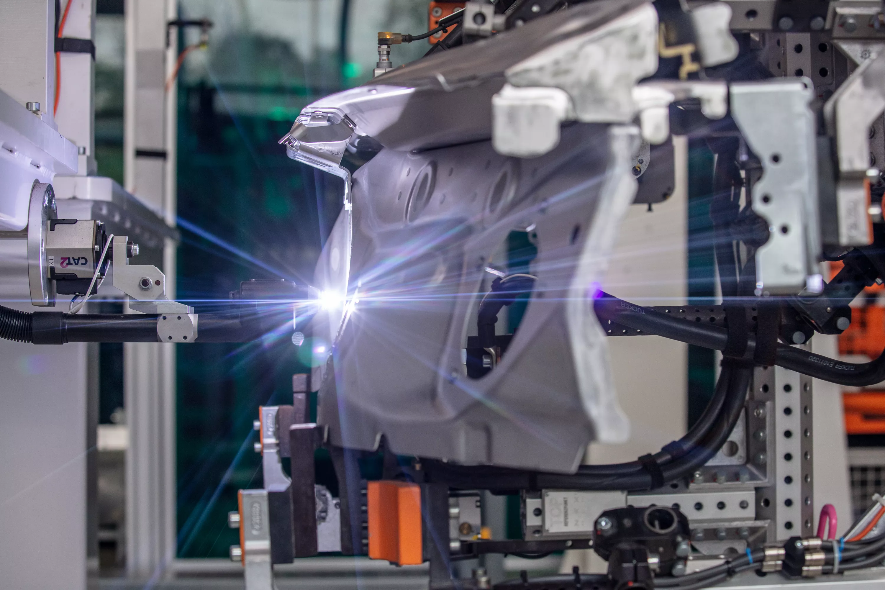

Treating surfaces with ACERIOS hot active plasma (HAP) technology from Fronius has many advantages. Using a stream of shielding gas, the arc plasma is formed into a flame with a core temperature of up to 1,000° Celsius. This triggers thermal and chemical processes which ensure that material surfaces are locally cleaned of organic residues and film impurities with pinpoint accuracy. At the same time, the surface is activated. With ACERIOS, the arc is created between the plasma nozzle and the tungsten electrode of the welding torch, which means that a ground earth connection to the workpiece is not required. As a result, non-metallic materials can also be cleaned with hot active plasma.
“As with all new technologies we decide to look at closely, we tested ACERIOS to determine its fitness for purpose, the welding variables, and possible parameter windows. Together with Fronius, we then quickly and selectively optimized the prototype for series use,” says Rudolph. “Our system planners and colleagues from production then set about identifying a favorable installation situation.”
The technicians responsible for the A8 line finally decided to use ACERIOS in a robot cell that had enough free downtime to clean two areas measuring 12 cm² each. “This meant the available time was even sufficient to increase the ACERIOS burning duration to six seconds per welding spot. As a result, the distance between the welding torch and the workpiece is 30 mm. And we can then lower the current to 120 A without any loss of cleaning effect,” adds Jürgen Kolbenschlag, welding expert from the A8 body shop.

Integration of the hot-active plasma technology was made easier by the fact that the planners were able to install the ACERIOS PCT 2000 plasma torch in a stationary position. A minimal working area within the robot’s radius of action was sufficient for this. “What is more, the power supply needs less than one square meter of floor space, so we were able to place it well outside the cell between existing power supply units,” reports Rudolph.
The robot’s previously unused downtimes are used to convey the bulkhead to the welding torch. Accessibility to the workpiece is also very good thanks to the narrow torch, so that the plasma flame operates exactly vertically and is optimally aligned with the surface. Nor is it necessary to move down lanes during the cleaning process: the cleaning effect, which starts from the inside outwards, covers the whole of the required surface within the burning duration.
