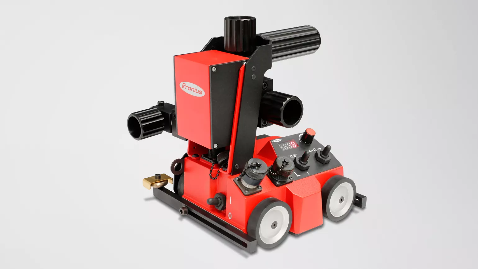

The battery-powered ArcRover 15 is a universal welding tractor for mechanised longitudinal seam welding. Its integrated permanent magnet ensures optimum adhesion and optimum traction for wheels. Can also be used vertically.

welding carriage ArcRover 15 - longitudinal seam welding
Welding tractor ArcRover 15, fillet weld, horizontal application
THE BENEFITS OF WELDING WITH ARCROVER 15.
  • Reduced height for even more welding applications
  • Optimal performance under harsh environmental conditions
  • Safe thanks to compliance with rules for welding interior container surfaces
  • Welding made easier with high-performance li-ion battery
  • Maximum traction on horizontal, vertical, concave and convex components
  • Constant welding speed in all positions up to 250 cm/min
  • Precision torch guidance on the component
  • Definable welding segments
  • Consistently high weld seam quality and reproducible welding parameters in conjunction with Fronius power source technology
  • Compact, robust and lightweight aluminium housing
  • Global service network
MORE FLEXIBILITY + MORE QUALITY = MORE COST EFFECTIVENESS = ARCROVER
Schweißfahrwerk ArcRover 15 vertical application
Welding tractor ArcRover 15, fillet weld, vertical application
EQUIPMENT.
  • 4-wheel drive, integrated permanent magnet
  • Integrated controller with backlit display
  • Path measuring system
  • Adjustable lateral guides for precise seam tracking
  • Robust universal welding torch holder for manual and machine welding torches
  • Power source connection cable (10 m)
  • Replaceable lithium-ion battery (25.4 V/3.35 Ah)
