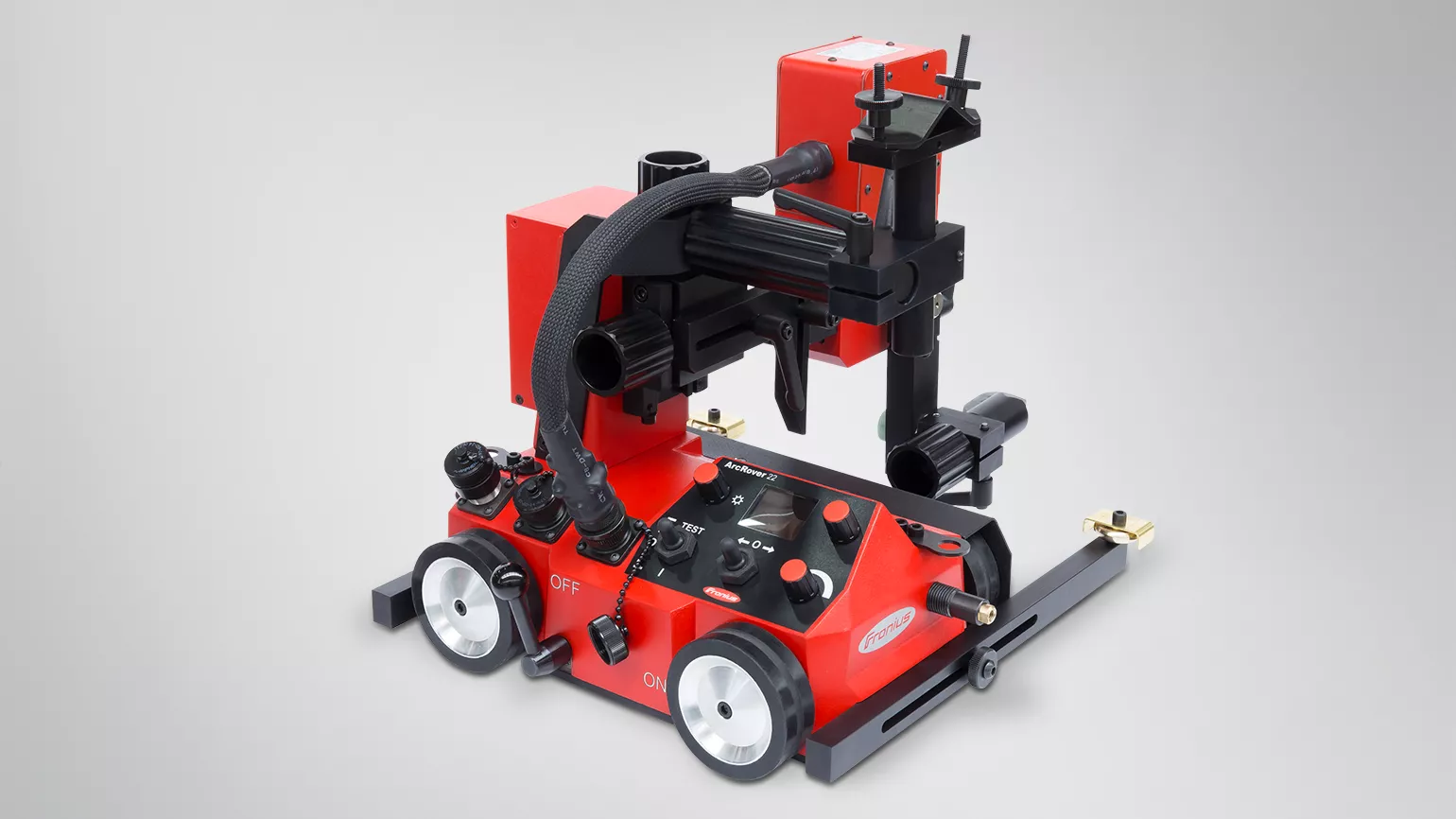

ArcRover 22
Welding carriage for mechanised longitudinal seam welding
WELDING PROCESS: MIG-MAG
The battery-powered ArcRover 22 is a universal welding tractor for mechanised longitudinal seam welding. Its integrated permanent magnet ensures optimum adhesion and optimum traction for wheels. Can also be used vertically.

THE BENEFITS OF WELDING WITH ARCROVER 22.
  • Optimal performance under harsh environmental conditions
  • Safe thanks to compliance with rules for welding interior container surfaces
  • Welding made easier with high-performance li-ion battery
  • Maximum traction on horizontal, vertical, concave and convex components
  • Constant welding speed in all positions up to 200 cm/min
  • Radial torch oscillation for fillet and butt welds
  • Definable welding segments
  • Consistently high weld seam quality and reproducible welding parameters in conjunction with Fronius power source technology
  • Compact, robust and lightweight aluminium housing
  • Global service network

STANDARD EQUIPMENT.
  • 4-wheel drive, integrated permanent magnet
  • Integrated controller with backlit display
  • Path measuring system
  • Adjustable lateral guides for precise seam tracking
  • Robust universal welding torch holder for manual and machine welding torches
  • Power source connection cable (10 m)
  • Replaceable lithium-ion battery (25.4 V/3.35 Ah)
FUNCTIONS.
  • Main switch: on/off
  • Left/stop/right
  • Speed control
  • Digital speed display
  • Welding on/off (2-step mode)
  • Start/stop power source (2-step mode)
  • Menu-based control system for travel path; segment welding, end-crater filling and OSC
  • Memory for 10 programs
RADIAL OSCILLATION (OPTIONAL).
  • OSC on/off/automatic
  • Dwell time left/right
  • Oscillation speed
  • Oscillation path
OPTIONS AND ACCESSORIES.
  • Lateral guides
  • Radial oscillation FOU 30/ML6
  • Motorized torch feeder FMS 50/100
  • Battery charging system (230 V)
  • Stainless steel wheels
  • Brushes
