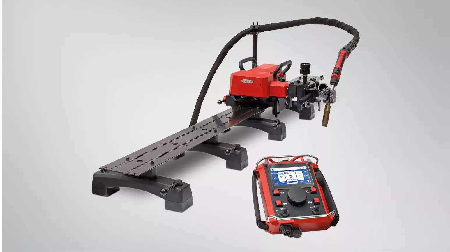

The compact welding tractor can be used in a wide range of applications. Depending on the requirements, one of three different rail types can be selected. FlexTrack 45 Pro welding tractors are perfect for all-round use in industries where surface geometries vary, such as in shipbuilding or container construction.
Contact
PRODUCT DETAILS
FlexTrack 45 Pro vertical application
Welding tractor FlexTrack 45 Pro, longitudinal seam welding - overhead application
FLEXTRACK 45 PRO STANDS FOR:
  • Flexibility for longitudinal seam and orbital applications
  • Fast production processes
  • Improvements in output quality
  • Reduced costs
  • Increased competitiveness
SYSTEM HIGHLIGHTS.
  • Flexibility: Modular rail concept for different welding applications on different component geometries
  • Comfort: Quick and easy set-up of rails and carriage
  • Precision: Precise movements and constant welding speed
  • Quality: Perfect reproducibility of welding results, particularly in conjunction with TPS/i power sources
  • Robustness: Compact cast aluminium housing, ideal for use under harsh conditions
MORE FLEXIBILITY + MORE QUALITY = MORE COST EFFECTIVENESS = FLEXTRACK

Flexible rail, mechanized welding
Flexible guide rail for FlexTrack 45 Pro
FLEXIBLE GUIDE RAILS.
  • Can be used on flat or curved surfaces with an internal radius of min. 1500 mm and an external radius of min. 1100 mm.
Rigid rail, mechanized welding
Rigid guide rail for FlexTrack 45 Pro
RIGID GUIDE RAILS.
  • Straight, rigid rails with aluminium profile for vertical or horizontal use.
magnetic bridge, FlexTrack 45 PRO
Magnetic bridge for FlexTrack 45 Pro
MAGNETIC BRIDGE.
  • For magnetic components. Heat-resistant to 180 °C.
  • The magnetic force is controlled by a lever.
vacuum bridge
Vacuum bridge for FlexTrack 45 Pro
VACUUM BRIDGES.
  • For non-magnetic components with smooth surfaces, such as aluminium or stainless steel.
  • Operating temperature of 0 to 120 °C (optional from -30 to 250 °C).
bridge with screwfeet
Bridge with adjustable foot for FlexTrack 45 Pro
BRIDGE WITH ADJUSTABLE FOOT.
  • Recommended for rigid rings up to 840 mm in diameter.
Vacuum pump, Fronius
Vacuum pump for FlexTrack 45 Pro
VACUUM PUMP.
  • In the case of non-magnetic materials, vacuum bridges are used to attach the guide rail. These require a suitable vacuum pump.
  • Pump is integrated into robust steel tubing frame, suction power for maximum 13 vacuum bridges, suction power can be regulated with stop valves.
STANDARD EQUIPMENT.
  • Dry-running, oil-free, rotary vane vacuum pump
  • Portable base frame
  • Direct-on-line starter
  • Suction filter
  • Pressure manometer
  • Mains cable with plug, 5 m
