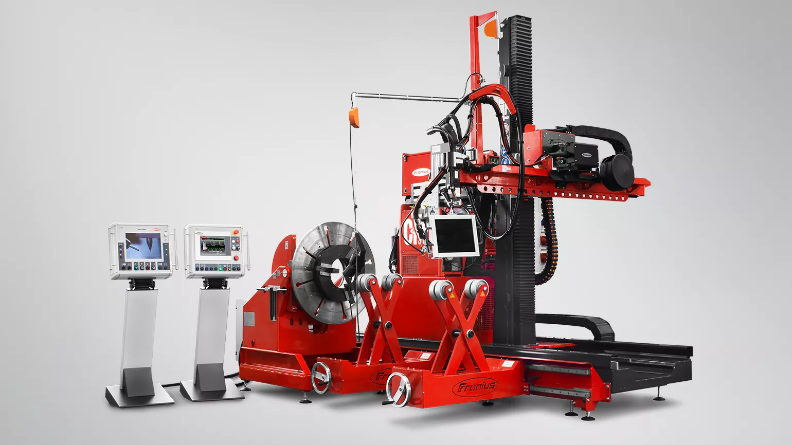

FMW Multi Welding System
Mechanised Multi Welding
WELDING PROCESSES: MIG-MAG / CMT / TIG COLD WIRE / TIG HOT WIRE
The Fronius Multi Welding System makes combining all welding applications into a single system possible. Different welding processes are also available for individual uses and new processes can be added as required. The Fronius Multi Welding System is the first choice in sectors where different components (pipes, flanges, reducers, fittings, valves, etc.) and different metal alloys play a significant role, such as the food, plant construction and energy industries.

Fronius mechanized Multi Welding System FMW
QUICK CHANGE OF WELDING PROCESS THANKS TO FMW.
The Fronius Multi Welding System enables the welding process to be changed in no time. Equipped with quick-release catches, the welding torches can be changed in seconds. The intuitive HMI opens up entirely new possibilities and saves time. It has never been so easy to develop customer-specific process control and program the welding process.
FEATURES.
  • Human Machine Interface - system controller
  • Multi welding processes - max. eight different welding processes
  • Variety of automatic welding torches - up to three different welding torches with the same hosepack
  • Circumferential weld, longitudinal seam and both combined in multi welding axes
  • Ten different axes that can be controlled via HMI and remote control
  • Modular, expandable welding system concept
  • Q-Master quality management software
  • ArcView camera system
