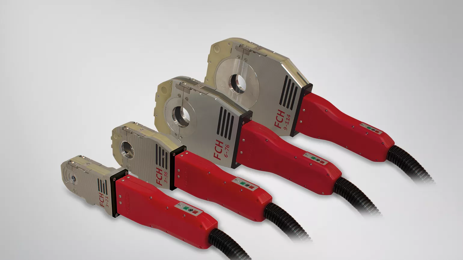

FCH 3-21 / 3-38 / 6-76 / 9-114 welding heads
Mechanised orbital welding
WELDING PROCESS: TIG
Closed welding heads for the mechanised TIG orbital welding of thin-walled pipe joints (external diameter 3 - 114 mm, wall thickness up to 3.5 mm) made of stainless steel, titanium, nickel-based alloys, aluminium and other materials without the use of filler wire.
Contact
PRODUCT DETAILS
FCH weld head
FCH welding head with component
SPOT-ON VERSATILITY.
  • FCH welding head with 8 m hosepack
  • High duty cycle due to effective water cooling
  • Integrated servo motor
  • Automatic movement to the opening position
  • Freely definable start position
  • Automatic switch-off of the motor current in the event of overloading

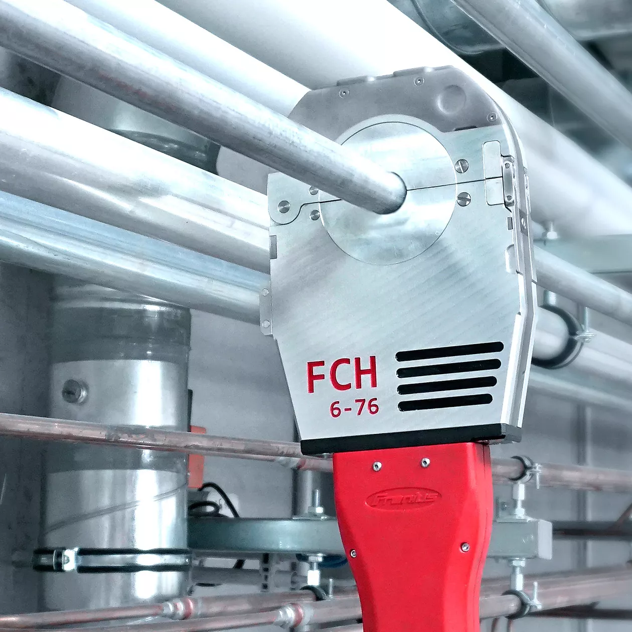

  • Compact design – optimum accessibility in confined areas
  • Best possible gas shield and low level of temper colouration
  • Clamping system for secure fixation and centring on the component
  • Quick changeover system for clamping shells
  • Highly user-friendly thanks to control buttons integrated in the handle
  • Transport case with trolley function

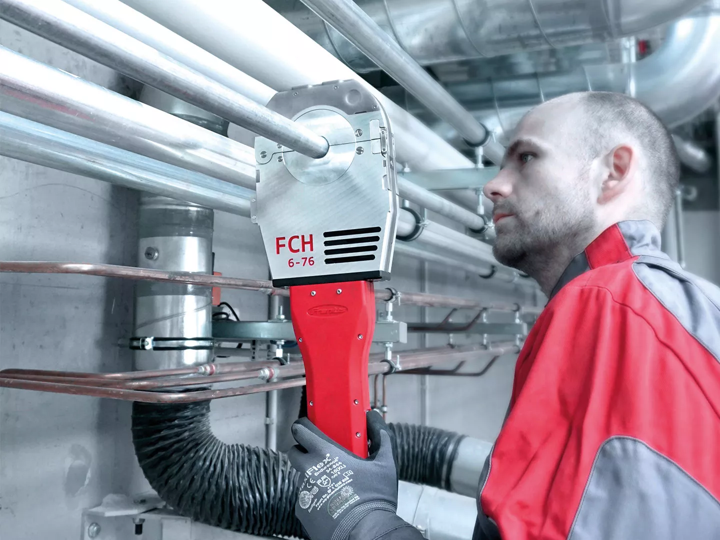

mechanized TIG orbital welding, Fronius, FCH
Pipe welding with closed welding head
