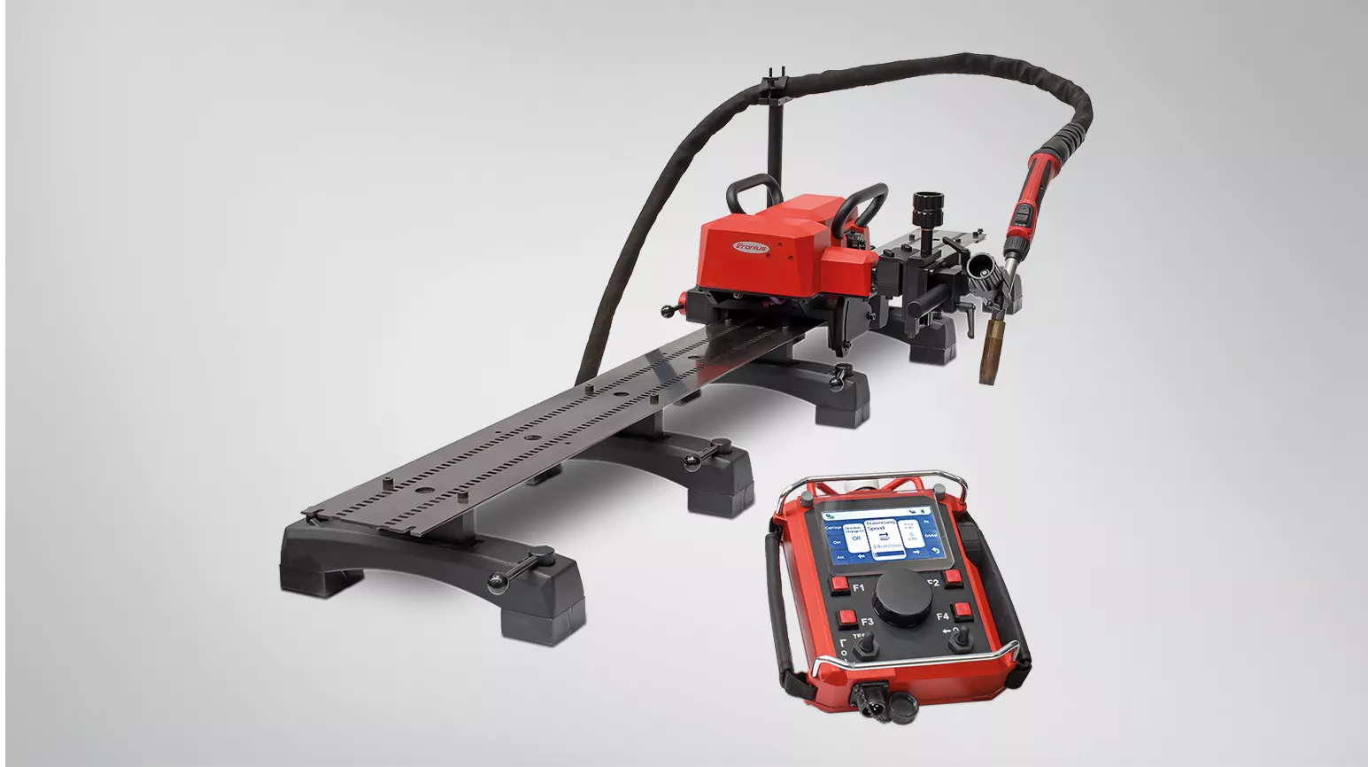

FlexTrack 45 Pro
Rail guided welding carriage for mechanised orbital welding
WELDING PROCESSES: MIG-MAG / CMT
The compact welding tractor can be used in a wide range of applications. Depending on the requirements, one of three different rail types can be selected. FlexTrack 45 Pro welding tractors are perfect for all-round use in industries where surface geometries vary, for example in shipbuilding or container construction.
Contact
FlexTrack 45 Pro orbital welding
Welding tractor FlexTrack 45 Pro, oribital welding
FLEXTRACK 45 PRO STANDS FOR:
  • Flexibility for orbital and longitudinal seam applications
  • Fast production processes
  • Improvements in output quality
  • Reduced costsIncreased competitiveness
SYSTEM HIGHLIGHTS.
  • Flexibility: Modular rail concept for different welding applications on different component geometries
  • Comfort: Quick and easy set-up of rails and carriage
  • Precision: Precise movements and constant welding speed
  • Quality: Perfect reproducibility of welding results, particularly in conjunction with TPS/i power sources
  • Robustness: Compact cast aluminium housing, ideal for use under harsh conditions
MORE FLEXIBILITY + MORE QUALITY = MORE COST EFFECTIVENESS = FLEXTRACK
