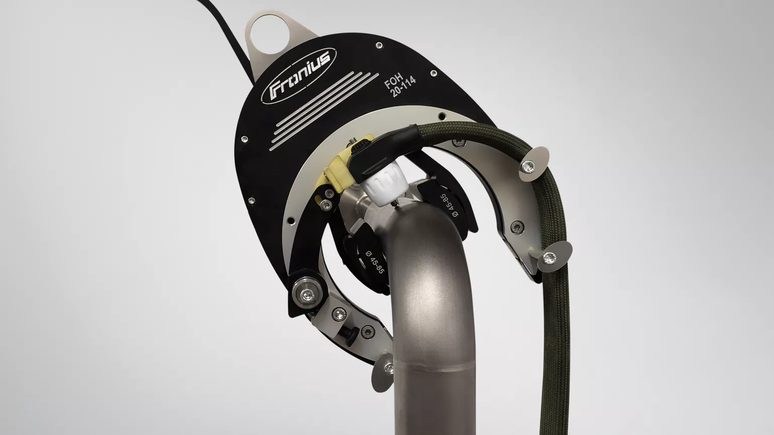

FOH 8-40 / 10-76 / 20-114 / 40-168 welding heads
Mechanised orbital welding
WELDING PROCESS: TIG
Open welding heads for the mechanised TIG orbital welding of pipe joints (external diameter 8 - 168 mm) made of steel, stainless steel, titanium, nickel-based alloys, aluminium and other materials with and without the use of filler wire.
Contact
PRODUCT DETAILS
open orbital weldhead FOH 20-114 with filler wire
Open welding head with component
SPOT-ON VERSATILITY.
  • FOH welding head with up to two sets of reducing jaws, depending on the type of welding head
  • Integrated servo motor
  • Automatic movement to the opening position
  • Freely definable start position
  • Automatic switch-off of the motor current in the event of overloading
  • Continuously adjustable clamping/centring system for quick adjustment to the tube diameter
  • Mechanical tube tracking for constant electrode distance
  • Torch mounting 0 - 45°, continuously adjustable
  • Manual lateral correction of the electrode
  • Swivelling torch holder with fixing
  • Plug-in control line (6 m)
  • Orbital welding torch with insulated torch body and high duty cycle
  • Best possible gas shield and low level of temper colouration
  • Welding torch with simple wearing part replacement system
  • Transport case with trolley function
