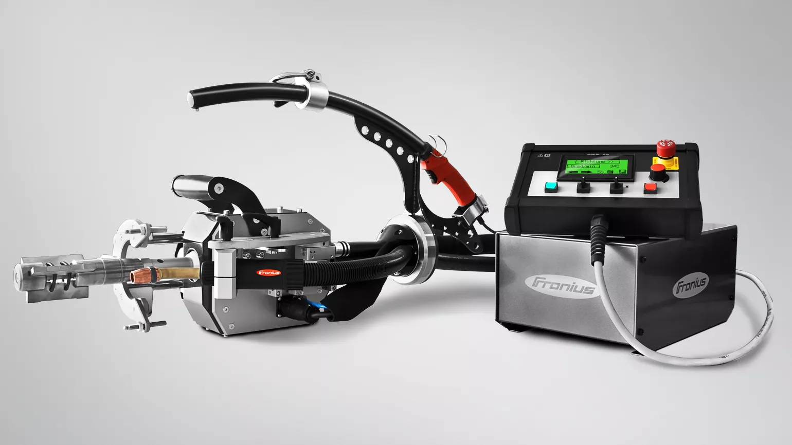

The FTW PRO is ideal for applications where factors such as time saving, optimal quality and exact repeatability are paramount. For pipe-to-pipe-plate joints in heat exchangers or heat sinks, these criteria are essential. The pneumatic clamping system or the suspension device greatly simplify the work process for the user and reduce the time required. The three-point support ensures exact positioning of the welding torch, even with varying tube protrusions.

FEATURES.
Compact, ergonomic design
Increases productivity while maintaining optimum quality and reproducibility
Time-saving, simple positioning
User-friendly operation
Pneumatic clamping system
Variety of mandrels and clamping jaws for different pipe inside diameters
Precise adjustment units for user-dependent torch adjustment
Special welding torch with Multilock quick-connect system and water cooling
Hanging devices (optional) for different applications
Practical handle to quickly start welding programs
Three-point support (optional)
