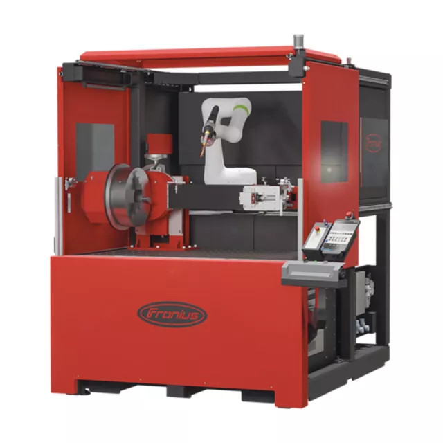

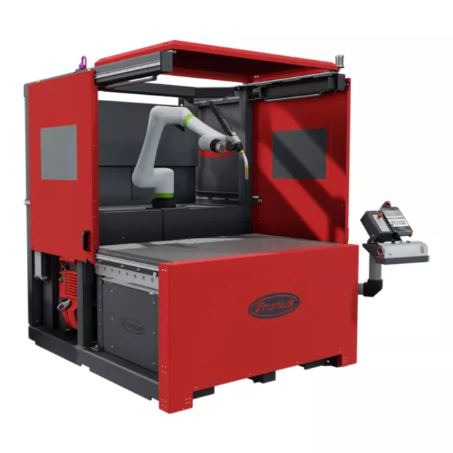

Cobot equipment
Welding equipment
Welding systems
- TPS 320i
- TPS 400i
High-tech Welding Packages
- Standard, Pulse
- PMC (Pulse Multi Control)
- LSC (Low Spatter Control)
- ,CMT (Cold Metal Transfer)
1
Welding table
- 1500 x 1000 mm
- D28 bores with 100 x 100 mm grid
- Clamping set  (optional)
2
Protective cabin
 - CE-tested
- Glare protection raises/lowers automatically
- Manual sliding doors left/right
- Can be fitted with fume extraction system
3
Cobot (Fanuc CRX-10iA)
- 6 axes
- Force torque sensors protect operator and components against collisions
- Grip plate mounted on the welding torch with teach buttons
4
Control - Intuitive operation and programming with tablet
5
1
Welding equipment
Welding systems
- TPS 320i
- TPS 400i
- Standard, Pulse
2
Welding table
- 1500 x 1000 mm
3
Protective cabin
 - CE-tested
4
- 6 axes
5
Control
Rotary unit (optional)
- Motorized rotary unit
- Can be pivoted via hand crank
- Face plates Ø 450 mm
- Hollow shafts Ø 120 mm
1
- 6 axes
2
Tailstock (optional)
- Mounted on the linear unit
- Electro-pneumatic infeed
- Distance between centers 860 mm
3
4
1
2
- 6 axes
3
4
Control
