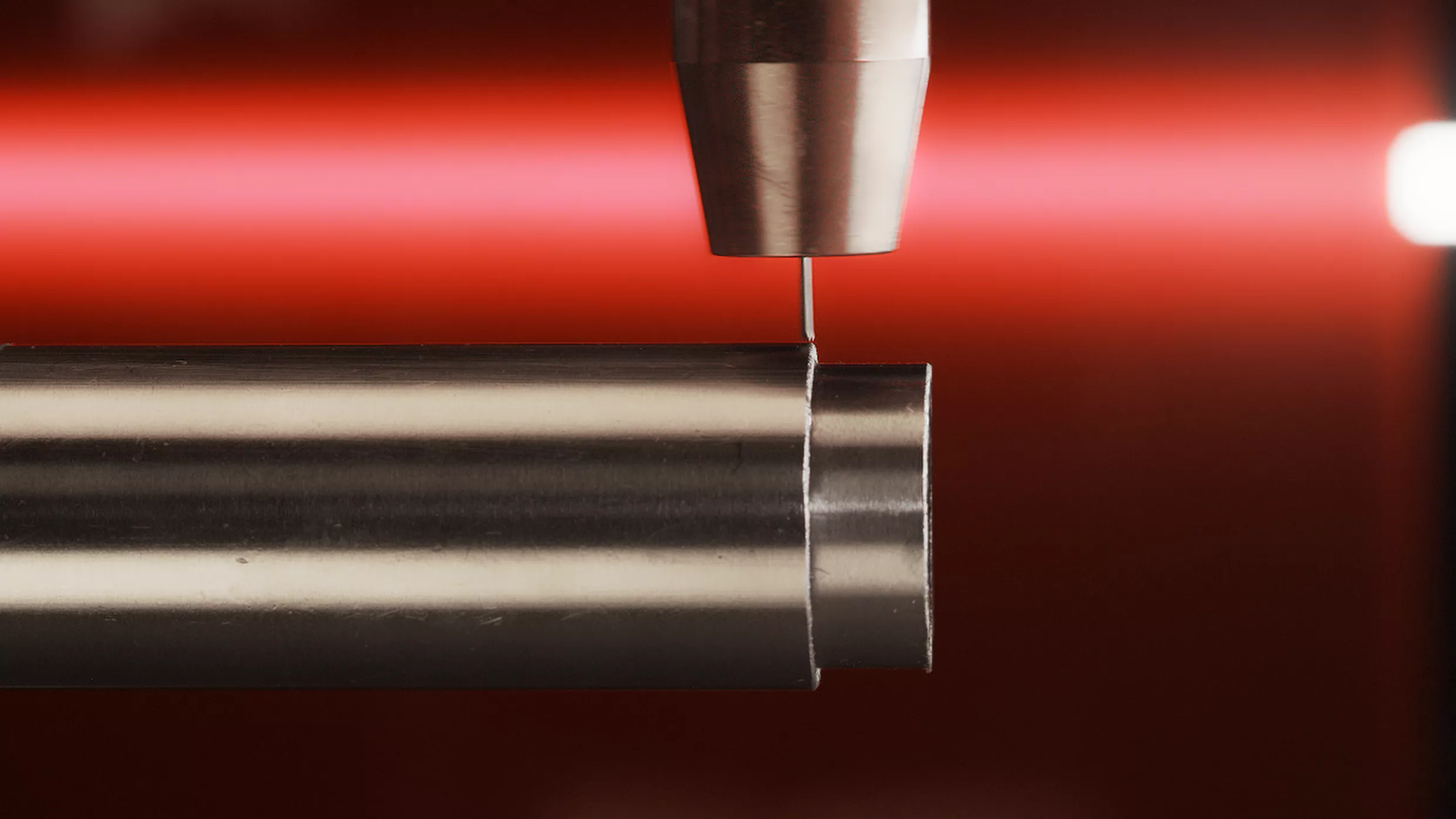

Detect edge positions and air gap heights with WireSense
The patented WireSense technology works together with the welding system to enable the robot to detect the edge position and any air gaps between the sheets. To do so, the wire electrode becomes a height sensor. During the WireSense scanning process, the robot first makes its way to the required position. The welding wire, to which a low sensor voltage is supplied, scans the component with reversing wire movements in the range of one hundred Hertz. If the wire touches the component, it results in an imperceptible short circuit. The short circuit is then cleared by raising the wire.
The TPS/i power source analyses the change in the position of the welding wire at the instant of the short circuit and makes it available to the robot as a height signal. Together with the positional data from the robot controller and a reference point defined at the outset, WireSense allows each geometrical change on the component to be registered with precision. If the robot and WireSense were to be moved over the workpiece along an infinite series of sequential paths, recording every point in the process, it would theoretically be possible to construct the complete 3D component contour.

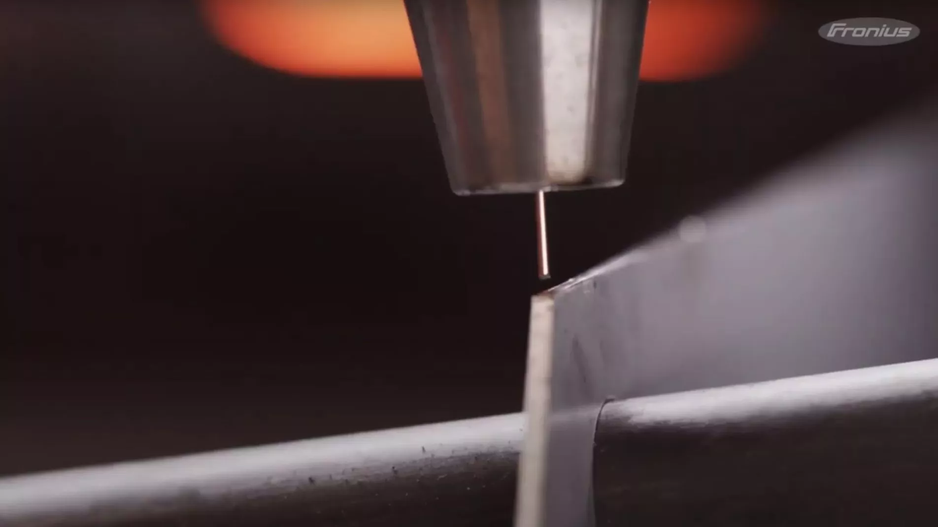

In practice, the most important applications of this sensor system are edge and height detection, such as for lap joints. A defined threshold, which lies somewhat below the sheet edge height, is determined in advance. Should the power source detect values that lie above this threshold during the WireSense scanning process, this indicates that the edge of the sheet has been detected and the TPS/i immediately outputs a digital touch signal and the determined height value. As a result, the robot knows where the edge of the sheet is and how high it is.
Edge detection: correcting the robot path
The robot controller can use this signal to save its current positional data and then correct the robot path by comparing it with the target data. Any component inaccuracies are thus recognized and compensated for. The robot then welds in exactly the right location. Edge detection is already possible for material thicknesses of 0.5 mm and above and sheet thicknesses of up to 20 mm.
Height measurement: reliable welding despite air gap
As the precisely measured sheet edge height is also transmitted with the digital touch signal, WireSense enables any air gaps between the sheets to be calculated. Assuming they have been specified in advance, the various welding programs – or jobs – stored in the TPS/i can be called up as required for the various air gaps. As a result, the robot can respond appropriately and weld with the welding parameters that are ideal for the air gap dimension in question.
Thus WireSense helps with tolerance fluctuations in the components for welding and also counters tolerances in the clamping technology. The assistance system ensures reliable seam quality and reduced rework and component rejects by up to 100 percent – without any additional sensor hardware. To achieve this, the Fronius welding system simply needs to be equipped with a CMT-ready system, to ensure high-precision control of the welding wire.

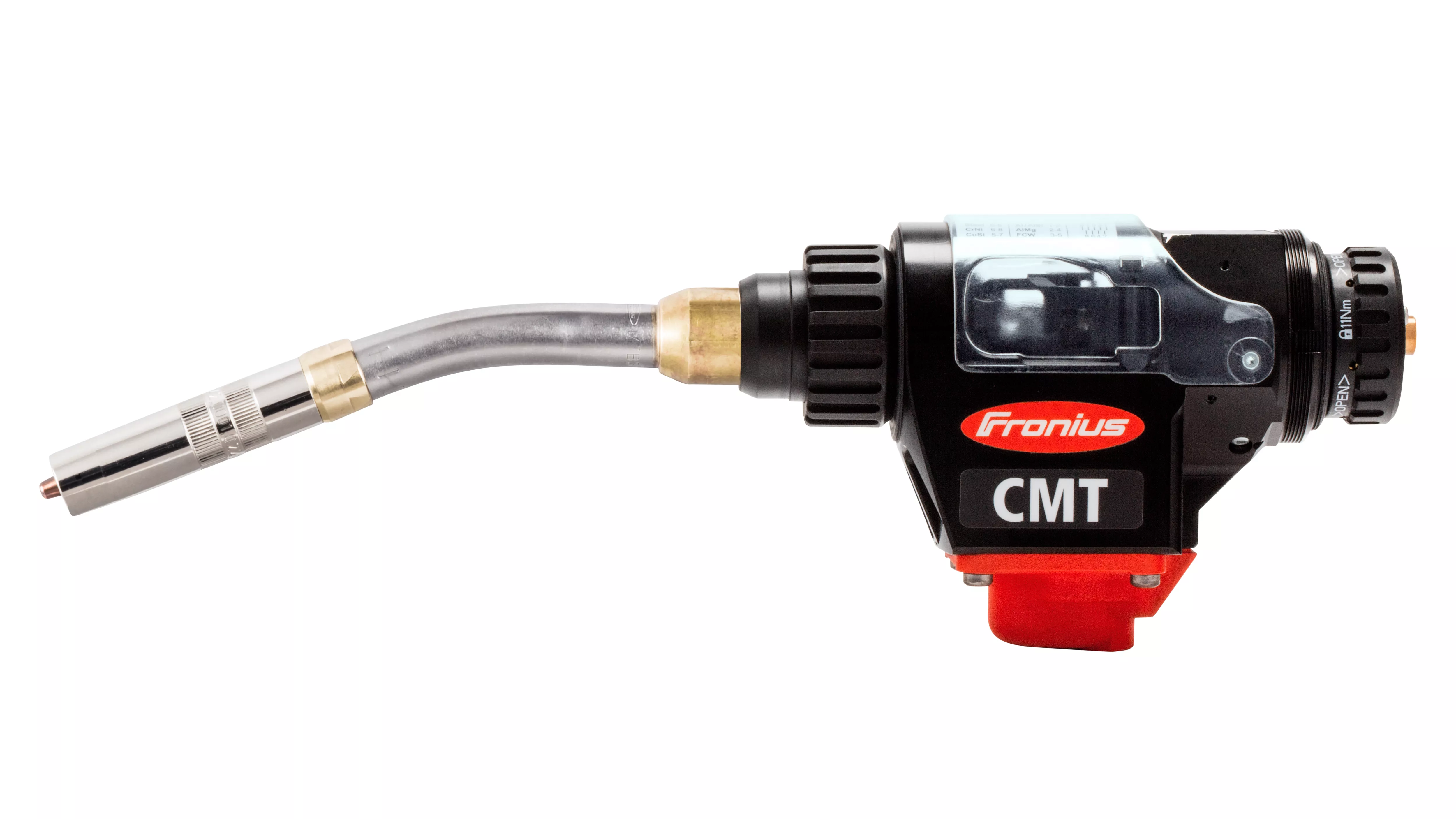

Quick robot programming with TeachMode
The robot path must be manually programmed before welding can begin – this is called the teach process. It involves the welder or programmer using a teach pendant to control the robot, scan the component, and save the positional data. In terms of the quality of the weld seam, it is important that a constant distance is maintained between the component and the contact tip across the entire weld seam – this is called the stick out. Assistance systems can also help with this time-consuming, manual process.
TeachMode from Fronius uses a reversing wire movement to prevent the welding wire from being bent when scanning the component. The reversing wire movement begins as soon as the pre-set stick out is undershot by the robot. At the same time, a visual/audible signal informs the user that they must move the welding torch away from the component. This saves the user from having to remove the deformed wire or re-measure the stick out, and speeds up the teach process by up to 30 percent.
