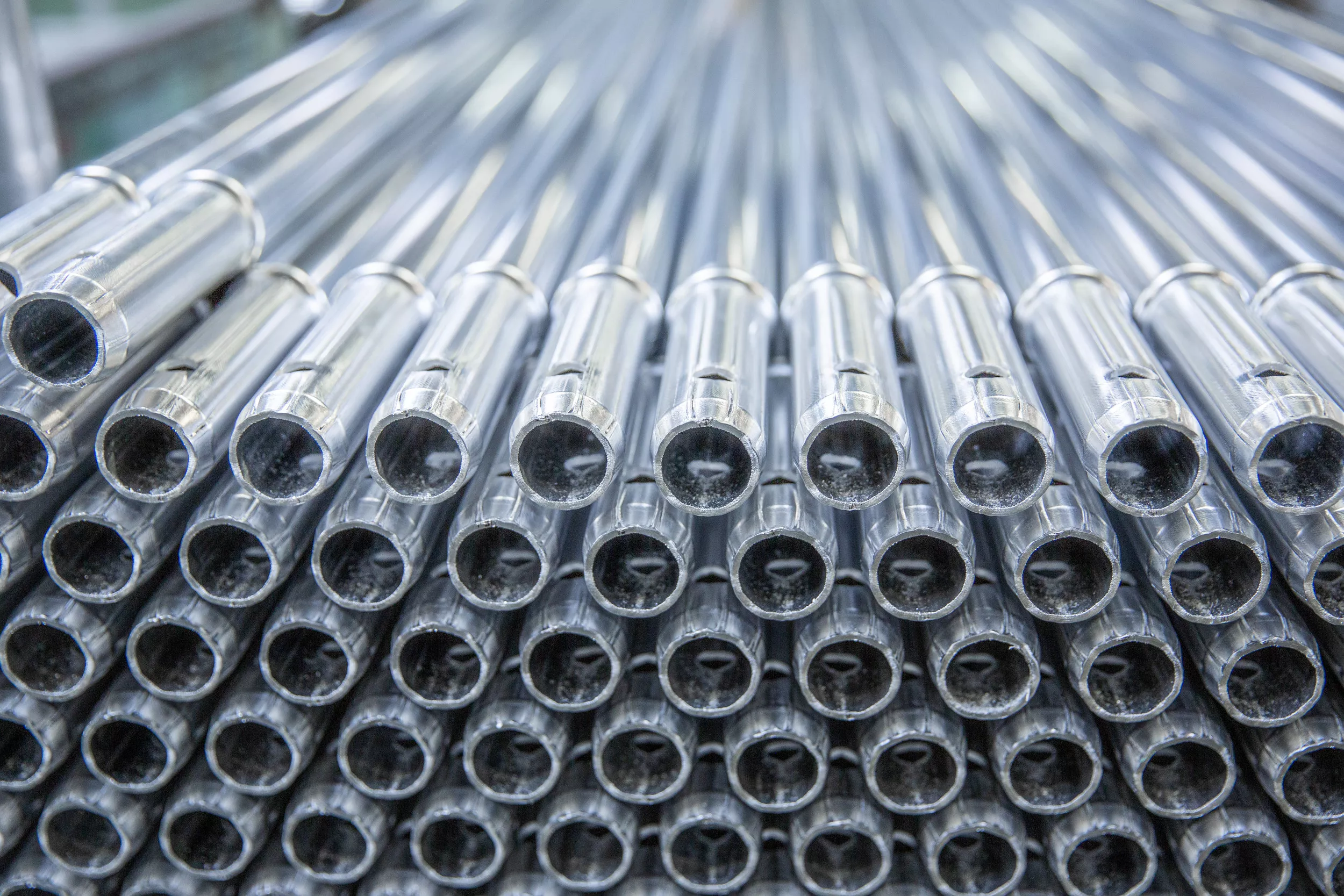

Certified welding company with the latest technology
Up to 95 percent of the metal processed and welded on ALTEC’s production lines is aluminium. Steel applications account for just five percent. Yet as a specialist welding company with EN 1090-1 and 1090-3 certification, ALTEC and its 50 employees can master even the most complex orders thanks to 35 years of experience in welding aluminium components. In order to be able to meet its customers’ demands, ALTEC has always relied on pioneering process and manufacturing technology, despite its relatively modest size. “This includes state-of-the-art CAD workstations as well as fully automated robotic welding cells and the associated high-tech welding process technology,” explains Siegfried Berenz, a certified master metalworker and international welding specialist (IWS). Having spent the past 15 years being primarily active in the fields of aluminium welding and processing, he took over as plant manager of ALTEC in 2019.
