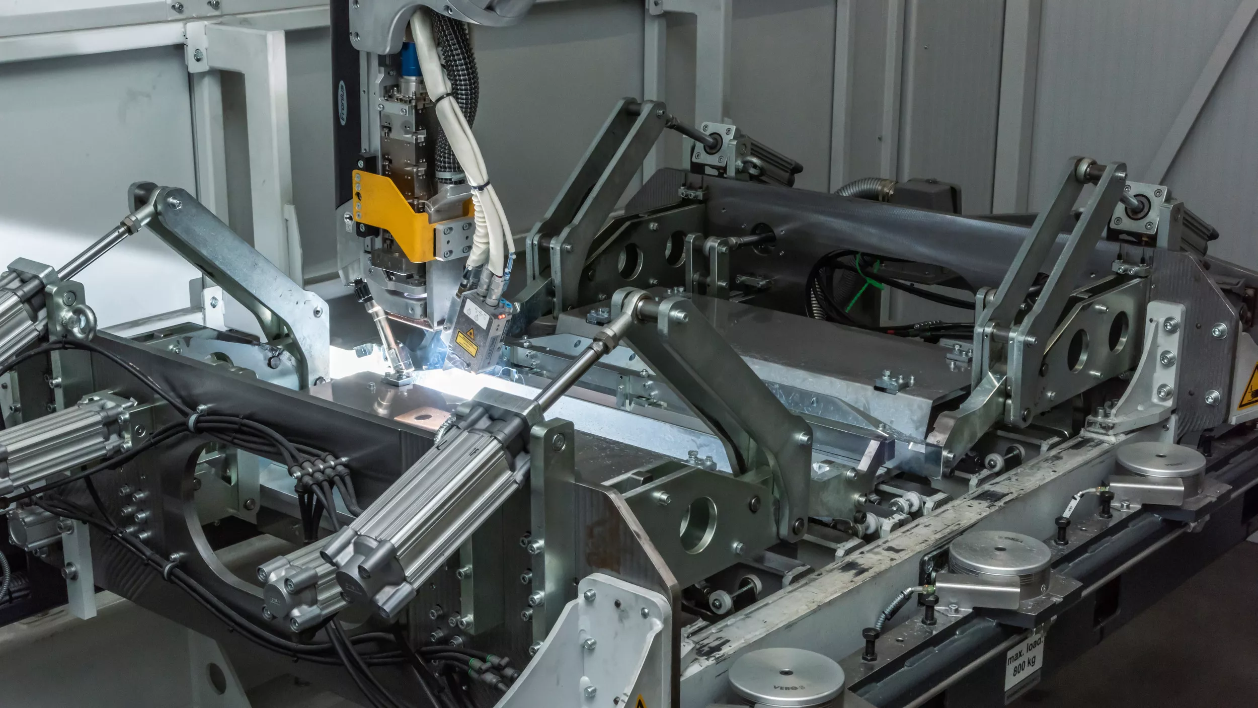

Premium welding technology for prototype construction

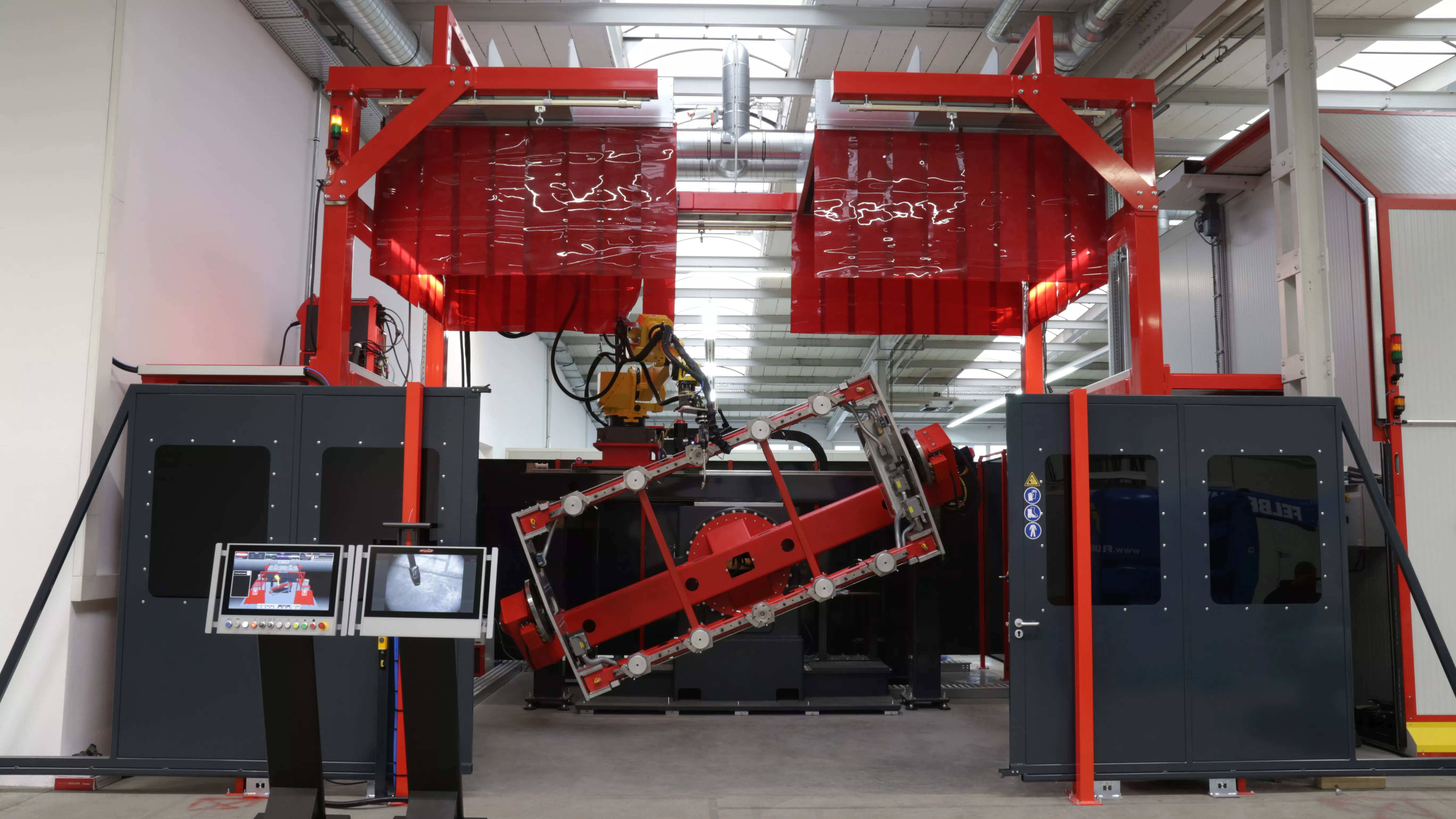

Covering more than 900 square meters, the prototyping center provides sophisticated simulation, welding, and measuring technology. This makes it possible to manufacture components measuring up to 3x2 meters and weighing up to 1,500 kilograms. The facilities are sealed off from other areas and guarantee absolute discretion.
One of the two robot welding cells used is equipped with Fronius CMT technology. The heat-reduced welding process is suitable for almost any parent material, especially light-gage sheet metal, and reduces spattering and distortion. The flexible TPS/i welding system platform used for this purpose also allows other welding processes to be employed if required. In addition, the robot cell uses an Acerios surface cleaning system that pre-treats the edges of the components using hot plasma technology. This creates the perfect conditions for high-quality welding seams.
The second robot welding cell features both a laser and a powerful GMAW welding system. In conjunction, the LaserHybrid process combines the advantages of both worlds and thus offers excellent gap-bridging ability and high welding speeds. Deep penetration and low heat input – and thus minimal component distortion – also go hand in hand here.
Sensor technology, measurement, and data documentation
Both welding cells are equipped with sophisticated robot assistance and control systems:
  • A laser monitoring system mounted on the welding torch ensures that the robot welds in exactly the right location. In case of misalignment, distortion, or tolerances that are common in production, the robot can automatically correct the pre-programmed weld seam path and welding is performed reliably at the correct position.
  • Fronius SeamTracking provides another option: This function reliably detects the component edge through welding torch pendulum movements for fillet and prepared butt welds.
  • In addition, the ArcView camera system provides a direct view of the arc, enabling the welding process to be monitored precisely. If necessary, the welder can immediately take corrective action.
  • What’s more, an automated weld seam inspection system scans the seam after the welding process and immediately performs a visual quality inspection.
  • At the same time, the WeldCube data documentation software monitors and stores all relevant data from the welding process and enables clear traceability of each seam.
In addition to highly developed welding processes and the monitoring of these processes, the component is measured three-dimensionally in a dedicated robot cell before and after welding, which allows any deviations such as tolerances or distortion to be accurately detected. This precise monitoring of the exact dimensions thus takes place from an early stage in the prototype construction, enabling a quick response and adjustment of various parameters (e.g., welding sequence, welding parameters, and clamping technology) and saving time and costs both during development and in the subsequent production ramp-up. Fronius also offers its customers the option of subjecting the prototypes to metallurgical testing in the laboratory.
