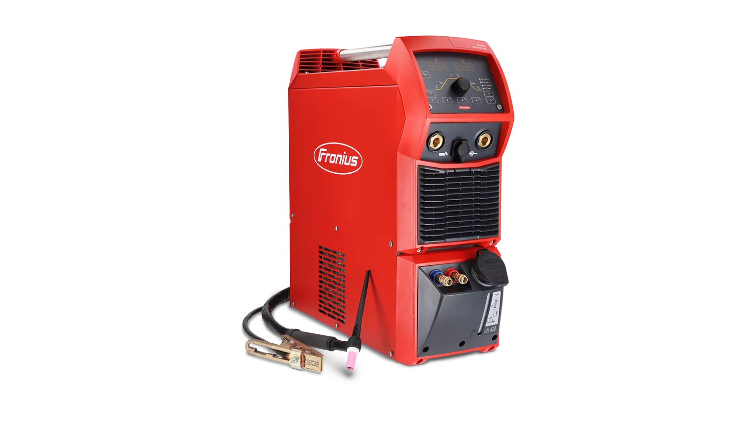

Artis 300 XT – economical and powerful A true all-rounder: the Artis Extended version is designed for mains voltages from 200 to 600 V and can therefore be used worldwide. Depending on the power category and mains fuse protection, up to 300 A is possible in single-phase operation. – Available for gas- or water-cooled variants – Can be used worldwide – Fully generator-compatible – Optimised welding performance thanks to higher output characteristic curve – CEL-compatible

| Welding current min. | 3 A |
| Welding current max. | 300 A |
| Operating voltage min. | 10,1 V |
| Operating voltage maximum | 22 V |
| Open-circuit voltage | 61 V |
| Dimension / length | 558 mm |
| Dimension / width | 210 mm |
| Dimension / height | 561 mm |
| Weight | 25,6 kg |
| Interference emission class | A |
| Mains fuse | 16 A |
| Welding current waveform | DC |
| Mains voltage tolerance minus | 10 % |
| Mains voltage tolerance plus | 10 % |
| Energy efficiency | 89 % |
| Welding current / Duty cycle [10min/40°C] | 300 A / 40 % |
| Welding current / Duty cycle [10min/40°C] | 260 A / 60 % |
| Welding current / Duty cycle [10min/40°C] | 230 A / 100 % |
| Mains voltage | 575 V |
| Maximum working voltage | 31,3 V |
| Energy consumption in idle mode | 17,6 W |

| Artis 170 | Artis 210 | Artis 300 | |
| TAC function | x | x | x |
| TIG Pulse | x | x | x |
| Touch HF ignition | x | x | x |
| TIG Comfort Stop | x | x | x |
| Spot and stitch welding | x | x | x |
| MMA and Cel welding | x | x | x |
| MMA Pulse | x | x | x |
| Anti-stick function | x | x | x |
| HotStart function | x | x | x |
| TrackingArc | x | x | x |
| Generator-compatible | x | x | x |
| Adjustable time shutdown/standby mode | x | x | x |
| XT version | x | x | x |
| Extended XT functionality | - | - | x |
