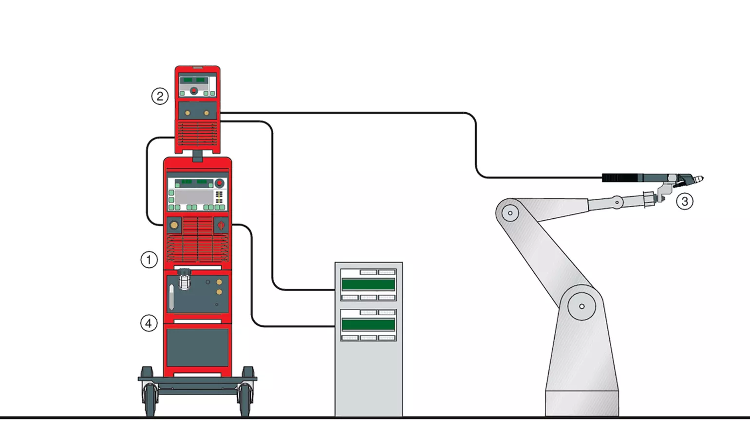

The system – keeping the focus on the big picture
At Fronius, every welding process is looked upon as a system, right from the outset. This is the only way of ensuring that all the components (each of them of top quality, of course) are compatible and work in perfect harmony. The plasma welding system comprises four main components: a digital TIG power source with a cooling unit, the PlasmaModule 10 and a plasma torch. The exact system configuration can be tailored to individual requirements.

System components
1. MagicWave/TransTig 2200/2500/3000
2. PlasmaModule 10
3. Robacta PTW 1500
4. FK 2500 FC cooling unit

 System components
1. MagicWave/TransTig 4000/5000
2. PlasmaModule 10
3. Robacta PTW
4. FK 9000-R cooling unit
