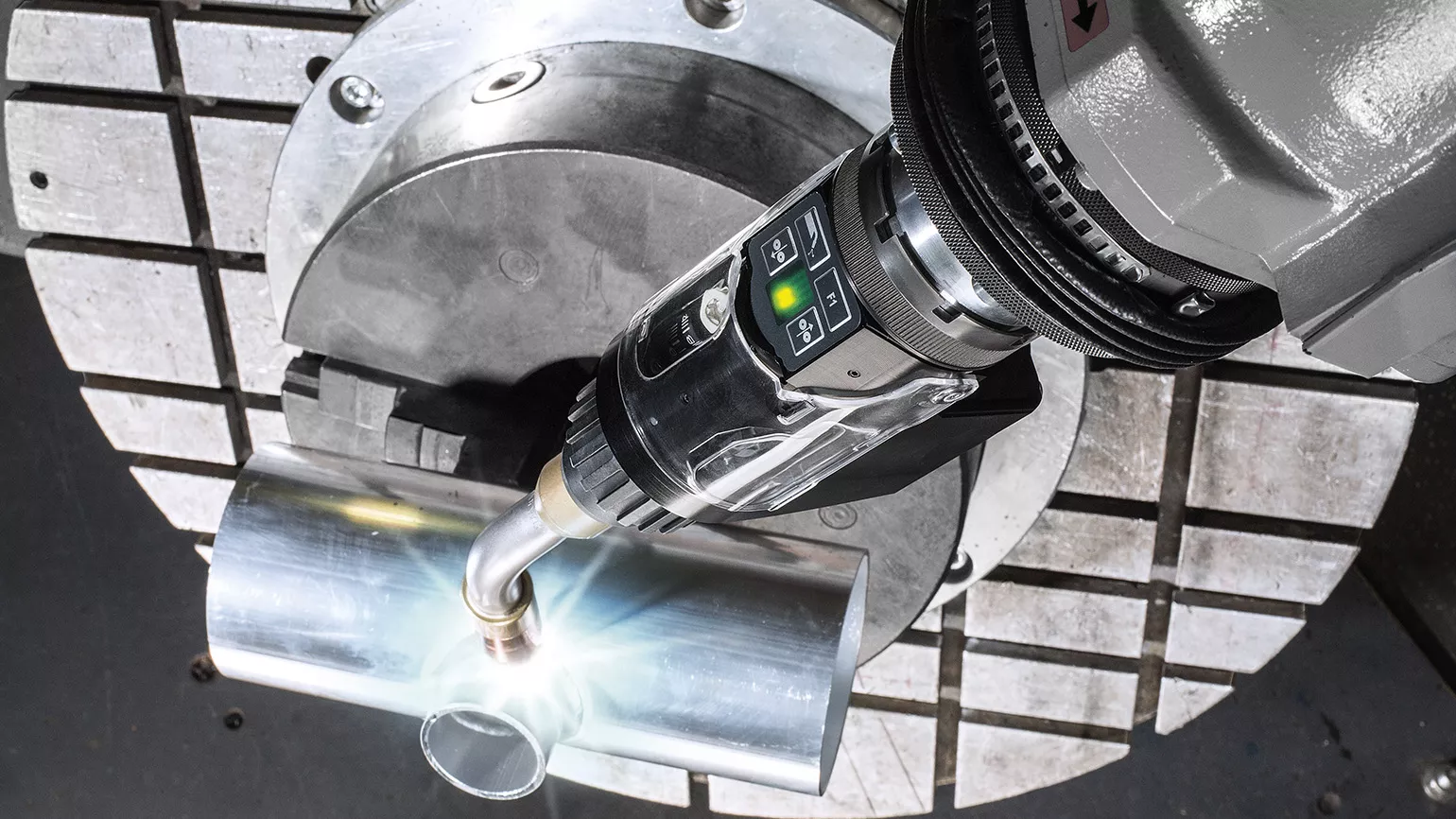

The PowerDrive system is an alternative to the PushPull system. It only uses one wirefeeder, namely the WF 25i RD, which is placed at the very end of the robot arm and ensures reliable and constant wirefeeding. This dynamic wirefeeding feature enables the PMC Mix Drive process to be used, which makes its mark in aluminium applications in particular.

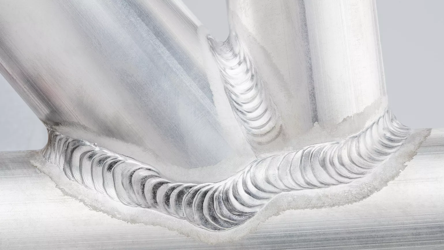

Application: Bicycle frame
Process: PMC Mix Drive
The focus here lies on the interplay between the optimal weld seam appearance and welding speed while maintaining consistent quality.

WF 25i Robacta Drive
The WF 25i RD impresses with its compact size. It can be integrated into both conventional and PAP robot systems. The newly developed CrashBox provides optimum protection for the hardware. Considerable savings can be made here in terms of costs and time, particularly during the commissioning phase in series production processes.

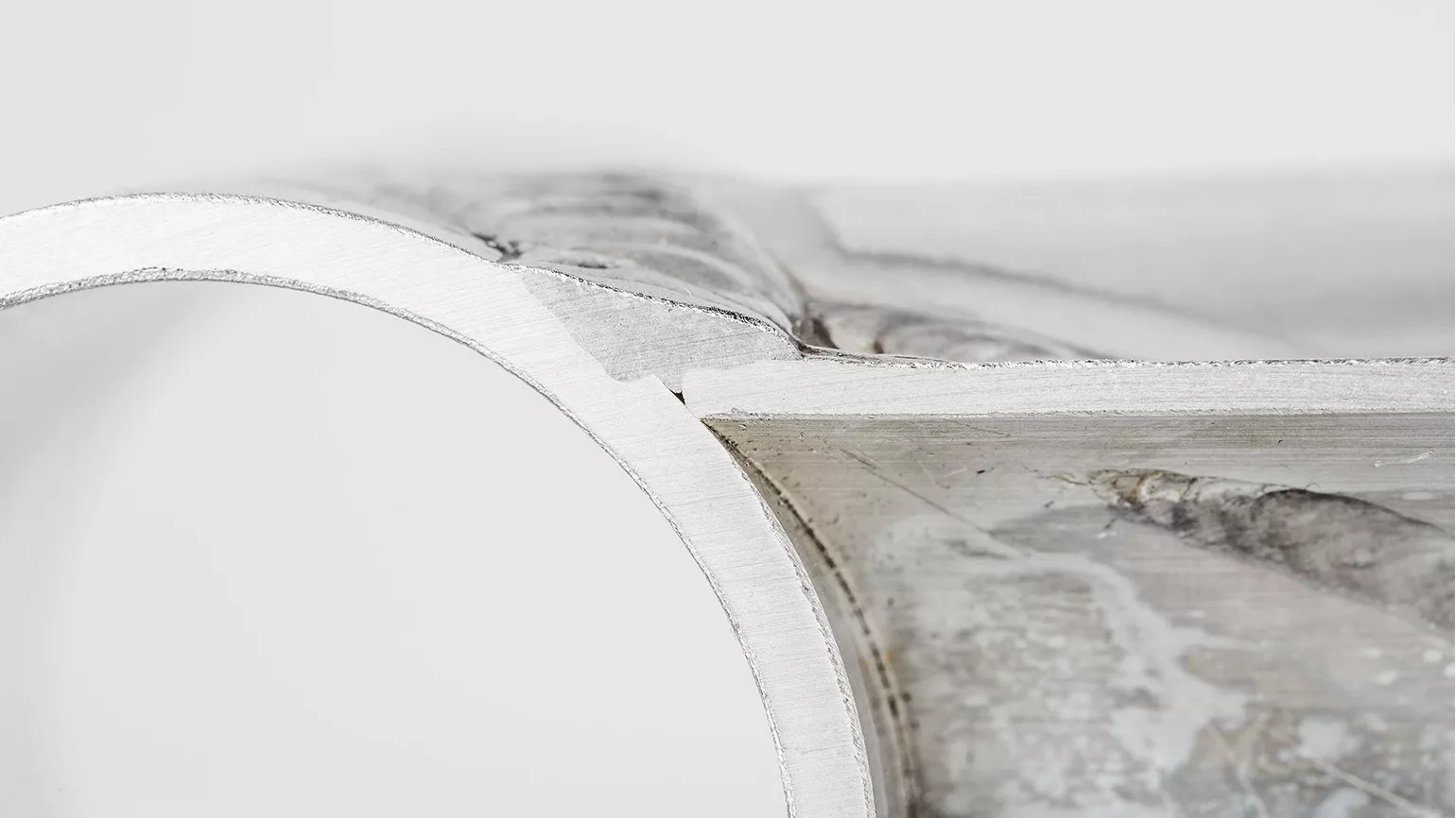

Welding parameters
Base material  AlMg3
Material thickness 1.5 - 3 mm
Filler metal AlSi5 O: 1.2 mm
Gas 100% Ar
Vs 30 cm/min
Vd 5 m/min
Amperage 115 A
Voltage 18 V
