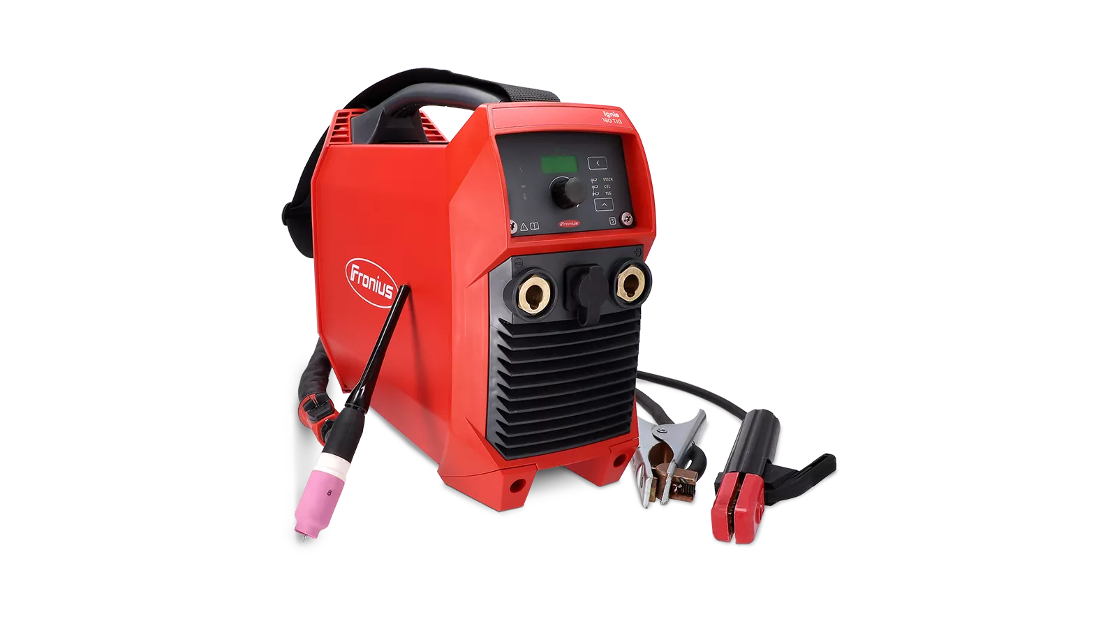

Ignis TIG
Product details
TECHNICAL DATA
GENERAL DATA
Welding current min.10 A
Welding current max.180 A
Operating voltage min.20,4 V
Open-circuit voltage101 V
Protection classIP23
Dimension / l
1,43 ft
Dimension / b
6,3 in
Dimension / h
1,02 ft
Weight20,28 lbs
Contact
Want to find out more about this product?
Find out more about the features of the Ignis welding machine.
Current firmware and software updates for the Ignis.
Function overview
Functions
Ignis 180 XT Ignis 180 TIG XT
 HotStart x x
 SoftStart x x
 Anti-stick x x
 MMA Pulse x x
 TAC tacking function
x
 TIG Comfort Stop x x
 TIG Pulse
x
 TIG Multi Connector
x
 TIG welding torch operation
x
 Remote control operation
x
 Time shutdown
(300 s/900 s/off)
x x
 TrackingArc x x
 XT variant x x
