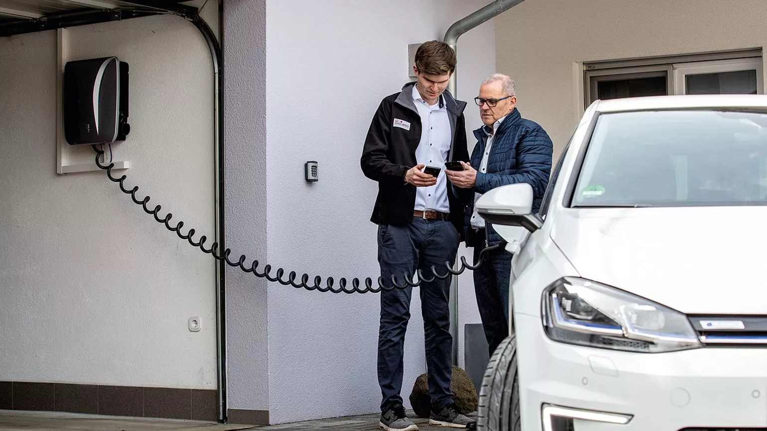

PV + storage system + electric car: how does it work?
The ideal setup is one in which your electric car is charged directly from your own PV system. If there is still surplus solar energy after this, which may well be the case with larger systems, it can be stored in the battery. Your system will be preconfigured for this to happen, however the settings can be changed to suit your requirements, say if you wanted to charge your car on Sundays at 3 pm.
You can also charge your electric car from your storage system. So, when you get home from work in the evening, you can hook up your car to the system to charge it with solar energy that was produced during the day and has been temporarily stored in the battery.
