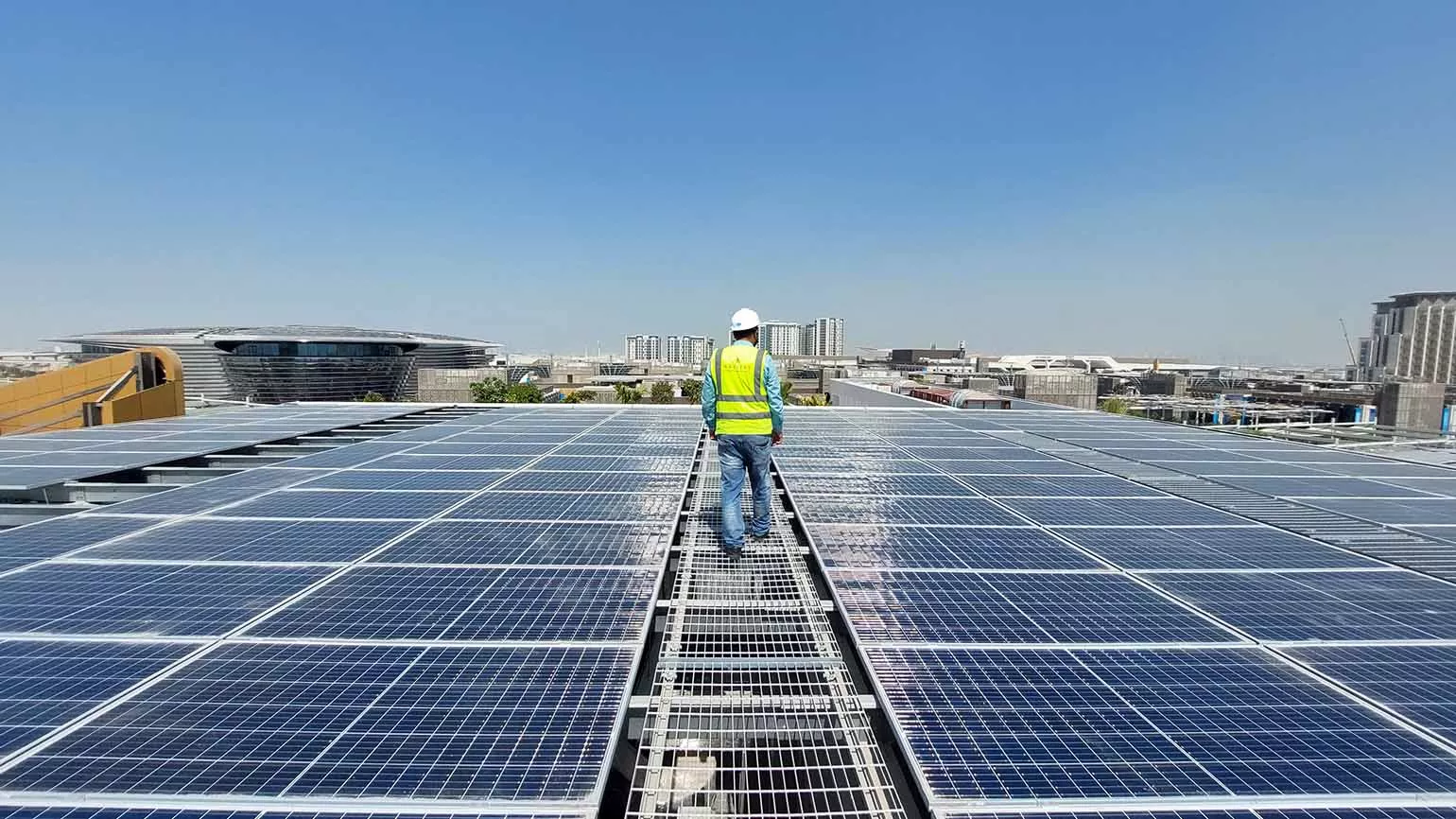

In 2020, the Kingdom of Belgium took the decision to install a 33 kW rooftop, extending it to the final 52.45 kW during the construction phase due to aesthetics.

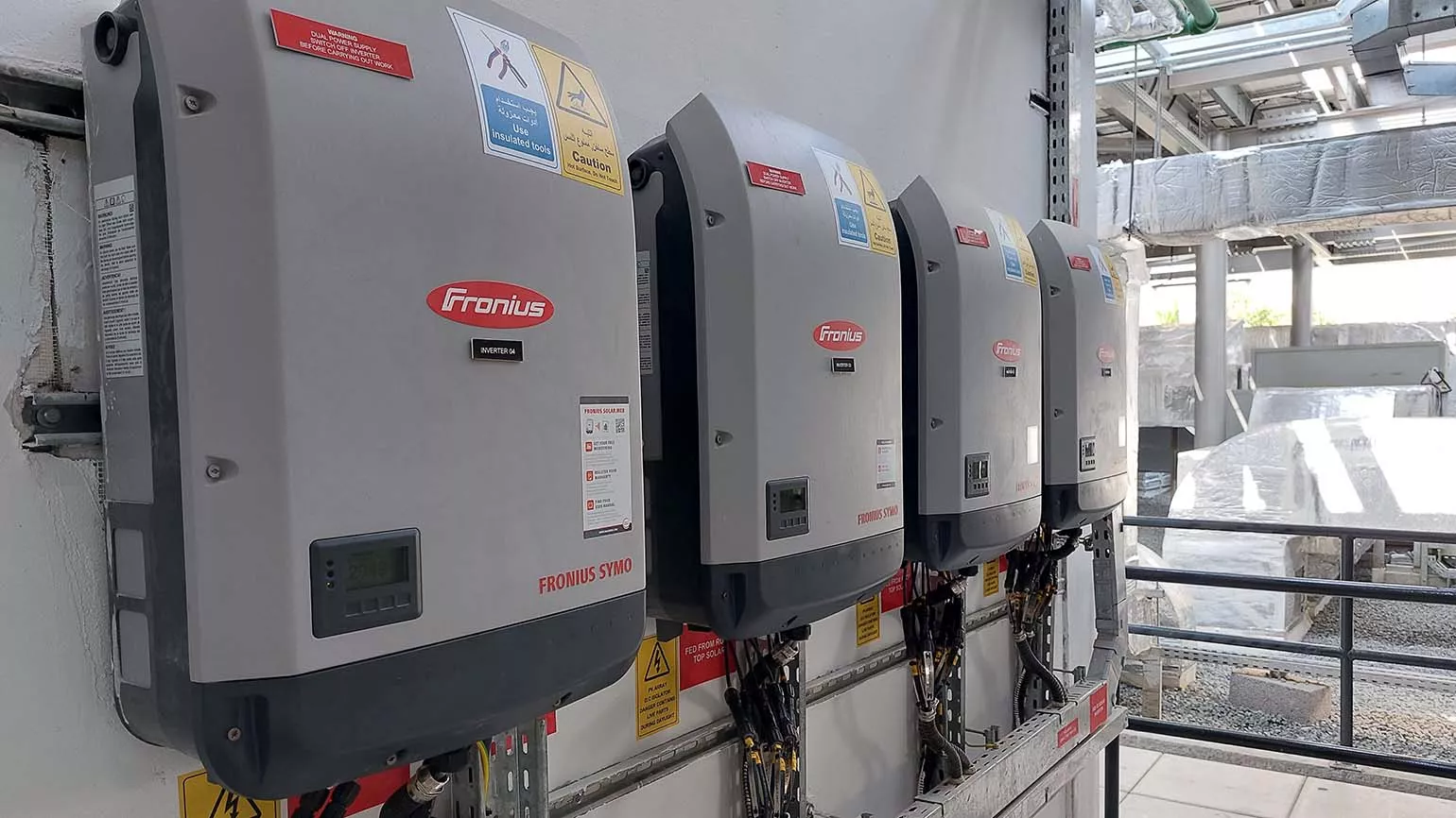

Why was Fronius Symo the inverter of choice?
Navitas as a Fronius System Partner has been working closely with Fronius in sales, so they are experienced with the product and appreciate the brand for its easy handling and quality.
When approached by a premium customer like The Kingdom of Belgium, they knew Fronius Symo was going to be the perfect for them, as it is an inverter with better temperature derating; efficiency and production. Being Fronius in the end, the first choice of customer.

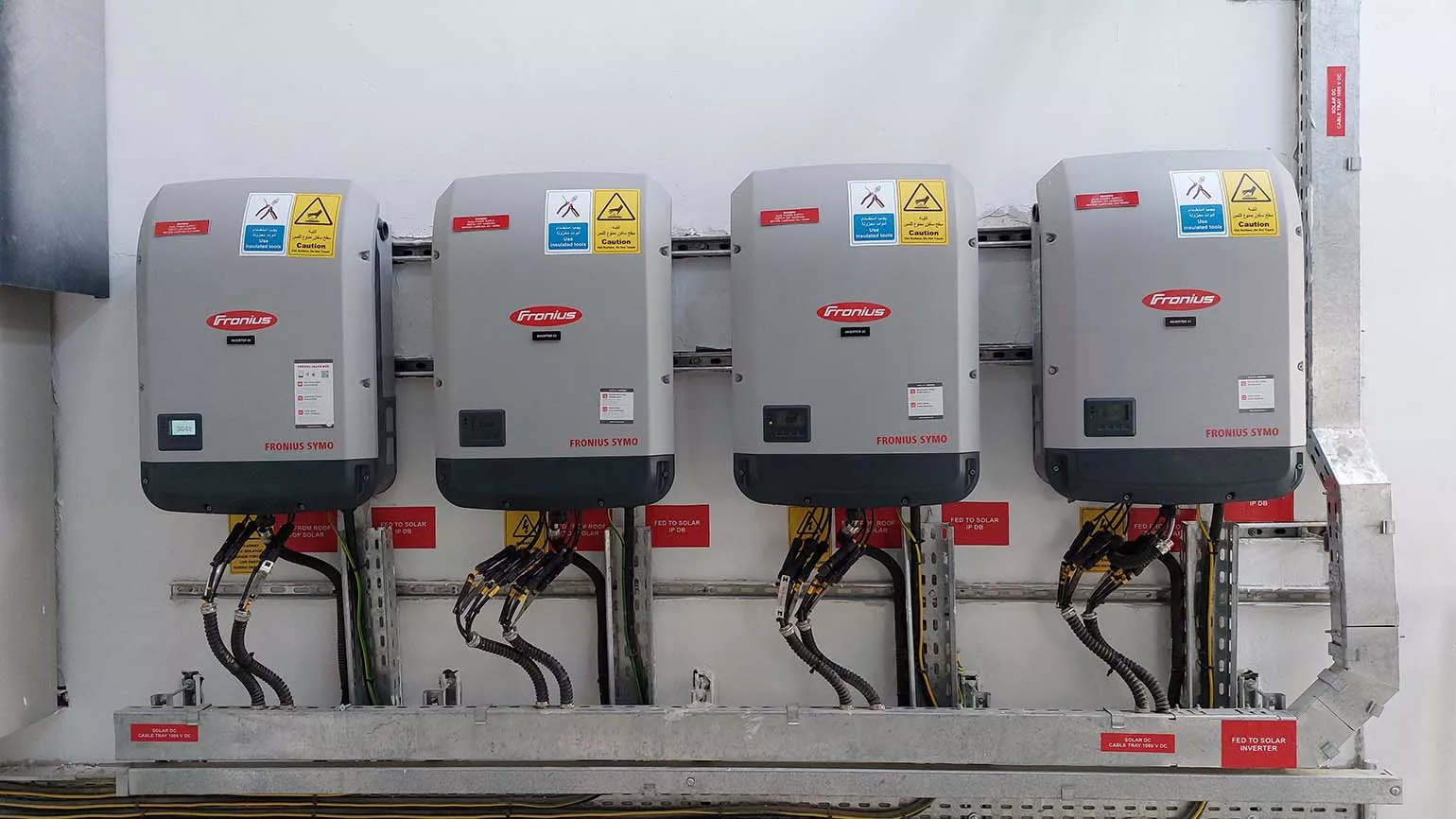

Technical Details of the Installation:
Location: Belgium Expo Pavilion at the Dubai Expo 2020
Size of installation: 52.45 kWp
Inverters used: 4x Fronius Symo 12.5 kW
Annual Production: 33.000 mWh
Module type & surface:   Canadian Solar 360 and 350 W
Self-sufficiency rate:  10%
Installer:  Navitas Solar Energy System Contracting LLC

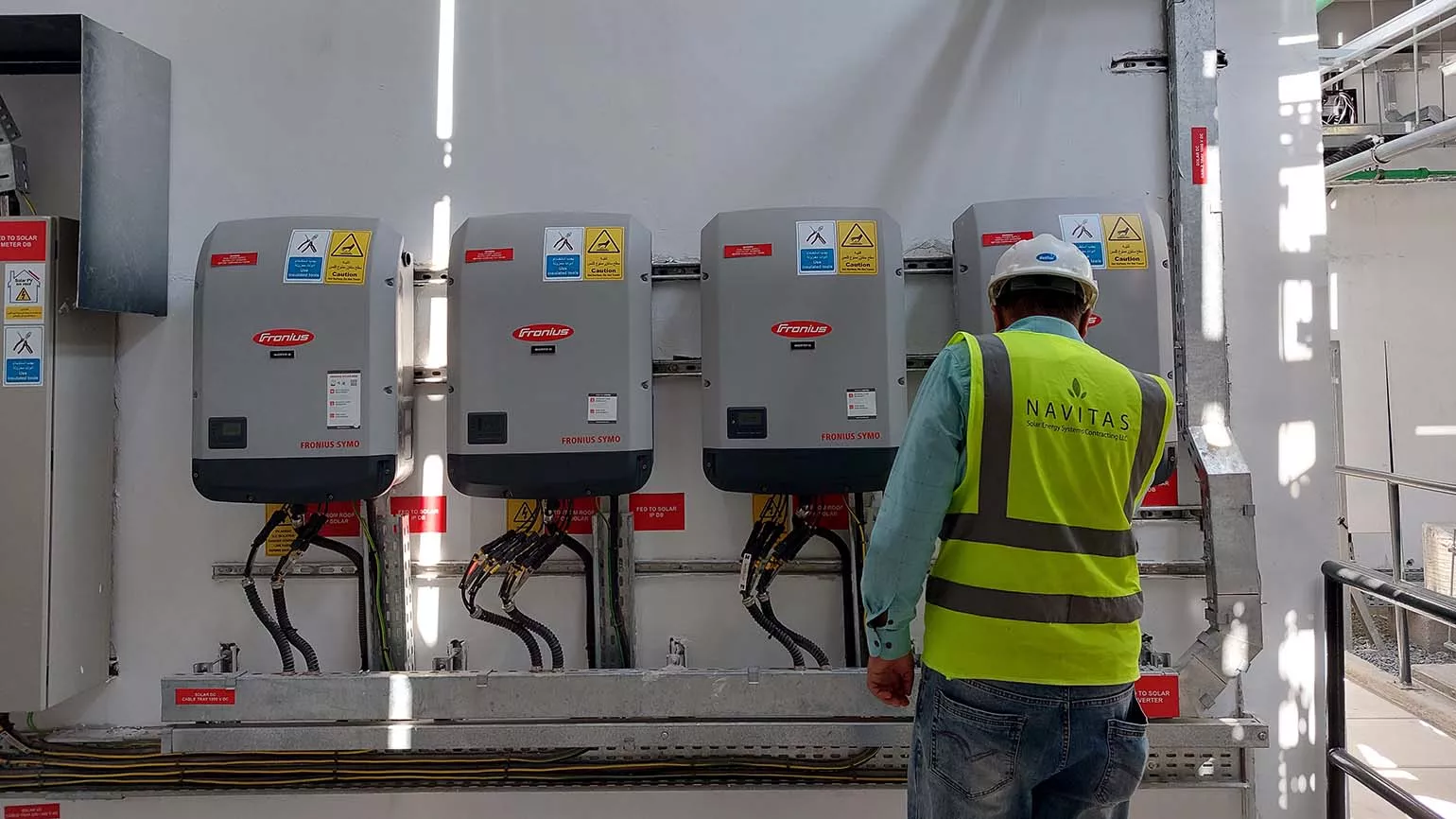

Factory-trained installation and service
Along with the Fronius Middle East team, a network of Fronius System Partners (FSP) is the backbone of a strong service across all Middle Eastern countries. As a Fronius System Partner in Dubai, Navitas is a factory-trained Fronius installer. Customers benefit from the latest know-how in installation and system design, but they also receive the best service through all stages of the lifetime of their PV system.
A big factor for sustainable, longlasting and economic PV systems are their repairability. With Fronius installers being able to perform individual part exchanges instead of having to order and wait for a whole new inverter to arrive, quick servicing and cost reduction for both installers and system owners are ensured
