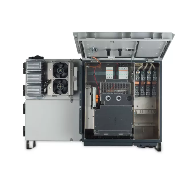

Robustly designed for long service life
Direct sunlight and high temperatures are no problem for the robust Fronius Tauro. On the contrary: the robust project inverter was specially developed to deliver unrestricted full power even under the harshest environmental conditions.
- Power electronics protected by active cooling
- Double-walled housing ensures optimum temperature compensation
- Stable high performance even at ambient temperatures of up to 50 °C
Extremely cost-effective
Fast installation and fast service: Fronius Tauro is quick to install and efficient to maintain. If necessary, only the affected power stage set needs to be replaced on site rather than the entire project inverter, thereby saving time and conserving resources.
- Quick installation and efficient maintenance
- Power stage set replacement (27 kg) is easily accomplished by one person
- Efficient handling of service cases and targeted online support with Fronius Solar.SOS

Technical data
| Technical data | Fronius Tauro | Fronius Tauro ECO | |
| Power categories | 50 kW | 50, 99,99, 100 kW | |
| MPP tracker(s) | 3 | 1 | |
| MPPT voltage range | 400 - 870 VDC | 580 - 930 VDC | |
| Max. DC voltage | 1.000 V | ||
| Cooling system | Active cooling & double-wall system | ||
| Degree of protection | IP 65 | ||
| Installation type | Indoor and outdoor
installation,
vertical or horizontal |
