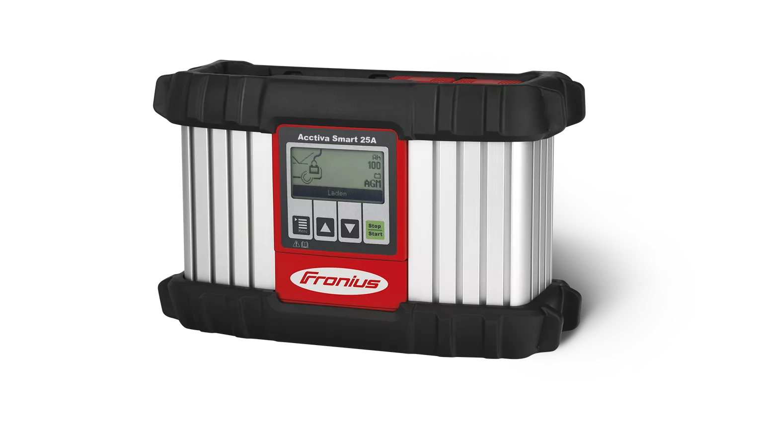

The Acctiva Smart 25A professional battery charging system from Fronius is suitable for all batteries (STD, CA, AGM, EFB, Start/Stop, GEL) and applications in the professional 6, 12 and 24V DC range and is ideal for use with motorcycles, cars, HGVs, emergency vehicles, buses, agricultural vehicles and construction machinery.
The charger is characterized by easy handling in mobile use and a large graphic display with animated application steps for easy operation. A special Li-ion characteristic (software update available in 2020), a special refresh mode for deeply discharged batteries and the software update capability via an optional USB interface make this charger indispensable in your workshop.
The professional battery charging system for all workshop requirements
A handle ensures extremely easy use in portable applications and a special Li-ion characteristic (software update available in 2020) allows Li-ion batteries to be charged.
The battery charging system impresses with its large graphic display with animated steps for straightforward operation, a special Refresh mode for deep-discharge batteries and the ability to update the software using an optional USB interface.
