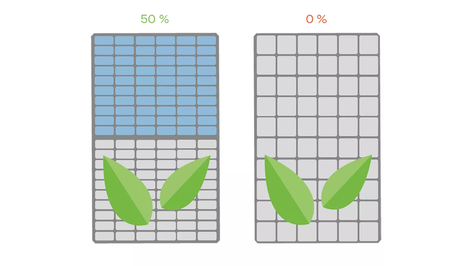

Ongoing advancements in solar modules are also helping make home rooftop PV systems even more efficient. Half-cell technology, which splits individual solar cells into two, means conventional solar modules can not only reduce power loss but also improve light utilization as well as ensuring stable functioning even at high temperatures.
Shading behavior is also improved with half-cell modules, in which bypass diodes divide the modules in the middle. If the lower or upper half of the half-cell module is shaded by leaves, for example, the other half of the module can still continue to provide full power output. In comparison, an equally shaded full-cell module would lose the output of the entire module.
