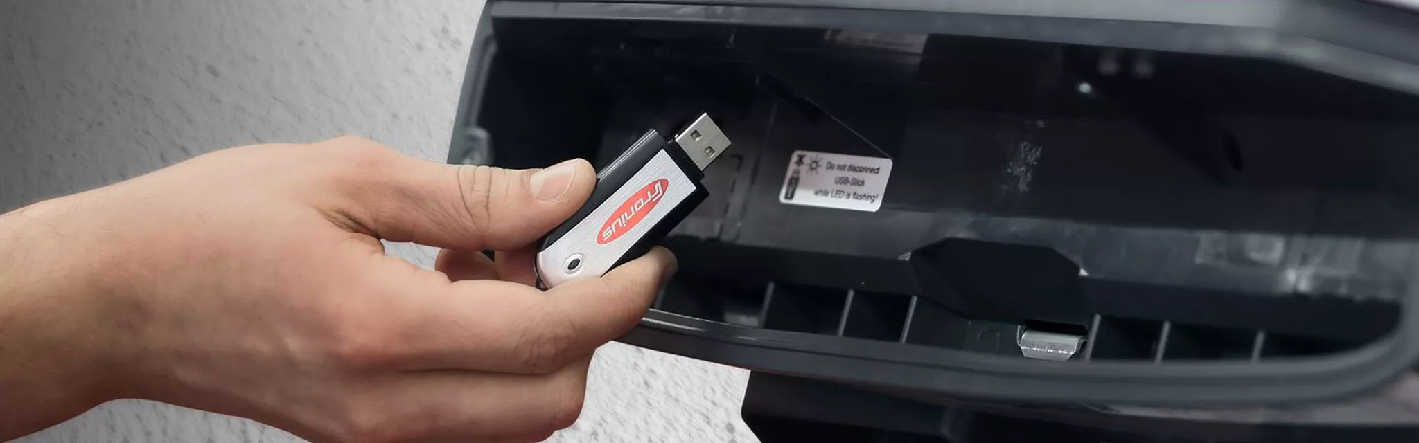

A USB firmware update is possible on the following Fronius inverters:
  • Fronius Galvo
  • Fronius Symo
  • Fronius Primo
  • Fronius Eco
  • Fronius IG TL
For a USB update, proceed as follows:
  1. Download the required firmware file.
  2. Copy the froXXXXX.upd file onto an empty USB flash drive. The flash drive must be formatted with FAT32.
  3. Connect the flash drive to the USB port of the inverter.Note: Remove the lower, grey cover of the inverter.
  4. Start the update via the inverter display under "Setup" --> "USB" --> "Software Update".
  5. The currently installed firmware version and the new firmware version of the inverter will appear. Press Enter (far right key) again to start the firmware update.
Note: Do not remove the USB stick or disconnect the power supply during the update process! 
