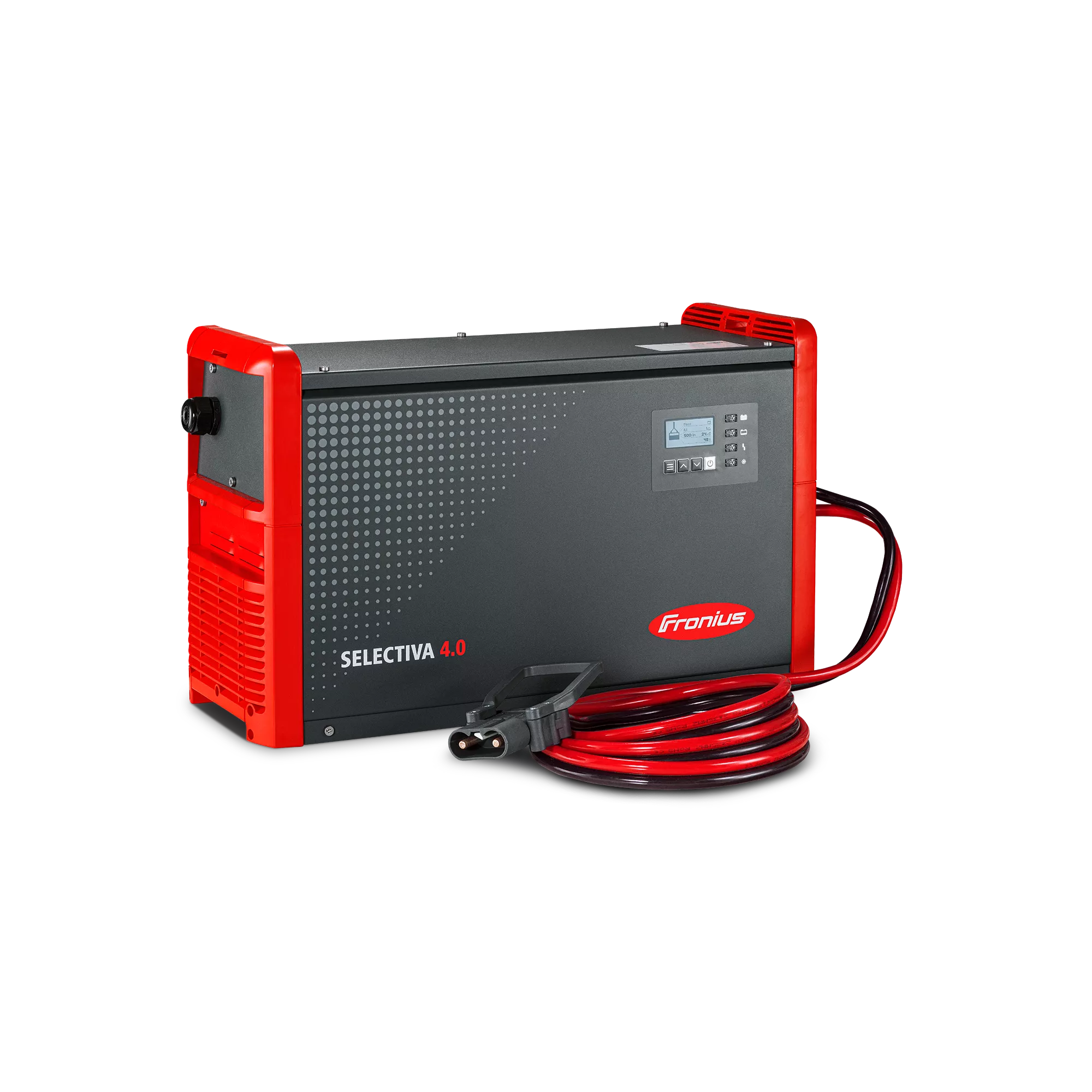

Battery chargers 4.0 for 80 V / 72 V batteries
One battery charger for every battery
The battery chargers from the Selectiva product family offer flexible charging of batteries with different voltages and capacities. Among the benefits for you are the simple and standardised operation and amount of space needed as well as low operating costs.
Technical Data
General Data
| Mains Frequency | 50 Hz |
| Dimension / length | 647 mm |
| Dimension / width | 247 mm |
| Dimension / height | 392 mm |
| Weight | 32,5 kg |
| Weight | 32,5 kg |
| Weight incl. packaging | 36,3 kg |
| Max. altitude | 2000 m |
Technical Data
| Mains frequency maximum | 60 Hz |
| Mains fuse | 32 A |
| Residual current Circuit Breaker | Typ B |
| Minimum Mains Lead Cross Section | 6 mm² |
| Nominal output voltage | 80 V |
| Charging current / output current nominal | 180 A |
| Maximum Relative Humidity | 85% |
| Degree of protection | IP20 |
