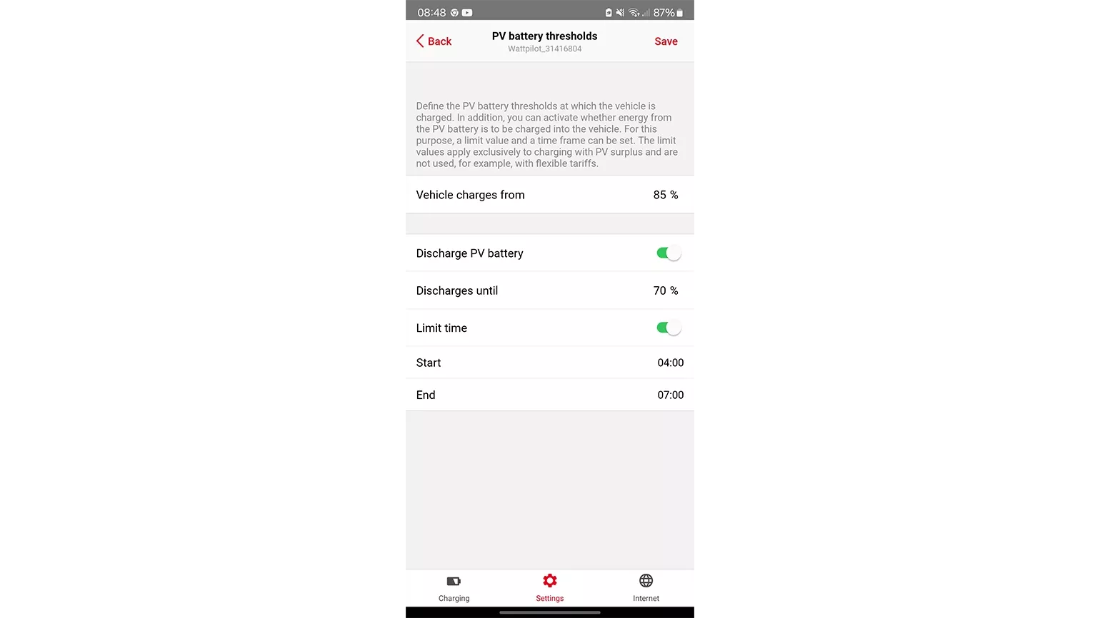

“Vehicle charges from” – this setting means that the Wattpilot may only use the entire PV surplus once the storage has reached this value. However, the Wattpilot can start charging before this value is reached, e.g. if the PV battery cannot be charged with a higher power and there is an additional PV surplus. Once “PV battery discharges” is activated, the PV battery will discharge to the value “Discharges to”.
Once the SOC level of the PV battery is higher than the value “Discharges to”, the Wattpilot may discharge the PV battery to the set limit. If the “Restrict time” function is also activated, the storage will only be discharged within the specified period.
