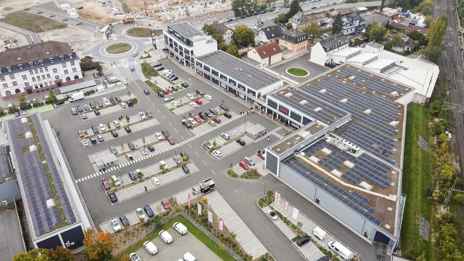

Charge your electric car conveniently and economically while doing your shopping. This is a wish come true for shoppers in Germany’s Mainz-Kostheim area. Next to a large neighborhood shopping center, SUN2CHARGE GmbH operates a solar charging park that generates 100% of its own solar power, revolutionizing the solar-powered infrastructure for electric mobility in the surrounding area. The large-scale project was constructed exclusively with Fronius inverters.

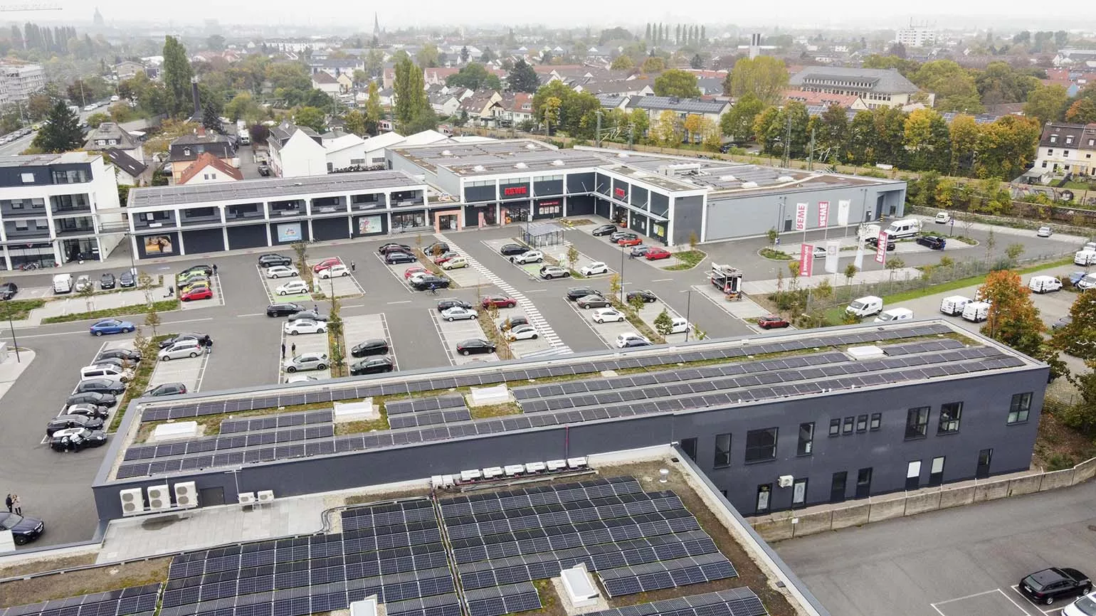

The solar charging park is the first of its kind in Germany and a truly pioneering project in terms of sustainable economic efficiency. A photovoltaic system featuring an impressive 2,300 modules as well as 16 km of PV cable and 1 km of data cable was installed on the roofs of the surrounding buildings. The system generates approximately 900,000 kWh of solar power annually – a gigantic amount of energy that could power a single electric car for an incredible 5 million emission-free kilometers.

12 Fronius Tauro inverters and 2 Fronius Symo inverters were installed for the large-scale project. The ideal choice for this exceptional project, these rugged project inverters not only offer maximum flexibility in system design but also consistently deliver maximum output even under the most adverse environmental conditions – and also don’t require any overhead protection outdoors. What's more, the Fronius inverters used can be quickly installed and maintained. If necessary, only the replacement components need to be replaced on the Fronius Tauro, and not the entire inverter. This makes it even more economical to operate the large-scale PV system for the solar charging park, while also trimming total system costs to a minimum.

The concept for the Mainz-Kostheim solar charging park has a unique selling point: instead surplus solar power being fed into the public grid, it gets stored at the site in large battery storage units with a capacity of 560 kWh. “This lets us ensure that more than 80% of the electricity we put into the electric cars is generated by the sun,” explains Christoph Hesselmann of Opel Energy GmbH, which built the charging park. In the next few years, this is expected to increase to a full 100%.
